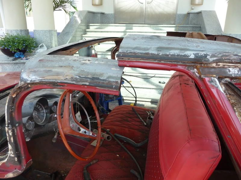

    Friday evening after work, the chopping began.
    JT, came over and helped remove the roof, then ***essed the situation on how to make this mess work. The 2 door hardtop windshield is not only lower than that of the sedan, it's also 5/8" longer at the bottom, hence the lengthening of the A pillar/dog leg.

    Pillars being cut.

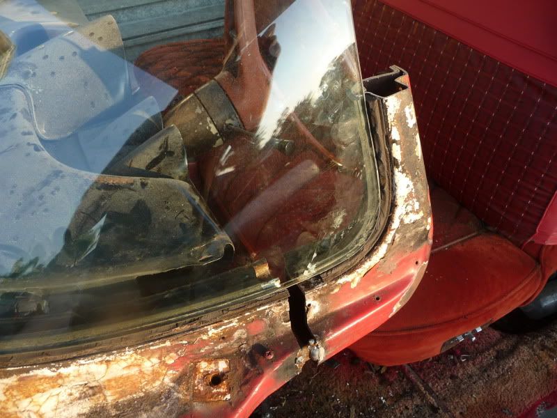

    Saturday morning, bright and early, I taped up the expensive windshield and my wife helped me put it in the frame so that I could start welding the pillars and roof back on.

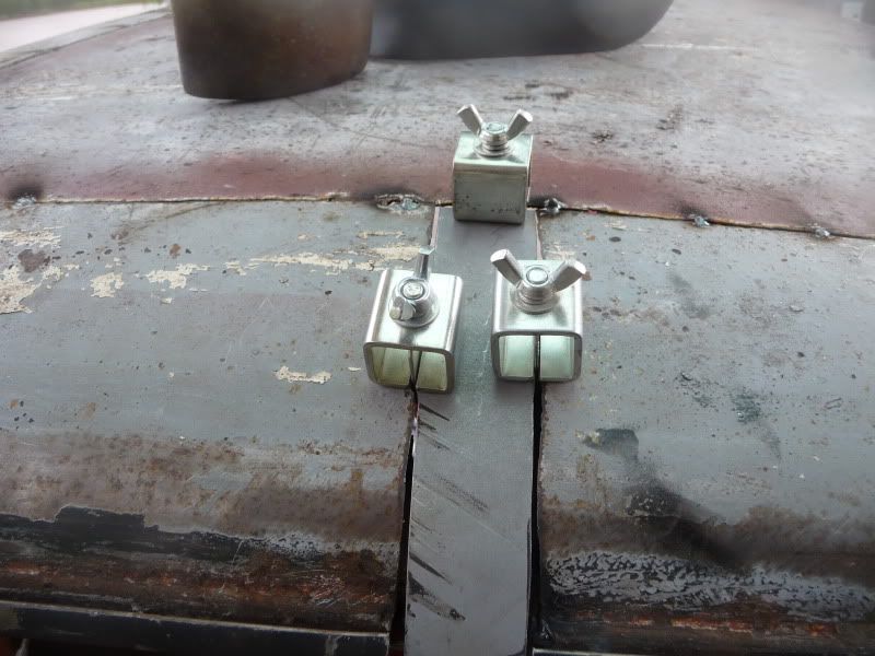

    Center of roof panel cut out and then the whole structure was section into 4 pieces.

    I had no intention of making the chop as radical as it turned out, I really love Paul Cepeda's Elky a lot, the idea was to make it similar but I'm kinda glad it's different than his cl***ic.
