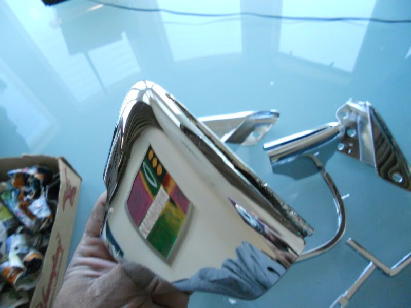

    Updates, finally. Got the chrome back from Spacecoast Plating, it's stellar as usual. The chopped vent window frames came out lovely, I did some fine prep on them, I must say.

    Before
    During
    After

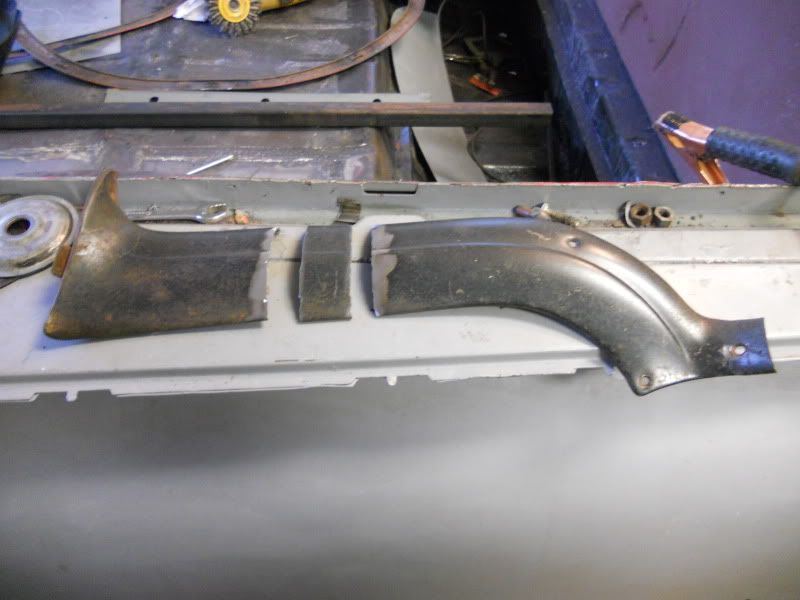

    I chopped the inner garnish moldings last night, they're pretty simple, the outside stainless ones will be a challenge, I only have a MIG machine, either I buy a TIG or find someone who I can trust to do it right.
    They're coming out nice enough to chrome plate but I don't know if I wanna spend the money.
    Chrome moldings do look great though.
    Here's the size difference and how much the car was chopped, hardly worth the effort, most folks won't even notice.

    The bottom of this molding was rotted out, so it had to be reconstructed.

    The side moldings below the A-pillar also had to be extended to match the lengthening of the dogleg.
    Other side tonight, to be continued.
