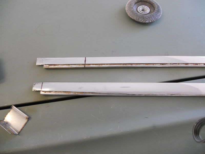

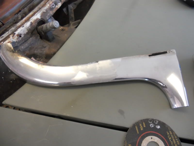

    I bought some .23 stainless mig wire and took a chance at cutting and welding my trim, I'm not 100% enthused, but I can live with them until I buy a TIG welder when I'm more grounded with my living situation, here's some pics.
    A pillar molding is cut and tacked together. I turned the heat down and slowed the wire feed, just a quick zap does it.
    I went slowly letting each tack cool.
    Weld very carefully ground down
    The back edge of the molding is covered with another molding so it doesn't need to be finished.

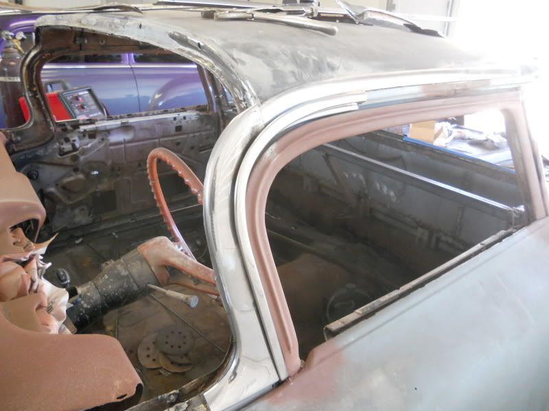

    Test fitted

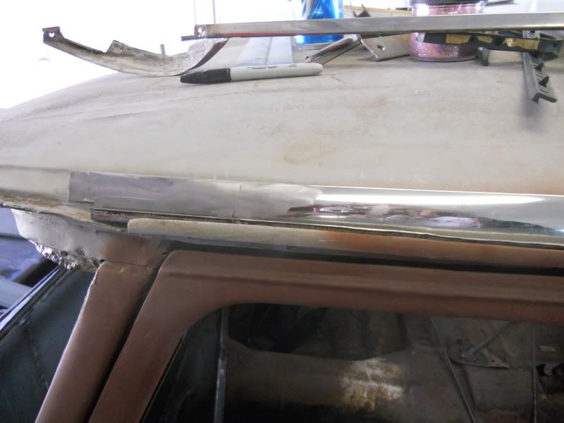

    Here's the gutter moldings, they had to be lengthened because the roof got longer when it came down. I had to buy extra moldings as donors.

    Here's the molding after polishing, it's pretty wavy, but the eye follows it vertically and it's not as noticeable as a horizontal piece. The other side gutter trim came out pretty nice but these waves are gonna be obvious.
    I'm not sure how much I can work the moldings without the weld breaking.
    I guess this will be a failed experiment but I gave it a shot.

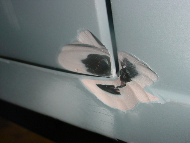

    a 64 galaxie was brought into my buds shop for paint.
    the old guy had worked on the galaxie for a couple yrs to get it paint ready.
    this was how much bondo he had on the rockers
    all the body lines were gone, all the styling was gone.
    he had to have over 20 gal of filler on the car.
    door bottoms were over an inch thick (to match this rocker)
    didn't strip or sand the original paint, this chunk popped of with a screwdriver.
    the hood needed a 2x4 to hold it up, every panel had filler on it.
    my bud talked him into stripping the car,
    under all the filler was a relatively rust free 64 galaxie

    Actually, I just worked them some more and they're looking much better, only the really eagle eyed will notice, but thanks anyway.
