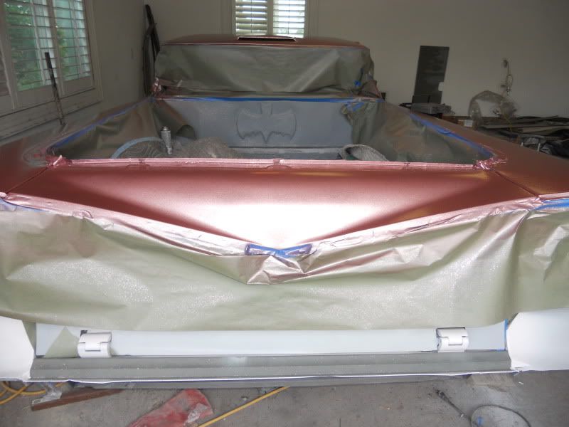

    Paint time, well for some of the car. The rear quarters aren't blocked yet, nor is the hood, the fins and roof are, so I shot them. I'm using this Earlex turbine unit from Eastwood, it works great with primers, solids, clears and absolutely perfect for metalflake but it's 2.0 tip is not good for metallics.
    The roof had a reaction so it will have to be stripped back to primer, I don't know WTF happened, but it's not good, the fins came out great, there's a couple of blotches hare and there but nothing too noticeable for this amateur.
    The base color is a Honda pink gold, and the flake Lil Roth, Dog Pecker Pink.

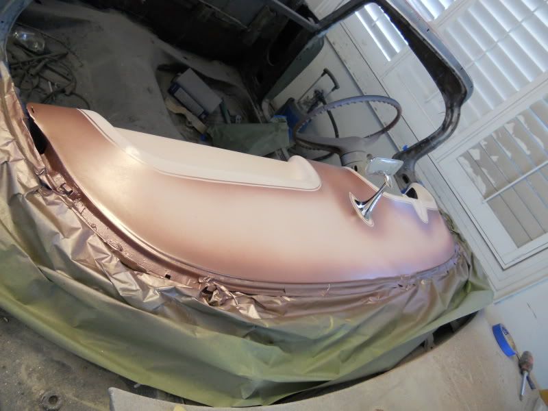

    Roof redone, but i made a mistake again. The topcoat clear, Shopline JC661 is supposed to be catalyzed with hardener, but I was doing the flake with intercoat clear which just has a reducer, I reduced the topcoat. It has hardened some, but I'm afraid I might be in for a repaint again, I'm seriously bummed out about it because it came out beautiful.
  15. Nads
    Joined: Mar 5, 2001
    Posts: 11,875
    Nads
    from Hypocrisy

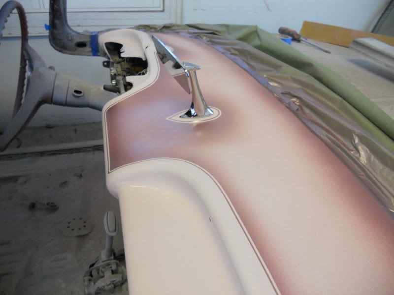

    I also fogged the dashboard, I didn't **** up with the clear on this, simply because I ran out and realized what I had done, so this still has to be buried in clear.
  16. Nads
    Joined: Mar 5, 2001
    Posts: 11,875
    Nads
    from Hypocrisy
    I sprayed a light dusting of shifty flake over the top.

    Thank you, I just sprayed on three coats of clear over the dash, should ready to buff in a day or two.
