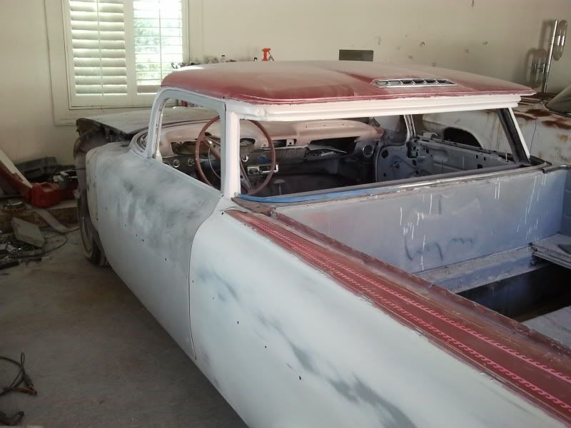

    Some progress pics finally. I've been working on the car a lot, I finally got the jambs painted and hung the doors. The rocker on the p***enger side was really tight against the door bottom. I shoulda rebuilt the hinges and hung the doors prior to replacing the rockers but I didn't. I had to slice the rocker across the top lengthwise and tap it down and reweld to make a consistent gap, it was pretty easy all in all.

    Other side, the doors fit good, I already test fitted the fenders previously and everything lines up well. It was a ***** of a job, I had to use shims and all kinda trickery to get 'em to line up.

    You can't see the blue pearl over the pink unless the car's in the sun but it is really pretty.

    The quarters are finally done and straight, that was a big job, also under the back window is a pain, it looks pretty good but not as straight as it could be, no one will notice though, it's really hard to block upside down.

    My fenders are in incredible condition, no dents, no rust, I just had to weld up holes where the name plates and rockets went, and the umpteen sets of mirrors that were put on her over the years.
    I've yet to start putting the front valence panels on, I know the p***enger side isn't matching very well, my pieces were pretty mangled up and I straightened 'em out as best as I could, but I might have to pie cut and cheat to get a good fit.
