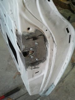

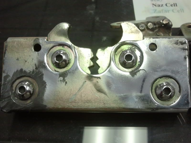

    I've done a ton of work, I put in bear claw latches, I couldn't deal with the original bull**** ones anymore, now the doors shut with a gentle click and pop open just like that and align perfectly.
  7. The orig latches are pretty lousy. My psngr side was tricky

    These work great Jay, the door clicks shut without slamming and it will open just as easily with door poppers.
    I bought 8 cent a piece stainless ****onheads and polished them while screwed to the latches, they came out better than the $3.89 each chrome ones at ACE, I'm gonna do ****onheads for the fender bolts too.

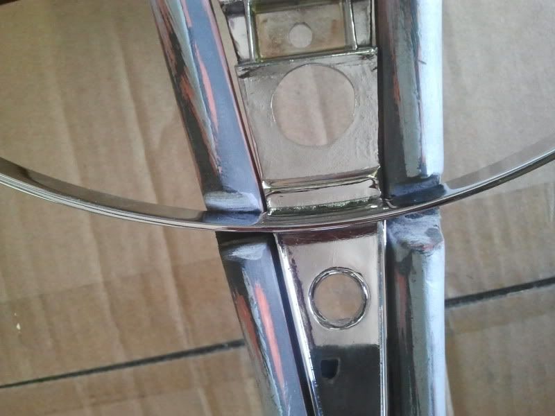

    Took my 59 Impala wheel and turned into a 58. I got a repro 58 ring from this place, it's the only place i found that has em.
    http://www.impalaparts.com/category.php?CatId=325
    I cut two new upper grooves into my old wheel to accommodate the full 58 ring. I also have about 4 hours into fixing the minor cracks with PC 7, it's time consuming but worth it, if you don't cut the cracks out and fill them and just prime and paint the cracks will come right back.

    I like that '58 ring in that wheel Nads.
    That & the Corvette mirror are really cool.
