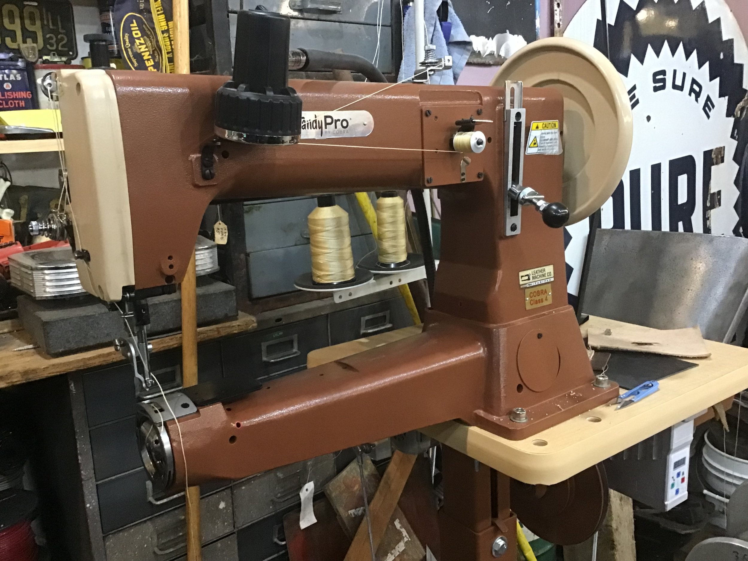

    I have a few of the 29k s and they are Heavy and awesome machines. The one is a Singer and the other is a Sutton like a 29k4 with the handle in front. They are great for making tool bags , holsters ,backpacks ,wallets and small items. The problem with the machine is the thicker your materials are the s***ch length decreases. Plus a super small bobbin. This isn’t an issue when you’re sewing the same materials. In fact I liked the 29k so much I bought a leather worker to sew even thicker leather up to 3/4 of an inch and sews with three the size of string! The 29k is what I use to make tool bags with my leather s****s from other projects
    So sewing a car seat your sewing two layers then 4 layers then 2 layers then 6 layers all in the same panel. This is the reason for a walking foot.
    So @nochop i too recommend a walking foot or a triple feed machine. I see them listed for under 1k and seen them as cheap as 400 bucks. My walking foot is an old German Pfaff 1245L and it’s an animal and will sew thru your finger if not careful. It’s got an old clutch motor and works fine just don’t have a heavy foot. My other is a consew with a servo motor and it’s ok but not necessarily needed just a convenience.
    I personally would look for an older machine like a singer consew pfaff or Alder . They are easy to work on and very interesting to fix and play with. IMG_7709.jpeg IMG_7711.jpeg image.jpg
