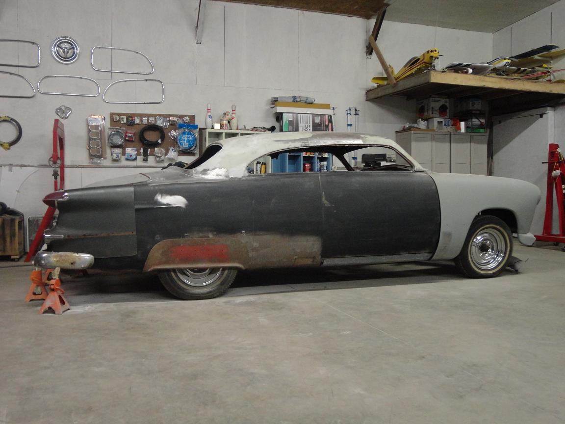

    I ended up burning some midnight oil last night so I'm sorry for those of you who have patiently waited. I filled the gap between the rear window and the decklid, and narrowed a '50 Pontiac rear bumper to fit. Next will be modifying bumper brackets, making a new rear valance panel, and a custom taillight treatment. Stay tuned!

    At the time I'm deciding between taillight setups. I've got a set of '55 Olds taillights and surrounding sheetmetal, as well as a pair of '54 Mercury taillights. Either way the quarters will be extended 3-5". I also have a third option with the '55 Olds sheetmetal in my head... just using the shape of the base of the taillight housing but tunnelling it, putting in a smaller bullet style taillight, and then using a copper/bronze/gold mesh as a backer for the rest of the space. Like I said, I'm still undecided.

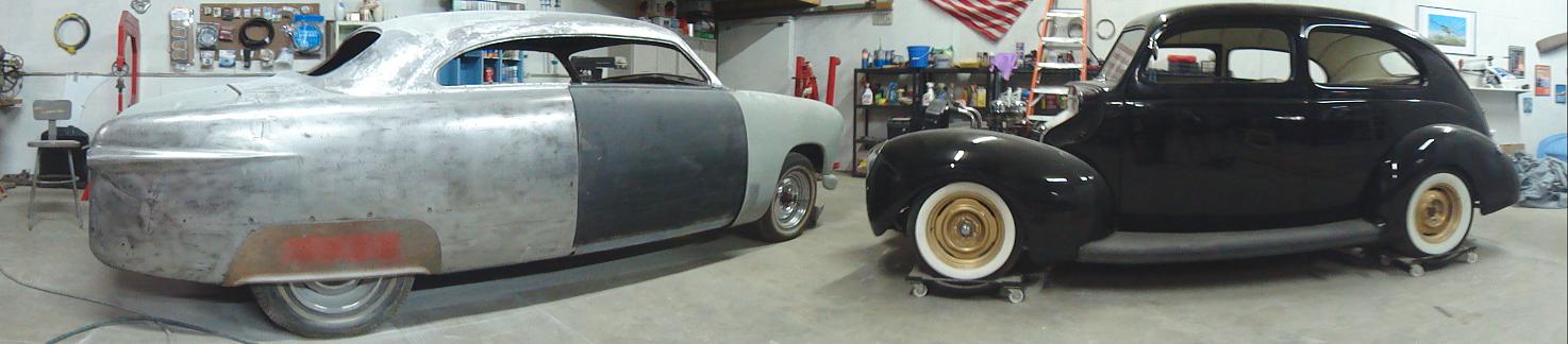

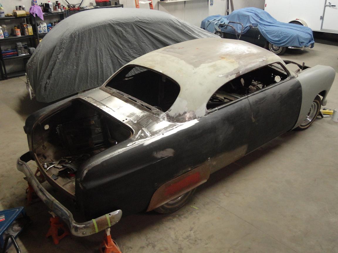

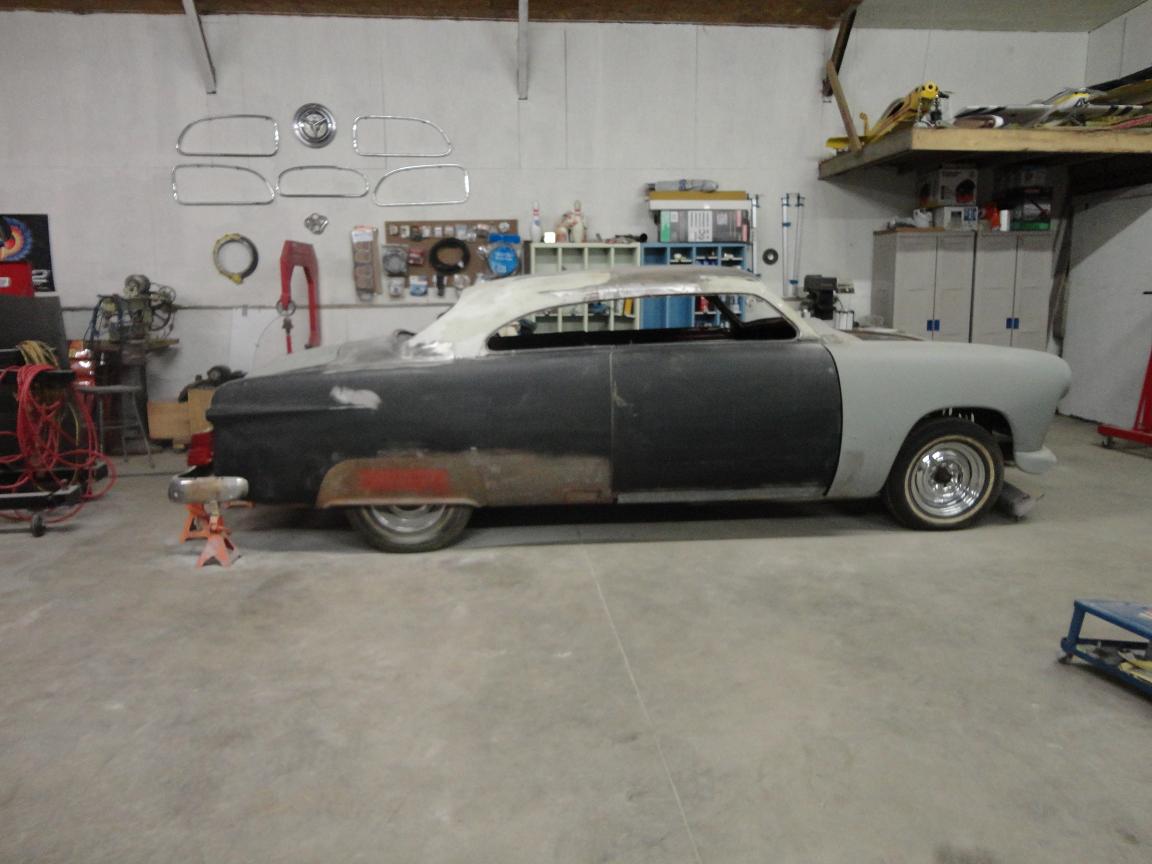

    A little bit of progress... I mocked up the taillights I'm going to use- '54 Merc. I also tacked on '56 olds quarters because I had them around and heck, why not? I've been working on my uncle's '39 Chevy coupe so I haven't had much time to get things done with the shoebox... but progress will come weekly. I've got to get this thing in primer by spring!

    Thanks Todd! The roofline wasn't any magic formula or anything- just chopped it to preference. I hoped someone would comment on the olds quarters- they're a little too space-aged for this car, however.

    Where is that rear bumper from?

    Which taillight mockup? :) I'm leaning towards the Merc lenses but if I get enough votes for the Olds quarters I may just try it...
    Jake I think you're just just saying that to see if I'd actually do it... :)
    I agree actually... the round tip of the taillight and the middle trim in the lens looks alot like the rear section of the window... It could be done relatively quickly and easily...
    Maybe you guys are onto something and it wasn't just a "beer induced idea"... I'll have to think about it. The Merc lights would look so simple and clean I think- the Olds lights are a bit ***bersome and "out there". I don't think I've ever seen a shoebox with '56 Olds quarters before, though if I have it was most likely Jim Laga (Kustom7777) that may have had those taillights on his shoebox before it went to outer space.
