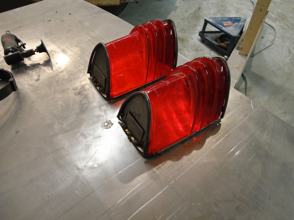

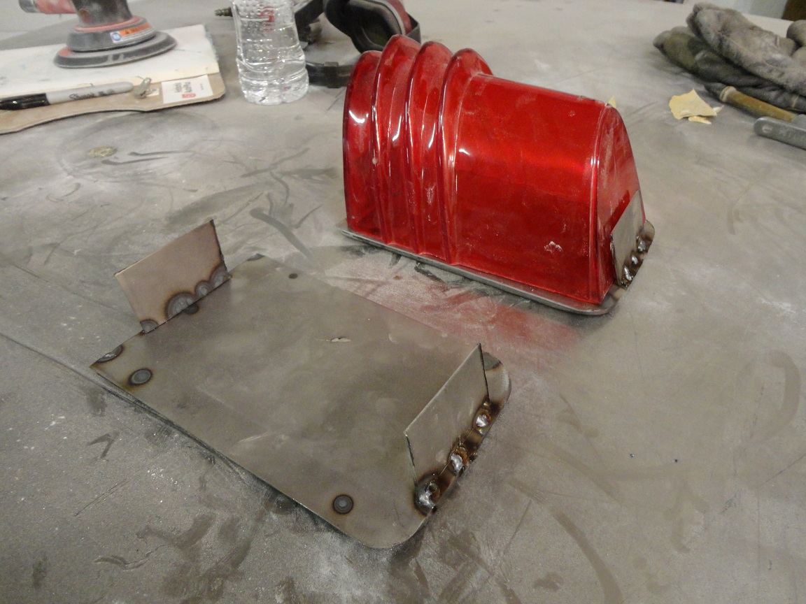

    Ok, so last night I put together the taillight housing idea that I have had in my head for the last couple of weeks. In the end, it'll take just two bolts to install each taillight. No screws, no "proper alignment" issues... no B.S.
    I wanted to be able to mount the taillights in through the trunk, without having any visible fasteners, but also to do it in a way that some Shadetree Engineer from the past would have done it. I came up with a simple "taillight tensioning" system that consists of three basic pieces. A backplate, a top plate, and a bottom plate. Eventually, the top and bottom plates will be welded to the body when I form the rear taillight sections. The backplate is designed to simply slide into place from the inside of the trunk, with the taillight lens.
    First, I made the backplate. I just used 1/4" round rod in the shape of the taillight lens, but a bit bigger so it would seal nicely later on. This piece will eventually hold the pigtail and lights as well. I haven't gotten that far yet. I put a tab on the top and bottom of the backplate with a 5/16" nut welded to each tab. These nuts are the basis for my tensioning system. I simply put a bolt through each one, and tighten in down onto my top and bottom plate. This holds the taillight in.
    Please refer to photos.

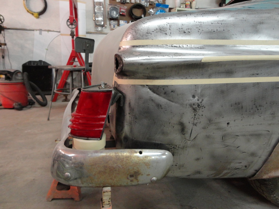

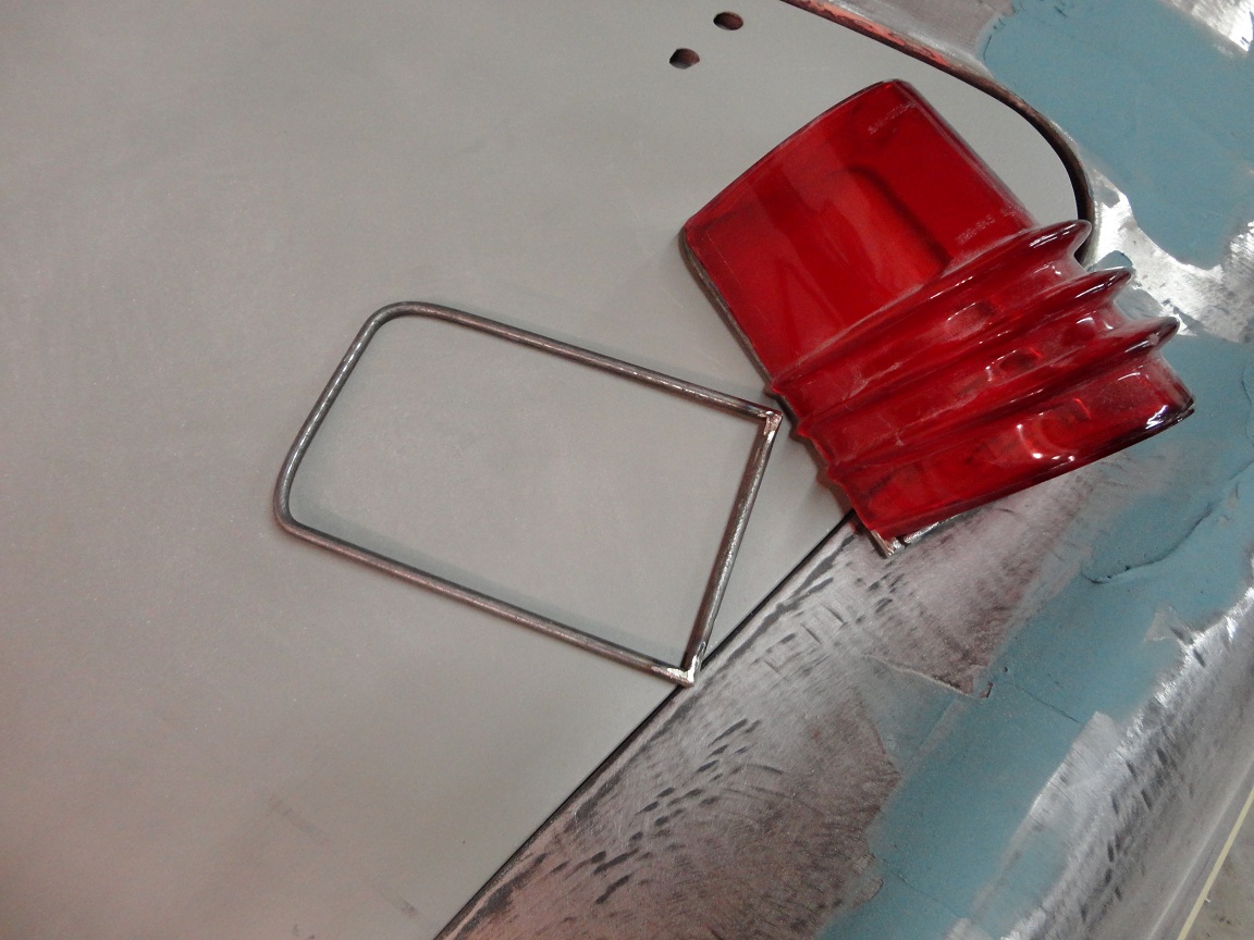

    Now, I don't like the squarish look of a '54 Mercury taillight, so I came up with something when I was at Eyeball's place. He showed me a set of Harley Davidson "Beehive" taillight lenses he was thinking of using in his bumper gaurds. I hope that's not top secret. Well anyways, I had a major "lightbulb" moment. I almost p***ed out. I thought that a '54 Merc taillight had a similar ribbed design, and would look good with the "beehive effect". I'll end up shaping the sheetmetal around the light where the tape is to mimic the beehive design. What do you think?

    HMMMM You might be on to something there. Put it on the fence for awhile and let it sink in. One thing leads to another. I change my mind a thousand times before i get that fussy feeling.

    Although you don't like the "squarish" look of the lenses in stock configuration they flow well with the planned rear edge of the fender. Rounding them off (a-la-beehive) doesn't really match any other lines on the car, therefore becoming a focal point. I dig 'em, I just think you need similar shapes integrated elsewhere on the car to pull it off successfully.

    joeycarpunk
    from MN,USA
    I like the idea it adds a element of movement or flow that should pick up the rear quarter extention shape especially if it tapers top to bottom. Hard to explain, but I like where your going with it.
