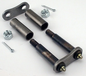

  5. gimpyshotrods
    Joined: May 20, 2009
    Posts: 24,629
    gimpyshotrods
  6. gimpyshotrods
    Posts: 24,629
    gimpyshotrods
    Pull the nylocks and use a stover or castle nut.

  8. F-6Garagerat
    Joined: Apr 12, 2008
    Posts: 2,652
    F-6Garagerat
    Yeah I'm kind of leaning towards a Marsden nut and some Loc***e.
  9. F-6Garagerat
    Posts: 2,652
    F-6Garagerat
    Those are really nice. I could use a Marzden nut and Loc***e on those. I wish they had a nut on both sides, I'm just **** like that. Those still might be the best option. Thanks for the links.

  19. 53OlderThanMe
    Joined: Oct 17, 2007
    Posts: 438
    53OlderThanMe
    I emailed the Limeworks crew when I saw this thread. I am using aftermarket 3/4" ID spring and original Model A spring perches for the friction shock mount. The original Model A spring perches have the 11/16" ID holes. The Limeworks bushings are 3/4" so will not fit my spring perches. I ordered a set of Model A shackles for 11/16" bushings and plan to use my 3/4" rubber bushings on the spring end to resolve this.
  20. F-6Garagerat
    Posts: 2,652
    F-6Garagerat
    Are you talking about mixing stock ford type 3/4" shackle pins with the model A shackles? how are you going to pair the 2 different types of shackles? the stock type model A shackles dont come apart.
  21. 53OlderThanMe
    Posts: 438
    53OlderThanMe
    Aftermarket like you have pictured. I will use one long bushing pictured on the perch end and the 3/4" rubber inserts on the spring end of the shackle.
