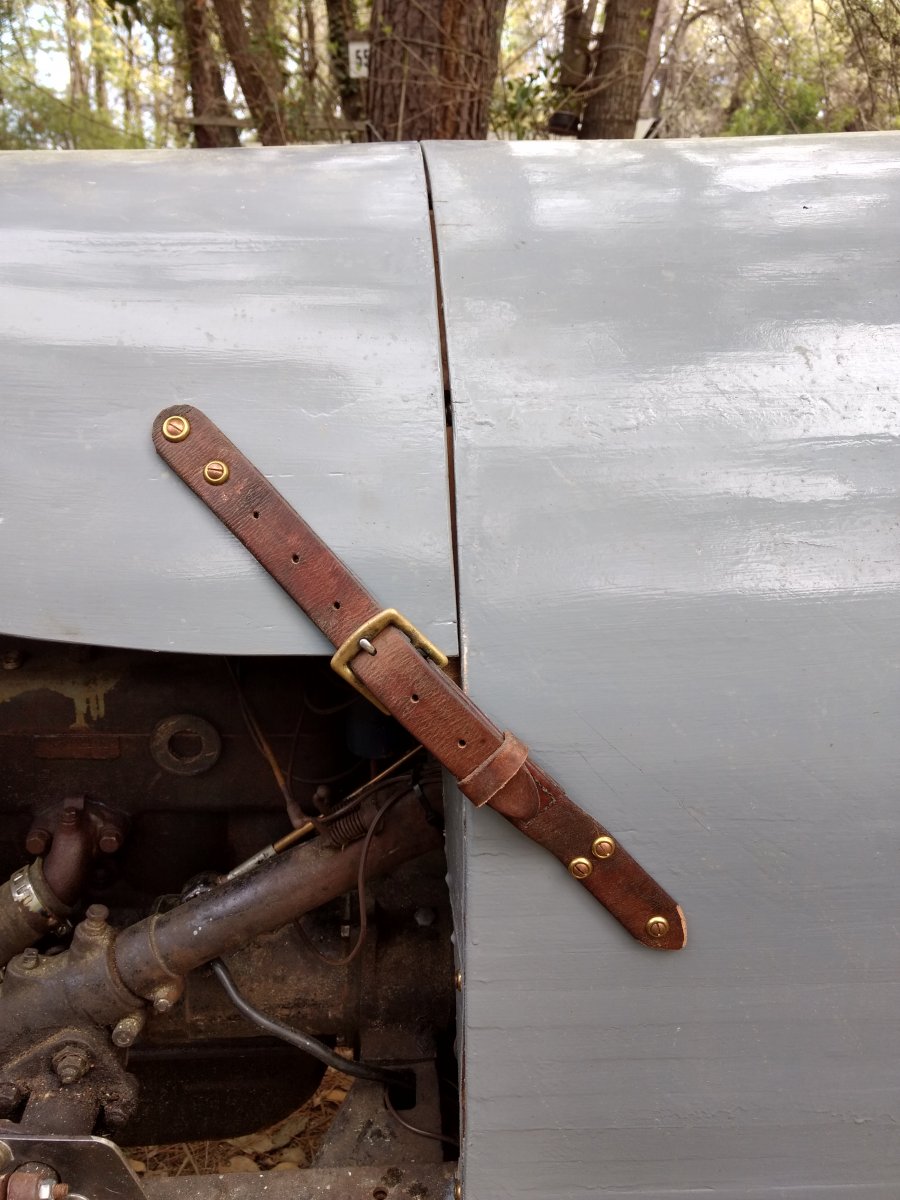

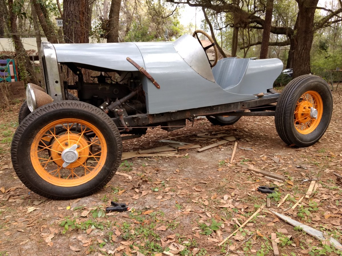

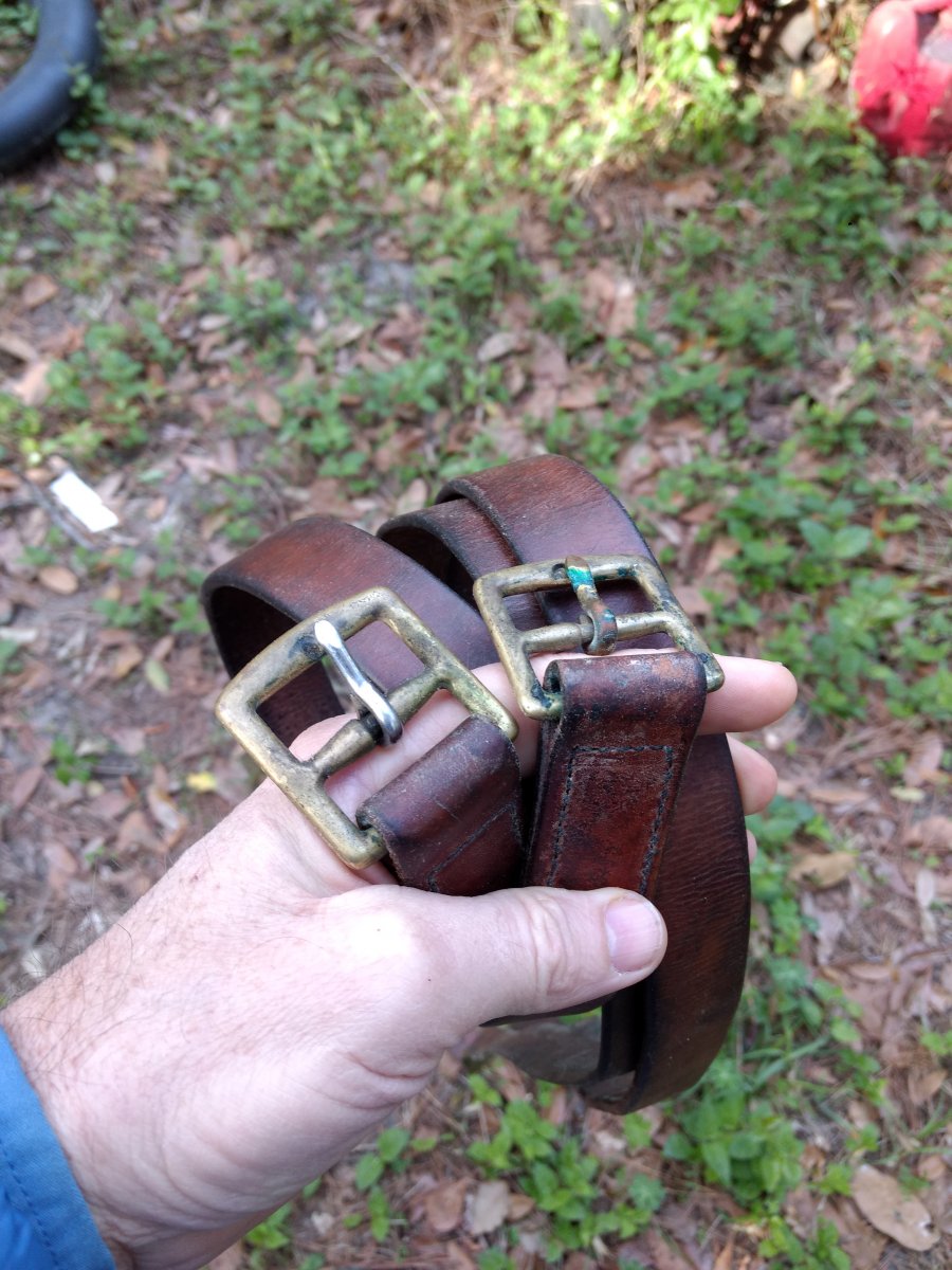

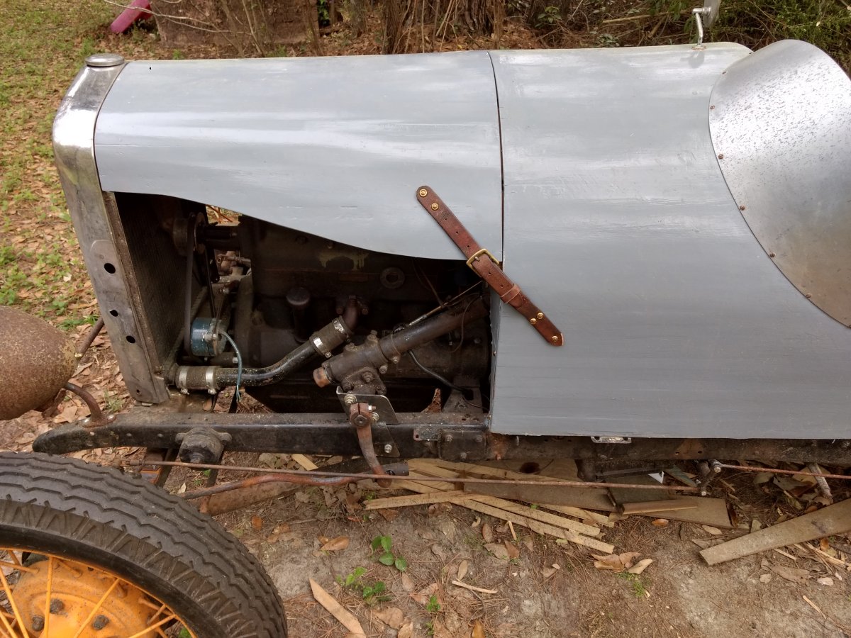

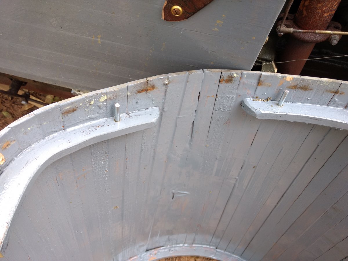

    Thank you both. I added some buckles and straps to the front. I think they will look fine, once they weather in a bit. My pin arrangement didn't inspire enough confidence. The little hood kind of waggles around up there, and I could just picture it getting loose from the radiator shell and flopping back. The rear straps would probably hold it, but still... This way, it can dance all it wants to, but I know it's staying put. Other than that, I haven't had much time for the poor old thing. Life and work, work and life. And a damn hot summer. Fall is coming down here, though, you can feel the slightest little nip in the air, if you get up early enough. I'm going to try to get it tagged and insured and get a little actual road-time, as soon as I find where I put the bill of sale. Ha.
