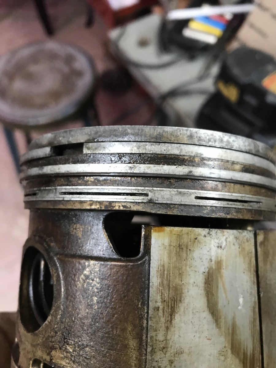

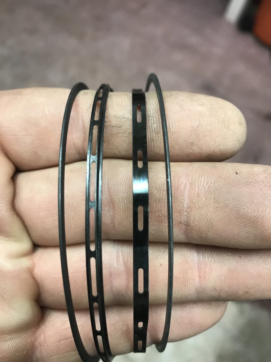

    I was taught that the job of the oil ring is to remove excess oil from the cylinder walls to control oil consumption because the compression rings could not do an adequate job of it.
    Perhaps having the return holes in the back of the oil ring groove would help, but I wouldn't count on it. Oil ring design has been the same in every piston engine for over 100 years so it must be a pretty good plan. Your choice though and as you said, it's not a big job to remove them later and make a change.

    Either way Fabber, I think your idea of opening up the grooves and using real oil rings is a good one.

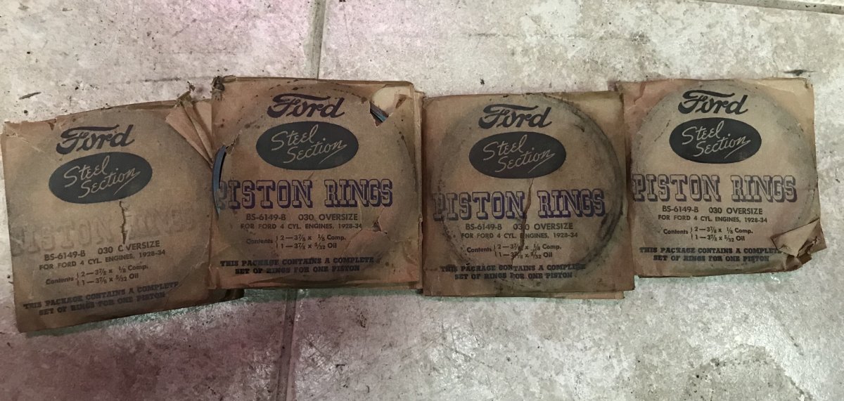

    I bought a lot of model A NOS piston rings off A auction site. It came with over 20 sets in various sizes. Let me check if I have some that are like you need.

    Well I checked I have no sets that had the 1/8” oil control rings just 5/32”. I did take a look at my AR pistons and rods and they aren’t original. And have the late style rings in them. Must have been a early on warranty rebuild! ;-) .0025 oversized seriously. That is even more odd. Still has X beam rods though.

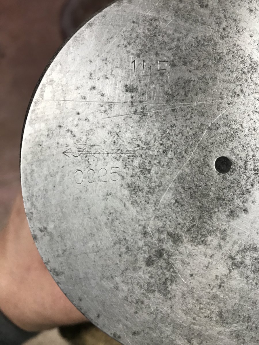

    Thank you for looking, anyway. Mine have the early rods, too, but those pistons are definitely not the same as mine. .0025, maybe marketed for engines that had been honed several times but not bored? I think I'm going to follow Fabber's advice and just enlarge the bottom groove to 5/32. Anybody got any information on the pros or cons of the early x beam rods? Google is oddly silent.

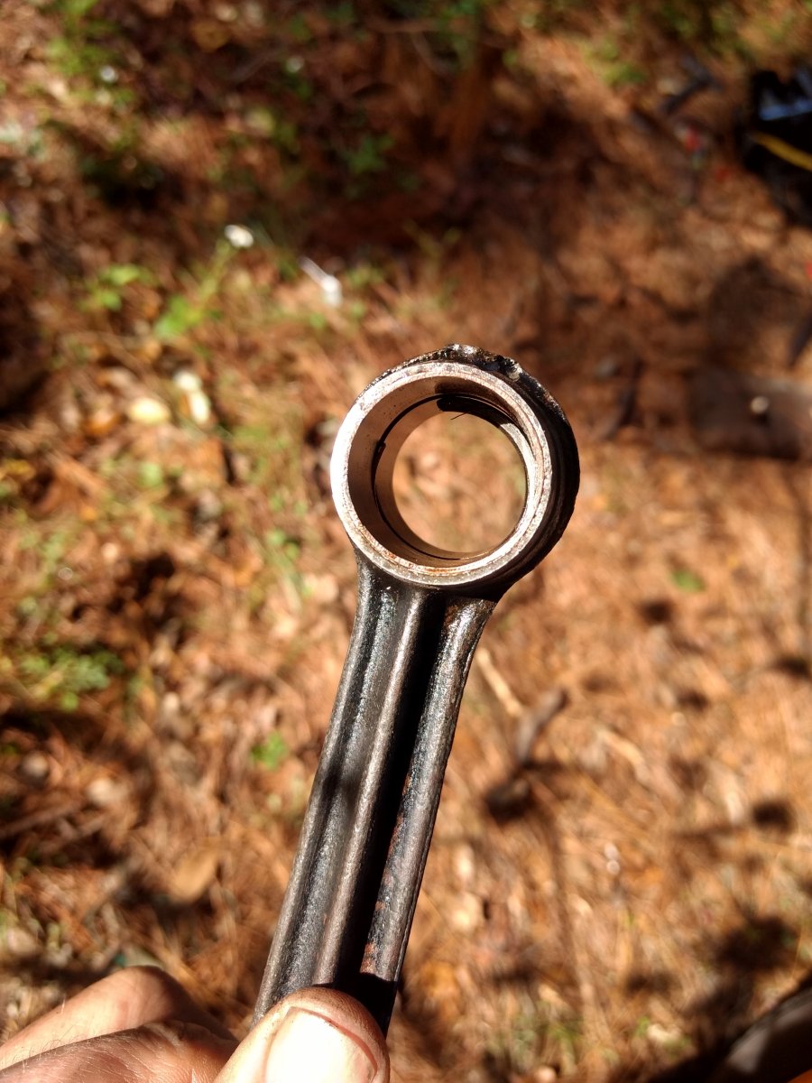

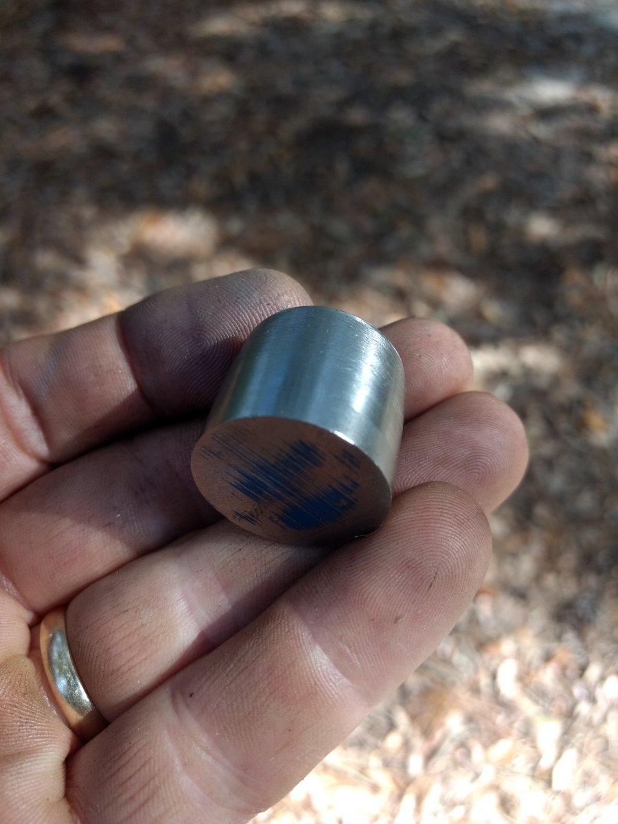

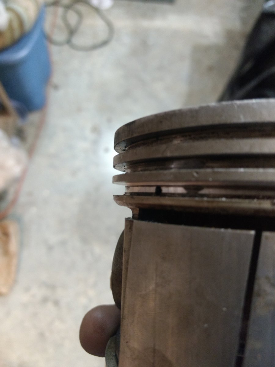

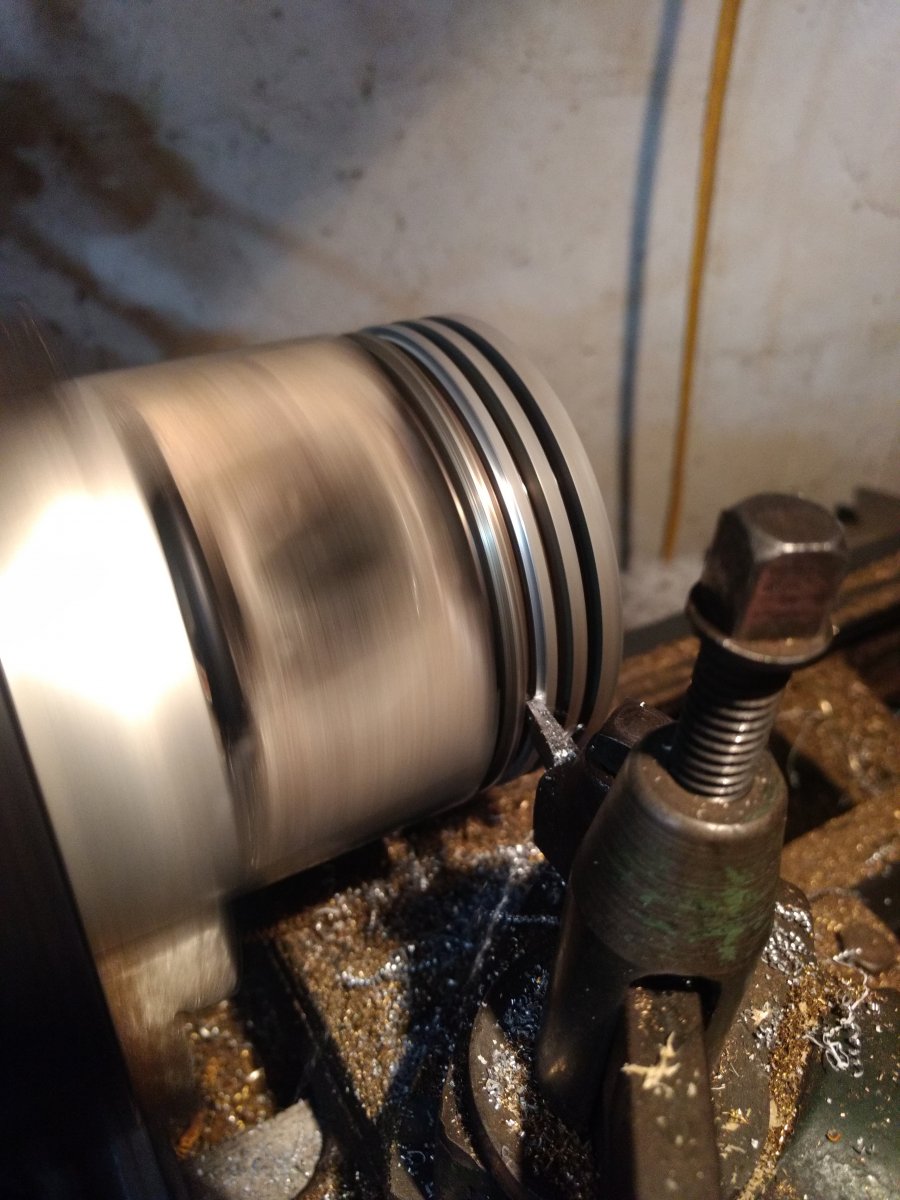

    I spent all my free time this morning on one piston. The wrist pin drove out pretty easily with a deep socket. Ground a little cutter that would fit in the 1/8" groove. Turning it out the thickness of the oil ring stack plus .002 involved some finicky measuring, but was straightforward.

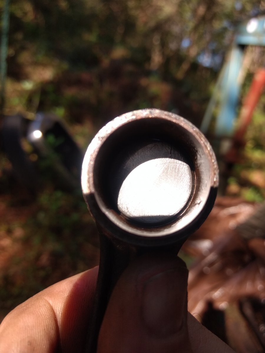

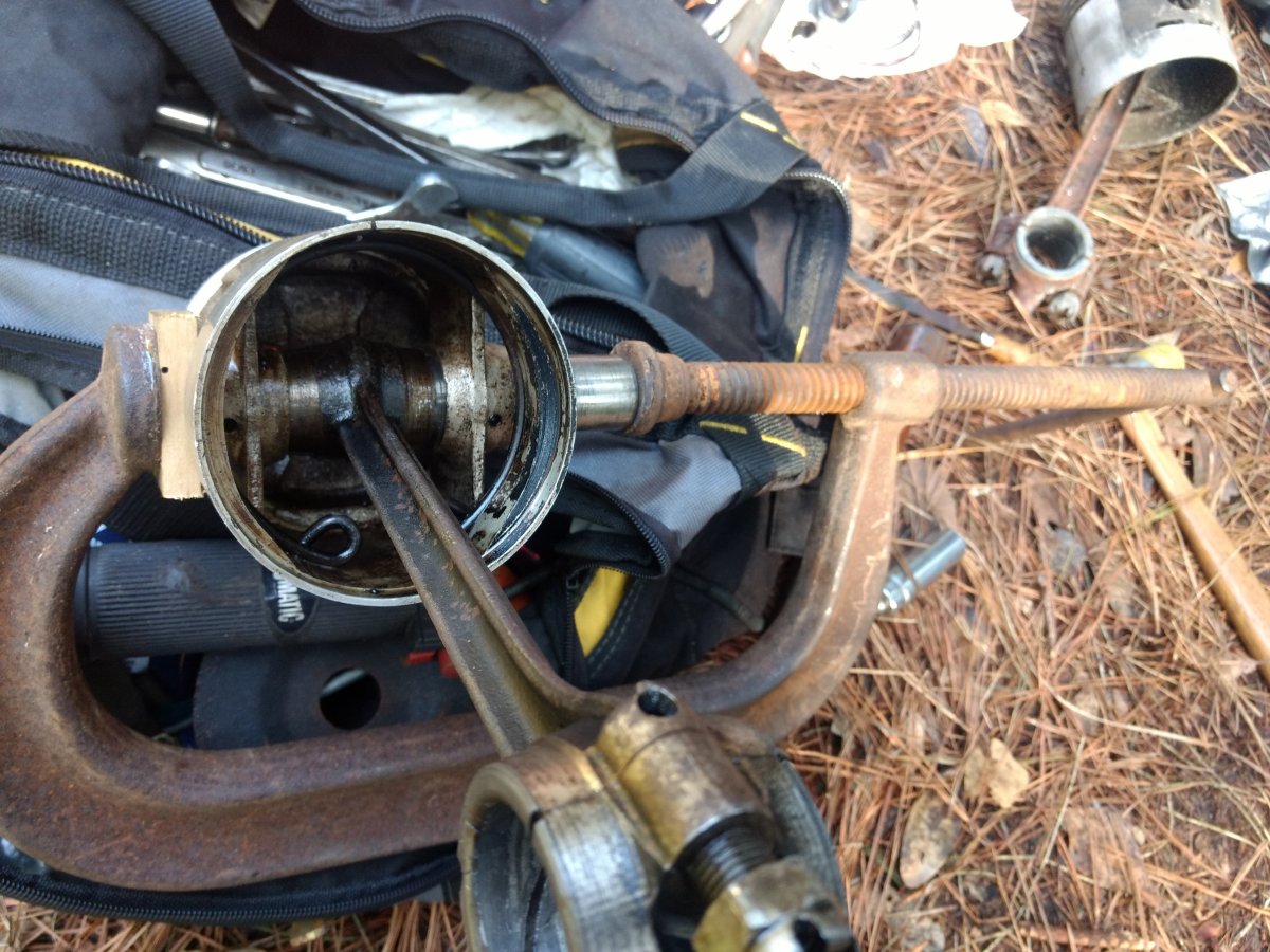

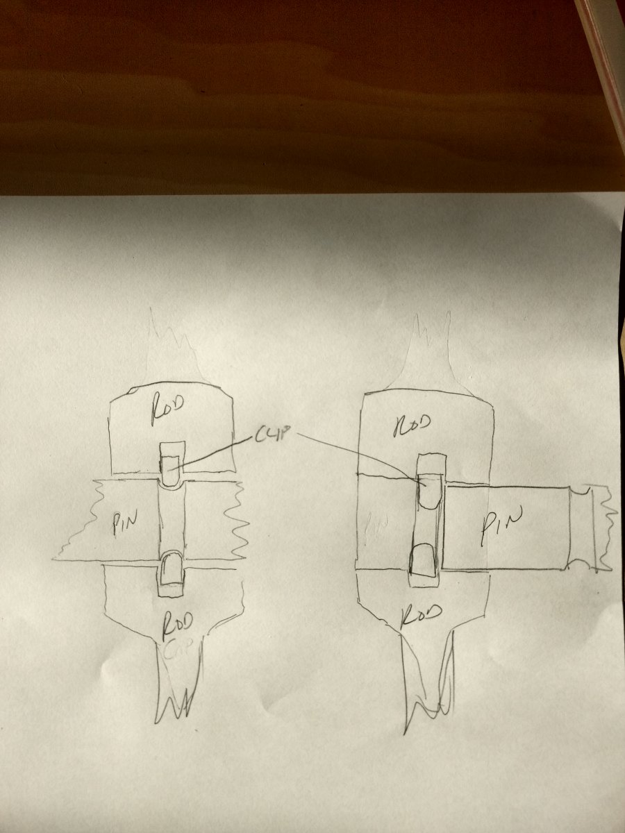

    Re-***embly was the catch. These early wrist pins are held in by a c clip in the middle of the rod bushing that rides in a groove in the pin. Here it is:
    Like I said, the wrist pin drove out just fine, but putting it all back together wasn't so easy. I ***umed that the chamfer on the pin would let it p*** the clip, but it wouldn't. I tried carefully expanding the clip with a pair of needle nose pliers, but as soon as I tried to tap the pin in, it pushed the pliers off and the chamfered edge caught the clip. I finally made this little slug:
    It is just under the wrist pin diameter and has a long, shallow taper leading to a sharp, square trailing edge. I put it in the rod (facing the right way, thank goodness. It would be just like me to get crossed up and end up with the dipper facing the wrong way...).
    Then it was just a matter of pressing the pin in and letting it push the slug out as it went. The pin is a really tight fit in the piston. I used my patented shade tree press.

    Dang, 12, I posted my diatribe without even checking the thread or seeing your response, so the center clip thing is kind of double covered. Oh well. I wonder of some of those clip failures weren't caused by guys just muscling the pins past those clips during rebuilds? My pins fit mighty close in the pistons, and I could hear that clip pop into the groove when I pressed it in. Seems like a pretty secure arrangement, unless that clip breaks.

    I think the pins come out easy because the clips are already held partially expanded by the pins, so when you tap it, it just pops past. When you are trying to insert a wrist pin, the clip is completely relaxed, and the pin fetches up against the perpendicular side of it. Just read over that explanation and realized how confusing it is. Here's a quick picture of what I mean:

    I see what you mean. Lets see how the rest come out unless you have done the other three. I keep thinking that the
    clips are in a grove like a grove on a ring. But of course that makes no cense, you would never get the wrist pin out.
    But What the Hell do I know.. But your looking Good!! You are right I am sure there is some type of tool to insert
    the wrist pin with the clip type..

    Well, I got the pistons in yesterday. Had to open up one groove a tiny bit on the lathe, which meant taking the rod and wrist pin back out, but I'm pretty good at that now. Spent most of this morning degreasing, s****ing, wirebrushing, and painting. That's not any fancy paint, just good old Rustoleum, brushed on (what, think I was going to break out a HVLP on this rig?). Hunter Green and Black mixed 4:1, green to black on the engine. Probably should have gone 3:1 or even 2:1, it looked darker in the bucket, but oh well. I might throw on another coat, depends on how it looks dry. Safety red on the head and manifold. Everybody knows red adds HP. Anyway, you can't spell street cred without red. Haha.
