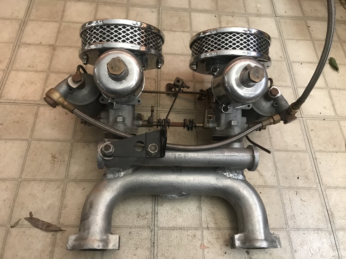

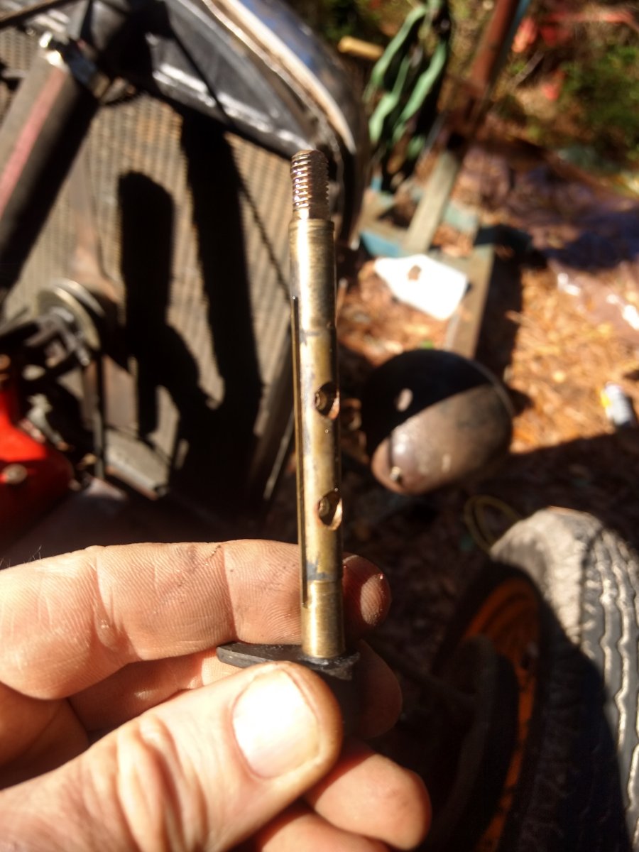

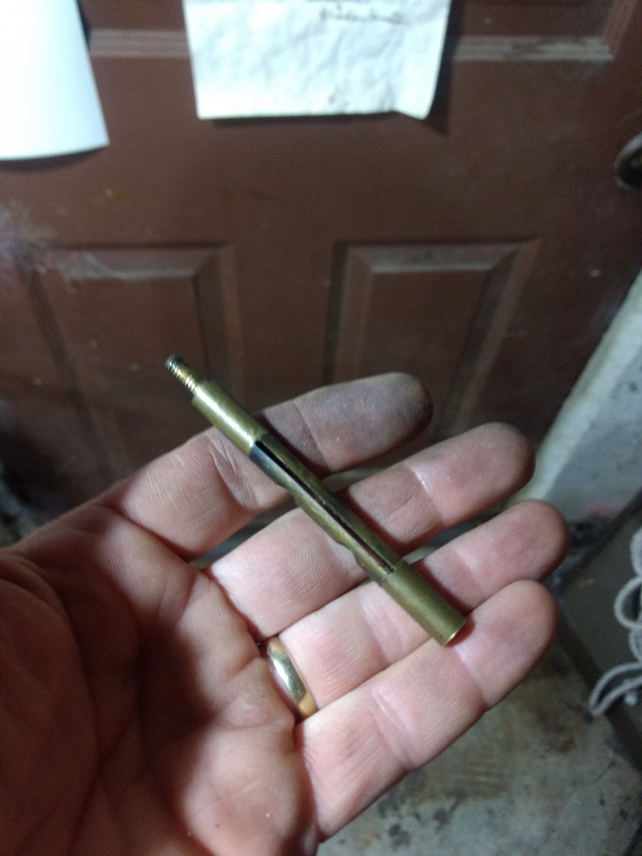

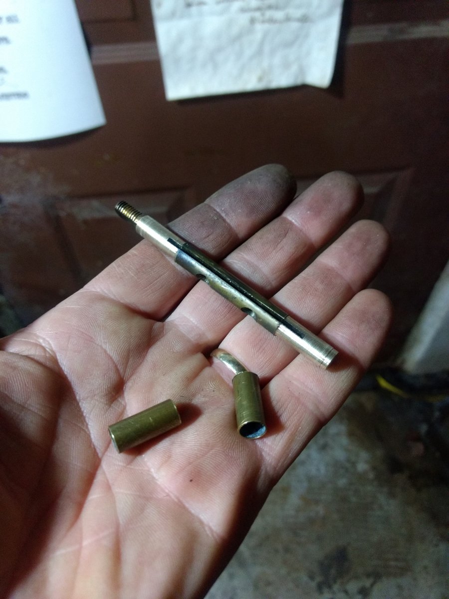

    The overheating problem seems much better, but my carburetor issues are baffling me. The symptoms are that I have to set it as rich as it will go at idle, but at any constant rpm above idle the engine gradually stutters and dies, lots of exhaust backfiring. If I push the piston that controls the needle down with my finger, it solves the problem. Timing is correct, checked with a light. Fuel pump is working fine. I've adjusted the float level to specs, so that's not it. I noticed there was some wiggle in the throttle shaft, took it out and found this:
    It's hard to see in the picture, but there are some pretty significant steps worn in each end. The bushings in the carb body seem fine. I scrounged around in my junkpile and found some thin-wall br*** tubing that fit the bushings perfectly, so I turned down each end of the shaft so that the tubing was a tight, press fit, cut a couple of pieces to length, and soldered them on.
    Put it all back together with the highest of hopes, but nothing has changed. It's like the mixture is changing over time at any constant throttle setting above idle. I'm going to get a cheap fuel pressure regulator and try that, although it doesn't make sense to me that I would have to set it rich at idle if the pump is overpowering the needle? Seems like that would give me a rich situation. Any suggestions?

    I have messed with some SU’s before and found that most of the rich idle issues were caused my the end of the mixture needle was worn and the only way I was able to properly tune mine was with a gauge pin installed in the top as a reference to the needle position during a rich or lean mixture. Then I have to remove the needle and modify that position on the needle to get the correct mixtures. I do know the oil in the top damper can also cause fuel to be inconsistent as well. I probably confused the heck out of you and nothing I just said made any sense at all to you. But I get it in my head. ;-)

    12, I think I kind of see what you are saying. I think my needle profile is just all wrong, but I'm not sure where to go from here. 30, I have seen that chart. I think the hp side of it is more useful to us, because Model A engines turn so slow compared to more modern ones. I think that makes the displacement side of the chart misleading. My carb is the 1 3/4" version, came off of a 1800cc Volvo b18, but there were two of them on that motor. A single one is right for about 50 hp, according to that chart, and so are the twin 1 1/4" ones that you are planning on using. I've been messing with them for decades, and I have had good luck, but this application is not working out, so far. I can adjust it at idle by raising the slide slightly and turning the big mixture nut on the bottom and get that ticking over really nice, but when I open the throttle and just hold it steady, it gradually loses rpm, then spits or backfires through the carb and dies. The exhaust is getting a good bit hotter than it used to, also. It all seems like a severe lean situation to me. I've checked for vacuum leaks with a water bottle, can't find any. The only thing I've changed since it was running before is the rings and the head. I'm sure it has a lot more compression than it did. I have to admit, right now I'm stumped.

    Cactus, I think it's enough carburetor. If memory serves, a 1 3/4" SU flows something over 200 cfm, which has got to be way more than a stock Zenith, and they work fine. The problem (I think) is that the needle isn't letting enough fuel in for the air. Maybe something to do with being tuned for a dual set up on a much smaller engine? Anyway, since I bought this carb with it's partner, I have a spare, so I yanked the needle out of it and tried modifying it. At first I just chucked it in the lathe and filed/sanded it down "by guess and by God". That helped, but it was still lean at open throttle, so I just filed a flat into it.
    It's hard to see in the picture, and hard to explain, but basically what I am doing is the equivalent of trying a larger jet. Of course, I have the original needle set aside, so I can always go back. It seems better, not bogging near as bad and the lean/rich adjuster is back up in the middle of it's travel. I think I'll keep fiddling with it. I also did a compression test, since I imagine the rings must have seated during all of this. It's jumped from around 60# on all four to just over 80#. Those worn rings and huge ring gaps couldn't have been helping, and the new (to me) head pushes it from 4.22 to 5.22/1. Reckon that explains why the exhaust system seems hotter? Ha.
    12secvx, I like that set up. I was thinking about running both of mine, but one of them had been dropped, so I am using it for spare parts. I have another complete set on a Volvo b18, but that's another (off topic) story.

    Thank you. I'm making progress on the carburetor issue. It still tends to skip a bit, doesn't take fuel well sometimes, either. I felt like it was dialed in enough to make a quick road run this morning, though. It seemed to run better with a little bit of load on it, much better at constant speeds, still tends to buck and hesitate a bit taking fuel, though. I think my needle experiments just went a litttle too far, and it's consistently a little rich. I might try a thinner oil in the piston damper, let it rise a little faster under acceleration. Anyway, here's a quick video from the driver's seat. By the way, if any of you come to Georgia, it's now illegal to have your phone in your hand while driving. Just a heads up. I approve of that law, even though I broke it.

    Looks like you are getting it dialed in. I have used 3in1 oil in the damper and it seemed to help it at the time and used a Air fuel ratio gauge later to verify.

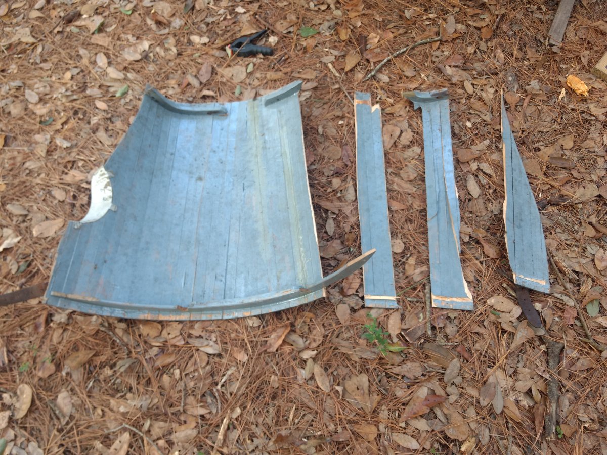

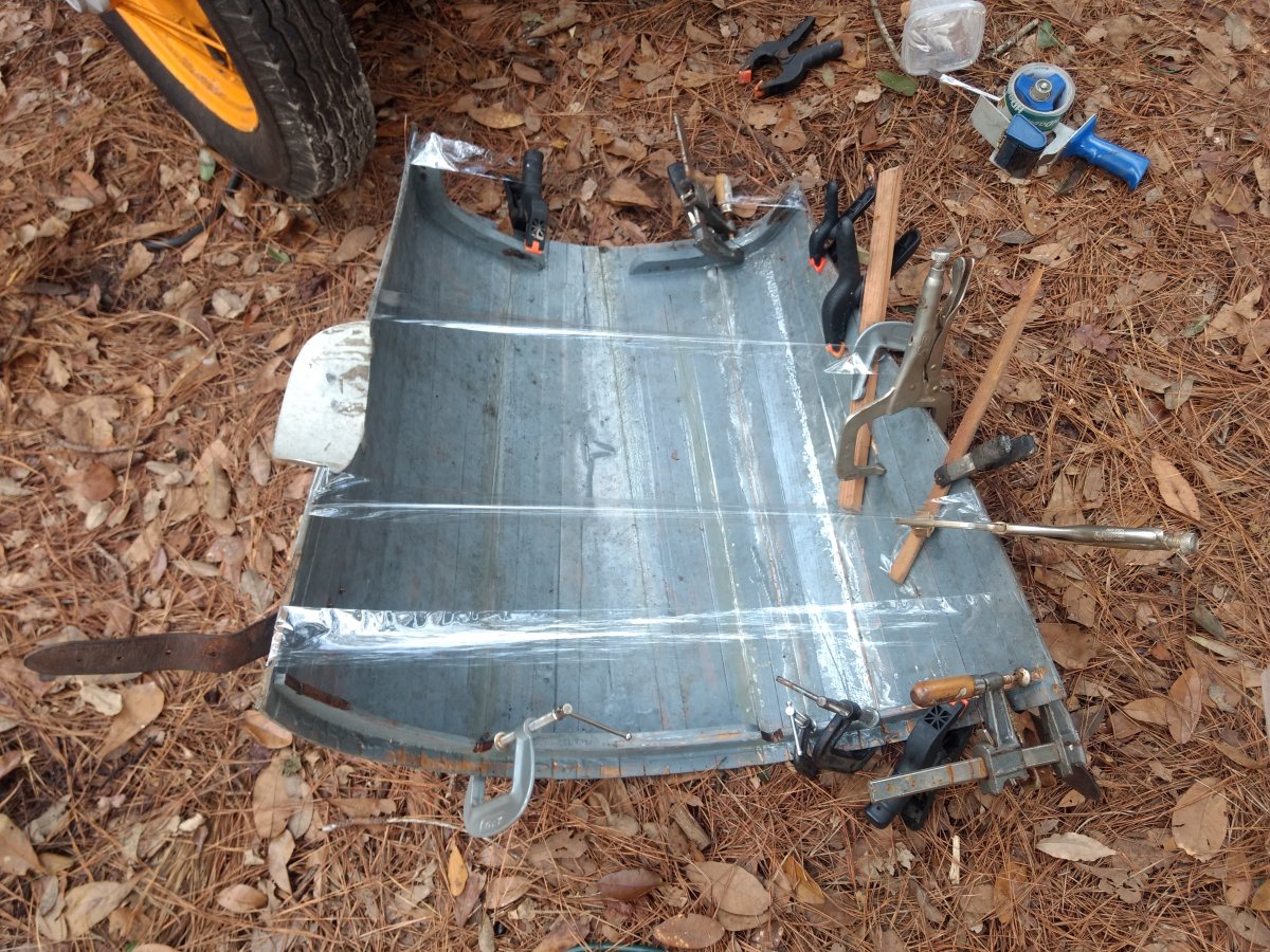

    The dangers of shade treeing.
    That big limb behind the front tire is the culprit. Ain't no big deal. It'll glue back.

    Bummer. An ironic end to 2018. But sounds like you're taking it in stride. I enjoyed the video, by the way.

    Carb sizing: Using cubic inches can get you close but better thinking is horse power. The carbs you are using came off a motor making 100+ hp. Think about your A at maybe 60. Fuel pump/ pressure: I use exhaust gas pressure off the exhaust pipe ahead of the muffler- gives about 3 psi of silent pressure.

    Tell anyone that asks, your hood got busted by some jerk at the track last week that tried to go by on the inside and bounced his right rear wheel in there. Maybe take a soft shoe sole and make some rubber marks in the area, haha.

    I agree on the carb sizing and HP thing. Remember, though, that the Volvo had two of those. If you look at the chart 340Hilborn posted up in #430, one 1 3/4" SU is just about right for 60 hp. I think 60 is probably a little optimistic for my setup, but I should be able to get it working. That's an interesting idea on using the exhaust pressure. How do you plumb that?
    Got some glue spreading done. Epoxy thickened with colloidal silica. It'll definitely need some filling and sanding, but hopefully I can avoid having to make another hood. We'll see.
