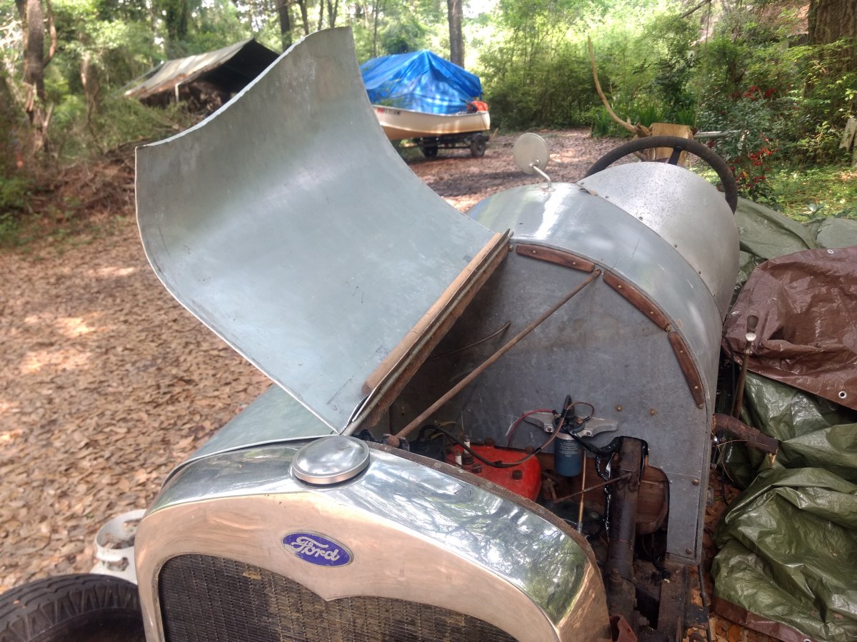

    All right, before I start this, let me tell you that this is my first attempt at any kind of metal panel work. I'm a woodworker. You may remember a while back that a big limb busted my hood. I stuck it back together well enough to keep the rain off, but it was never going to be satisfactory. I could have made another wooden one, but this seemed like a good opportunity to see if I could do anything with metal. The pictures don't really show it, but it has a seam formed by two 90 degree flanges that will be bolted or riveted together, just like the Ford truck hoods from the 40's. That's because of the metal I had available. I'm toying with the idea of putting one of those long br*** piano hinges in there, but that might just be too fancy. I know you guys are probably expecting a full shop with a sheet metal brake and all kinds of fancy stuff, but this will be more jack-leggery, I'm afraid. The front and rear edges are folded, just like a stock Model A hood (except sloppier). I debated making the sides straight, so I would have the option of adding side panels later, but I have really grown attached to the swoopty sides, and this way I can still use those dumpster straps and buckles. I am going to have to figure out a way to reinforce those curvy edges. I'm afraid if I try to fold them over, I'll screw it up. Anyway, here are the pictures:

  2. why not use some 3/16ths rod tacked about an 1" from the edge? easy to bend to follow the curves and gives some support.
    Stogy likes this.

    I'm thinking along those lines, but maybe some kind of about 1/8 x 1/4 flat, set on edge. Those lower curved edges are really floppy and seem kind of vulnerable, plus they want to bow out because of the different curvatures of the body and radiator. I don't really plan **** out, though. Just kind of piddle around and wait for inspiration.

    Well, I bit the bullet this morning and made a couple of s**** hardwood bucks that matched that bottom curve, clamped each side between them, and popped a 90 degree flange on each edge. It sure stiffens up those floppy bottom edges. Turns out it was a lot less challenging than bending the ends to match the curvature of the body and radiator shell. I used all kinds of lp tanks, OAC, fire extinguishers, but I still ended up with a few kinks and lines. That side with the air cleaner cut out was the one that didn't want to do right. In retrospect, I should have fitted the other side, then bent the air cleaner side to match it before I cut out the half circle. Hindsight... Some of you metal gurus will be shocked, but it doesn't bother me that bad. I might be able to hammer them out (never done any of that before, either). The last picture is of the busted wooden hood, so this already looks better than that. This whole rig is kind of rough around the edges. I'll probably paint it that same Rustoleum gray. The color and the brush strokes will cover a lot of sins.
  5. good job. thin the rusto out a bit and use a sponge roller. slice and tack a piece of 1/2" square tube to capture that air cleaner cut out.

    :rolleyes:...mmmm...aluminum...:confused:...or is it?...well whatever it is it's just another cool addition in this fantastic journey in Cool...it looks great @rwrj

    Nah, just plain old cold rolled steel. I'll make another ball cap bill for the air cleaner. It's pretty much going to be a steel copy of the old wooden hood.

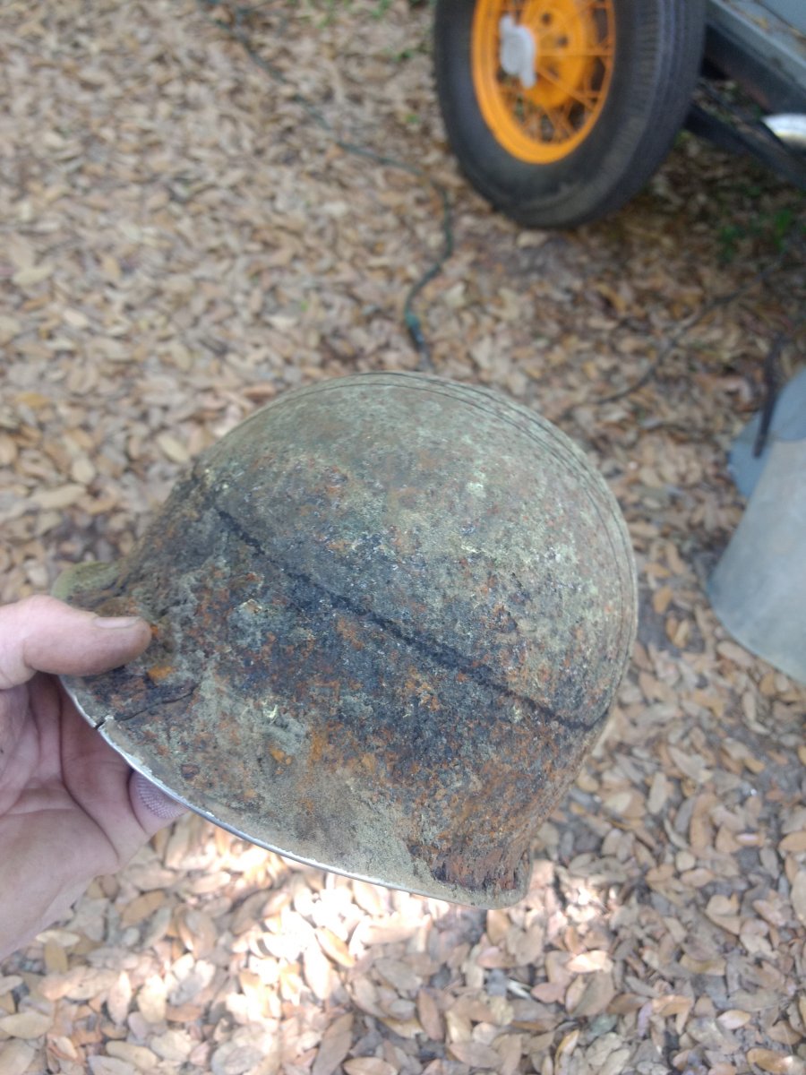

    Opinions?
    By the way, before you bust my chops about cutting up a rare piece of history, notice how the bottom edge is rusted through, and that's the good side.

    :rolleyes:...Spiffy...What is it, an old war helmet?
    I mean how can ya bust chops when you don't know what your busting them for...:D...Just kidding...;)...another exercise in your well honed resourcefulness.
  10. the steel hood is a lot better, good job.

    Yeah, Stogy, it's an old GI helmet. Nothing really rare about it, I was kind of kidding about that. I think I like it there better than the old cap brim, but I'm going to give myself a little time to ponder.

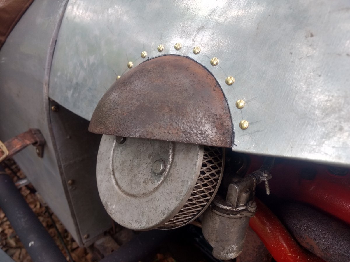

    Still not convinced about this. Looks a little too steampunk right now. I think when it's all the same color it will be ok. I know that's a lot of bolts, but the hood metal is pretty thin. I didn't want it kinking if somebody leaned on it or something
    Those are the little br*** bolts that hold the gl*** light shades into the little metal collars on ceiling fans and such, by the way. Washers and nuts on the back.

    I have no idea who this information will be useful to, but for what it's worth, those old helmets are made of really hard steel. Had to give up on drilling holes for the bolts in those little tabs I bent on the back and just cut slots instead. I even heated the tabs red and let them cool to anneal them, still wouldn't drill. Anyway, thanks for looking, feel free to comment up or down.

    I ***ume you're going to paint the hood grey and I think that would knock the br*** bolt heads back and look good. I think the over all design looks good!

    Thank you. Yes, all plain old gray. I am hoping it will all just blend together, too.

  17. Diggin your slow, methodical, pondering approach to things!
