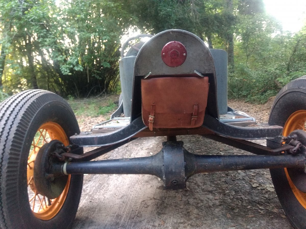

    This is what I'm leaning toward. The one on the back is just clamped in, the inside one is sitting on a couple of old VW coils. I get what you are saying, Sloppy, but I'm kind of reserving those little shelves to strap a couple of old suitcases or backpacks to for my first road trip. Hahaaa

    That looks good, seems like it was planned rather than an afterthought.

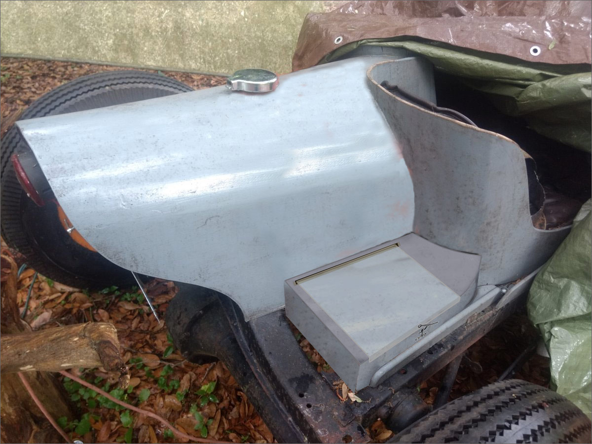

    Got some paint on the hood and mounted the saddlebags this morning. When the paint cures fully, I'll knock some of the shine off with a Scotchbrite pad so the evidence of my inexpert metalsmithing is hidden a bit. I guess I just wouldn't be me if I didn't end up with extra holes in the damn hood. Ha. Don't ask.

    If you put a rivet in each hole, they will immediately look like they have a job. Cool build.

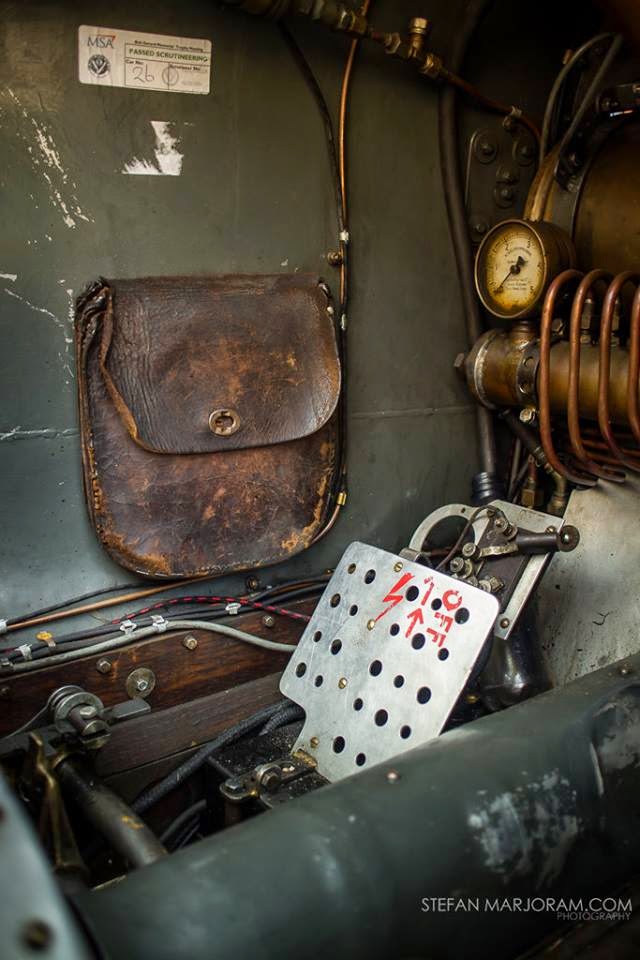

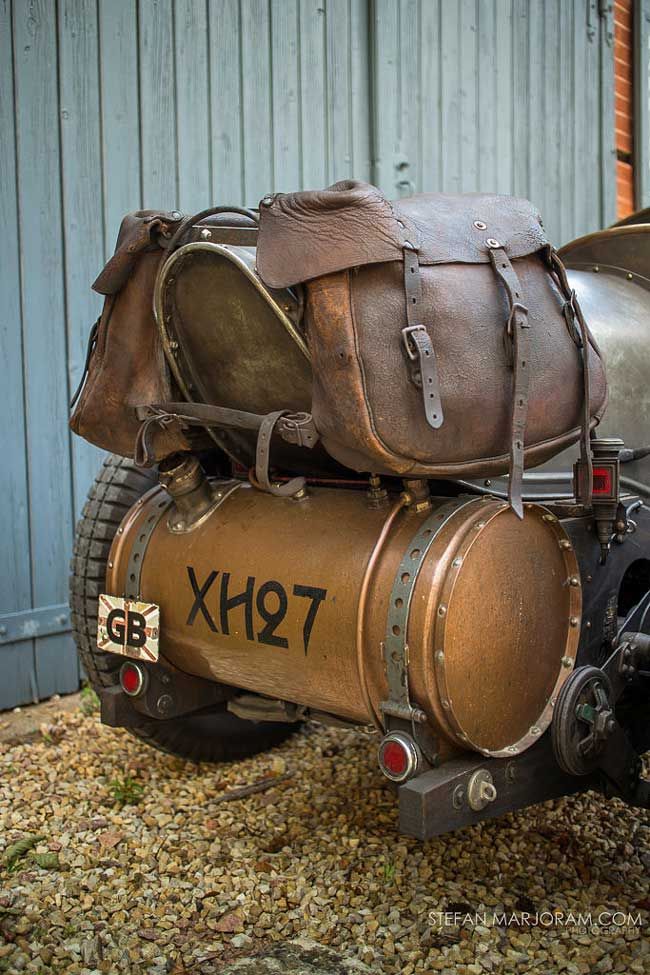

    The tail section looks similar to the "speedster" I want to replicate. Here are a few pics of his you might like showing his saddle and tool bag. Google Richard Scaldweld GN JAP for more pics.

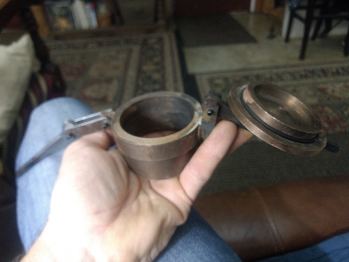

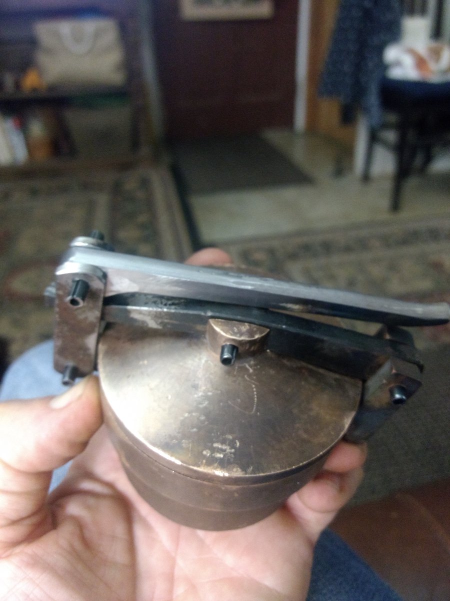

    I needed a better gas cap. The old Triumph Spitfire thing wasn't air tight, and I couldn't figure out a good way to attach or modify the pot metal base of it, so I made this thing:
    I turned the cap and base from some bronze bar stock. Had to cut that stuff with a hacksaw, took a bit of time. I can't overstate the value of a new, high quality, sharp blade. The ears on the base are silver soldered, I hope they hold up. The rest is made from good old cold rolled 1/4" sheet. I don't know when this style cap was invented, probably after the time period I'm shooting for, but oh well. I just slapped it together to make sure the geometry was right. My intention was to take it back apart and polish it up some. I'm not a fan of fake patina, but I kind of like the old, beat up look it has, so I don't know what to do yet. Anyway, here's a little video:
