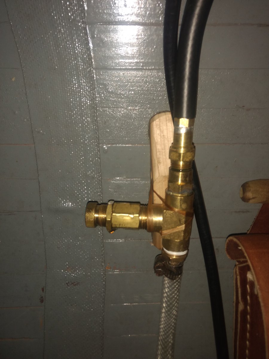

  10. Cool. Thanks for the reply! I am planning on a similar setup for my single seater once I get back to it. I'll have to go back through the thread to find the part about the check valve.

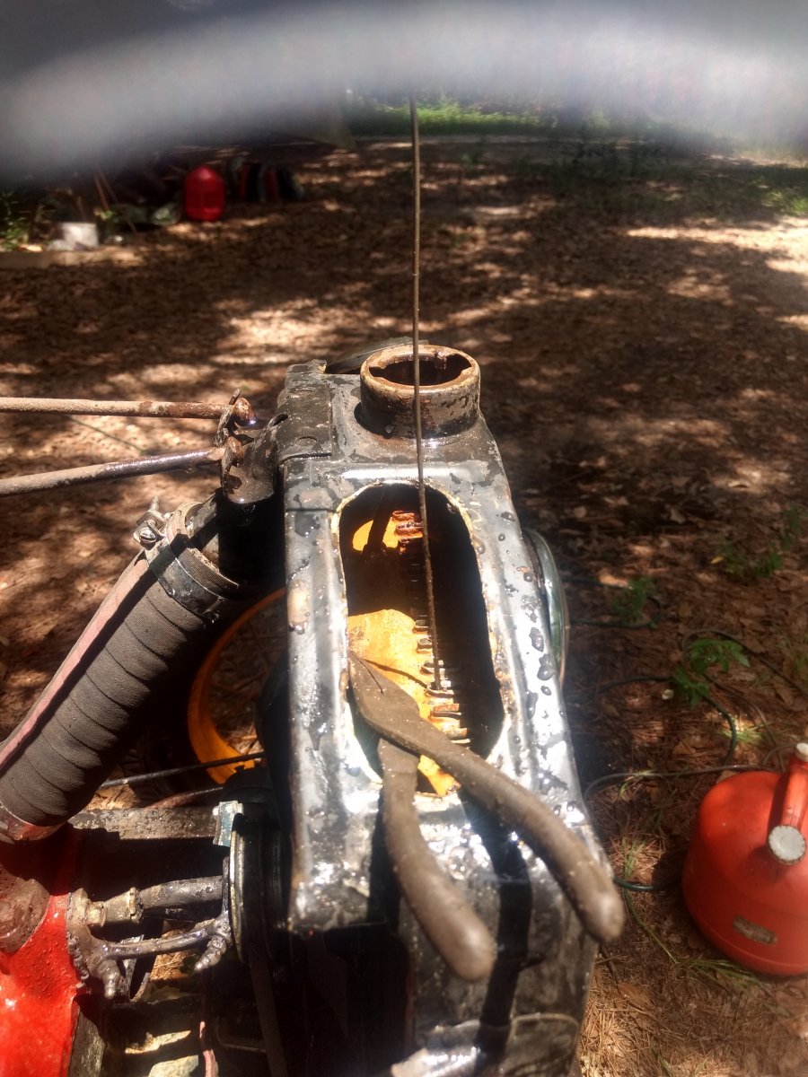

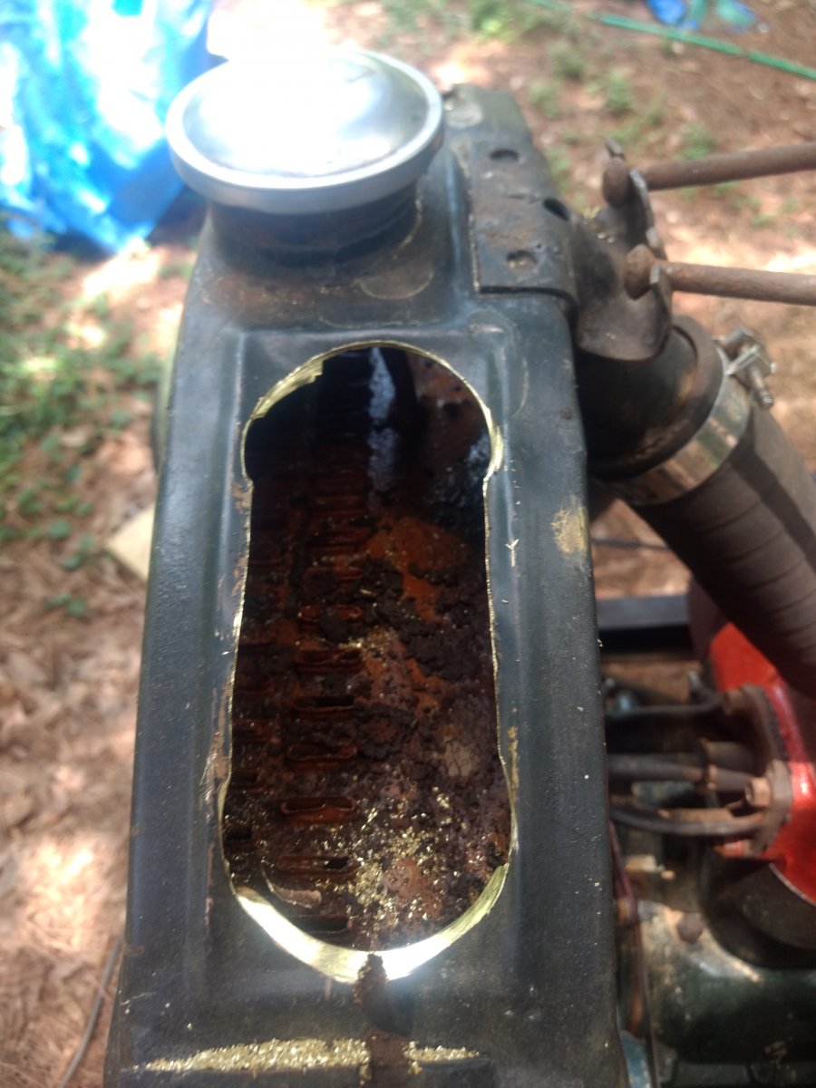

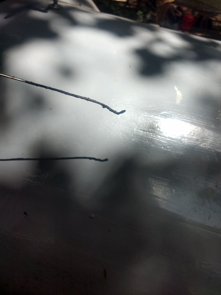

    I thought I had solved that overheating problem by adjusting my timing and mixture, but when I got back from my little jaunt yesterday morning, it was steaming and bubbling again, so I bit the bullet and rodded out the radiator. Boy, did it need it. I wouldn't suggest this operation for a show car. but what you do is take a hole saw and some tin snips to the top tank and open up as much as you can.
    Then, after you marvel at all the **** in there and clean it out some, you bend a little wiggle in the end of a section of stainless bowden cable inner wire and start jooging. I started with a simple 90 degree bend, but after the first time I pushed it through into the bottom tank and had to twist and cuss for a few minutes to get it in line to come back up, I went to a less acute angle. This self-aligns when you get it past the bottoms of the tubes. Much easier to deal with.

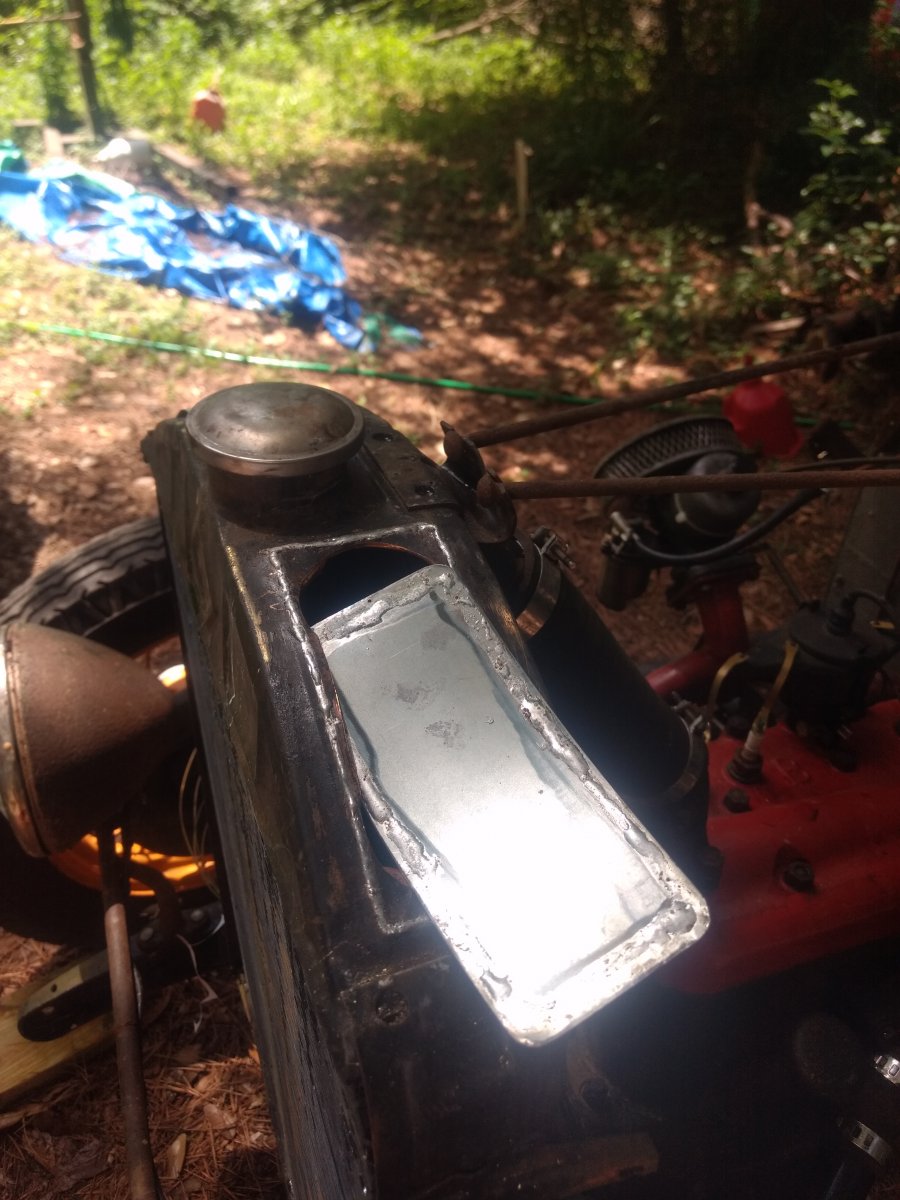

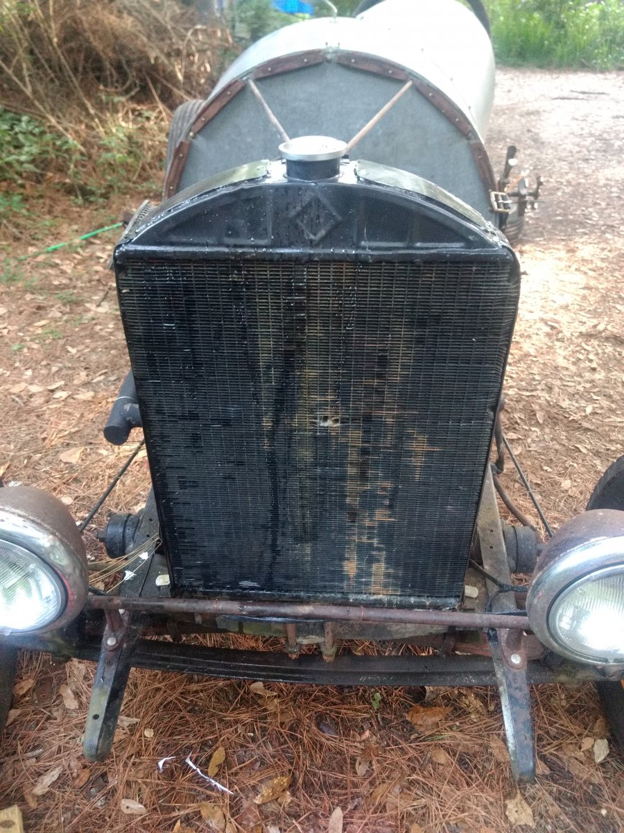

    Notice how greasy it is. Somebody busted a block and filled this old radiator with oil at some point in it's life. I'll bet half of the tubes were plugged. I couldn't get to the ones under the shoulders by the cap, but all the rest are clear now.
    Next, I flushed it out, cut some patches to shape out of galvanized flashing, and tinned everything up.
    About half a roll of solder and half an hour of filling, finding leaks, draining, soldering, repeating, and a dash of spray paint, I have this:
    I'm not going to lie to you, it's ugly as homemade sin, but it holds water. Those streaks on the front aren't leaks in the tubes, just leftover from me having to fill and drain the tank so many times to chase down the leaks in the patch panels. I did create or uncover a leak in one tube. You can see the good old JB Weld patch down at the bottom left of the radiator. Have to wait for that to dry before I can see how successful this operation was. Not a bad way to spend a Sunday afternoon, though.

  12. 48fordnut

  13. rwrj

    Cactus,
    This is my set-up, for what it is worth. The black hose at the top is coming from the pump. The check valve is between it and the tee. You can see a little solder where I had to make a hose barb fit it. I can't remember where I got that check valve from, I just Googled it. The left arm of the tee has the pressure valve screwed in to it. It came from Graingers, I just searched low pressure relief valve and it popped right up. The bottom hose goes to the tank. That other black line is the speedometer cable. It's important to have the relief valve after the check valve. That way, when the tank heats up during the day and starts building pressure, the check valve doesn't keep the relief valve from doing it's job. Sounds obvious, but I hooked it up wrong the first time. If you have a real pump with a built in check valve, all of that will take care of itself. I had to improvise.
    And yes, the tee really is just tied to that block of wood with string. The hoses pretty much support it, I just didn't need it flopping around.

    The way it was done back in the day was to have the top & bottom tanks removed and the core rodded out, then the tanks reinstalled.

    I agree, but I can't find a shop around here that still does that. They would also have had rods with the right cross section for the tubes, back then. My job is not as good, but I hope it will be good enough.

    Looks pretty clean. I had an oil cooler on a Cat leak oil into the rad water one time. After replacing the cooler, I ran water and Dawn dish soap through it a couple of times. Really cleans out the oil.

    The last shop around here that does it is closing the doors this Friday, the last day. The owner is retiring, and I ***ume he couldn't find a buyer, though that's just my ***umption, but it's a sad day for sure. This guy would not only repair radiators, but would build a radiator for any application, good quality, br***/copper radiators that will last a lifetime. It was a great resource to have locally. Such a shame to see it go.

    Same story here, except it was maybe 5 years ago. I'm 54, and that place had been open my whole life.

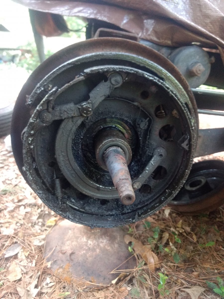

    Well, I started on my brakes. The whole time I was working on the radiator, the drivers side rear hub looked like this:
    Don't let the two wrenches confuse you. They are just spacers. There's a hell of a lot of tension in that picture. Glad I had sense enough to flip the axle nut and put it back on to save my threads. I had already tried the trick of loosening that nut a turn or two and driving around, didn't work. Three days of beating on it and spraying it with PB Blaster finally did, though. I had to straddle it facing away and take a two handed swing with my bfh on the end of that puller. Both tires off the ground so everything could move a bit. Bam, and it popped loose. The other rear hub came off easy, thank goodness. Fronts, of course, were no problem. Here's an idea of what 90 year old brakes look like:
    What a mess. Under all of that, the pads are pretty thick, and the drums measure out ok, too, so I decided to clean them up and tear them all the way down. I'll spare you a detailed account of what a pain it the *** that was, but I'm glad I did it. Model A rear brakes have a little cam that engages a couple of rollers on each shoe. The cam is supposed to slide in a carrier so that the shoes get equal pressure. Those and the rollers were rusted tight on both sides. The adjusters at the other end of each shoe were also stuck. It all cleaned up fine with some careful wirebrushing. I have the drivers side back together. The through-rod for the emergency brake is siezed on the p***engers side, so I'm in the middle of that, but I have finished the service brakes for that side. Still have the fronts to go. I'll keep you posted. Here's the drivers side back together:
    I'm hoping those old greasy pads will still work. If not, I've done all the hard work, changing them out shouldn't be too bad. One end of the E brake lining is missing for a few inches, but I don't think its too big of a deal. It's the trailing edge, and it's just the E brake.
  21. Blues4U
    Joined: Oct 1, 2015
    Posts: 8,068
    Blues4U
    from So Cal
    Did you try any heat?
    Stogy likes this.
  22. rwrj
    Joined: Jan 30, 2009
    Posts: 878
    rwrj
    from SW Ga
    I did. That thing was stuck to a fare-thee-well. I scoured this site and Fordbarn, tried every trick they suggested. Lifting the other wheel off the ground was key, I think. It took a really hard lick with the hammer to pop it loose, hard enough that I was worried about the gears in the rear end, but I've turned it by hand and I don't hear or feel anything weird, so I hope I'm ok.
    Stogy likes this.

    That's one of those areas we all must be careful Brake lining made of the bad stuff...The Grunge may have
    actually helped contain that ****...

  25. rwrj
    Posts: 878
    rwrj
    from SW Ga
    Yeah, apparently it lets the axle move a bit more when you smack it.
    Stogy, Blues4U and 48fordnut like this.
  26. Fabber McGee
    Joined: Nov 22, 2013
    Posts: 1,458
    Fabber McGee
    My dad told me he used to just leave the weight of the car on the wheel, remove the nut and turn it around. Then a couple good licks with a 16 pound hammer and the hub would always come loose. Of course, the oldest Model A at that time was only 10 or 12 years old, not 90, haha.
    48fordnut and Stogy like this.
