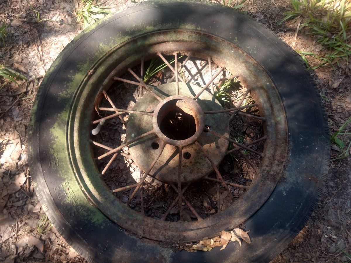

    I suddenly remembered where one of my father's old wheels was and drug it out. It looked terrible, but it was mostly just heavy surface rust that wire-brushed and hand sanded off pretty easily. I painted it with original style Rustoleum primer. I'm going to have to re-paint all 4 rims now, no way I'll match that yellow on just one, but that's no big deal. Here's a before and after picture set:
    I was tempted to run up to town and have the tire switched over, but decided to try it myself, and I'm glad I did. It took less time than just getting to the tire shop would have, and gave me a sense of accomplishment, to boot. I've been wondering what to do about a spare for this thing, now I think a tire iron, an inner tube, and a bicycle pump will be all I need.
    Anyway, I made a little video to show the difference between the two wheels. The new (?) one still wobbles, but no worse than the rest of them. It doesn't show up in the video, maybe because of the angle I'm filming from, but the old one is twice as far out, and it's a real abrupt change over a smaller section of the rim, if that makes sense. It introduced a really noticeable shaking at speed, really disconcerting to me. It's still not what you would call a smooth ride, but it sure seems safer now. I have some of those dynamic balancing beads coming in the mail, I think they will help, as well.

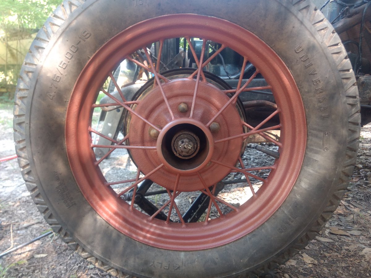

    I know red wheels are kind of cliche, but I have my reasons. Like I said, I couldn't match the yellow for my "new" rim, so I was going to have to paint them all, anyway. I have never been a big fan of those yellow wheels, but that's how they were when I got the ch***is, and I just haven't gotten that far down the priority list until now. I do want the wheels to stand out for the sake of visibility. I want people to see the car on the road. Not because I'm a narcissist, but for some modi*** of safety. All things being equal, I'd paint them black, but black wheels on a grey car... I'm afraid I would just blend into the road. At least it's the same red as the cylinder head and intake manifold. Hahaa. You might also notice the red radiator guard. I made that out of the wire shroud of an old swamp cooler. I wanted to center those two sections of closer-together wires, but it wasn't wide enough to do that, so I just did what I could. I've already poked one hole in the radiator with a stick blasting around in the woods. so I thought this would help. I'd prefer it black, too, but...
    Oh yeah, I'll put my hubcaps back on once the paint is fully cured.

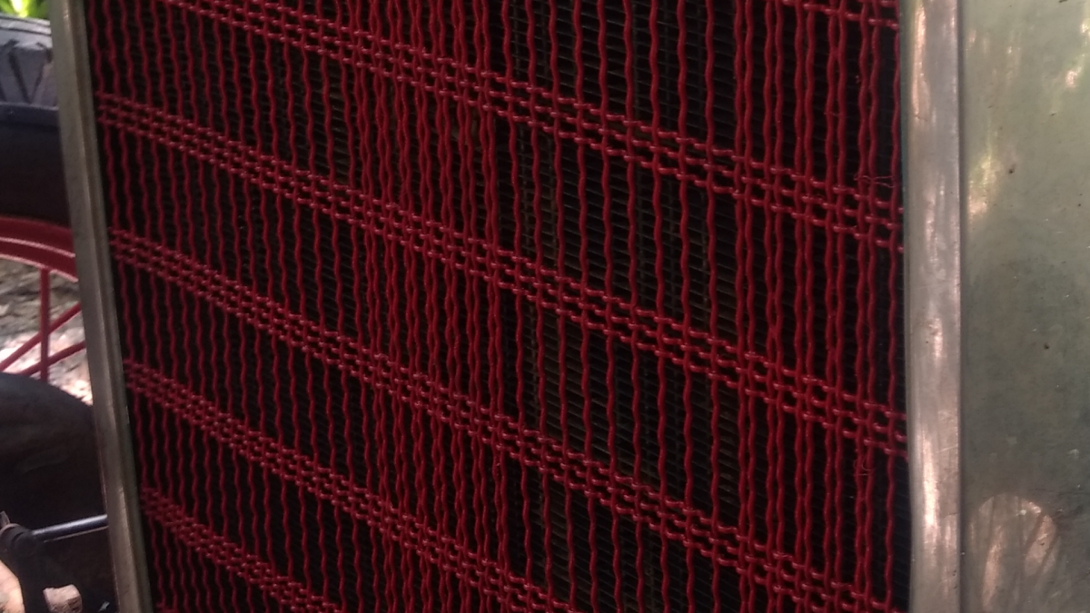

    I like the red. Don't see why so many guys don't care for it. It is pretty traditional like everyone seems to worry so much about on here.

  16. Inked Monkey
    Joined: Apr 19, 2011
    Posts: 1,850
    Inked Monkey
    I like the red mesh in the grille. It kinda looks plaid

    Thank you, Fabber. The red is growing on me, and I really like it much better than the yellow.
    Inked,
    Thanks. It's a little weird with the extra section. I thought about figuring out a way to remove that one set of extra wires, but I kind of like it like that, too. Fits the car, I guess. It's a cool thing, made out of these little kinked rods.

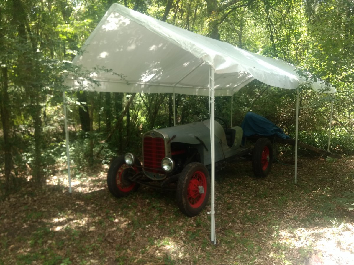

    Old Shadetree has some new digs, Y'all. No more dashing out to cover it up with a tarp every time it clouds up a little. Getting fancy down here. If you look carefully, you can see my little v8 60 waiting patiently in the back.

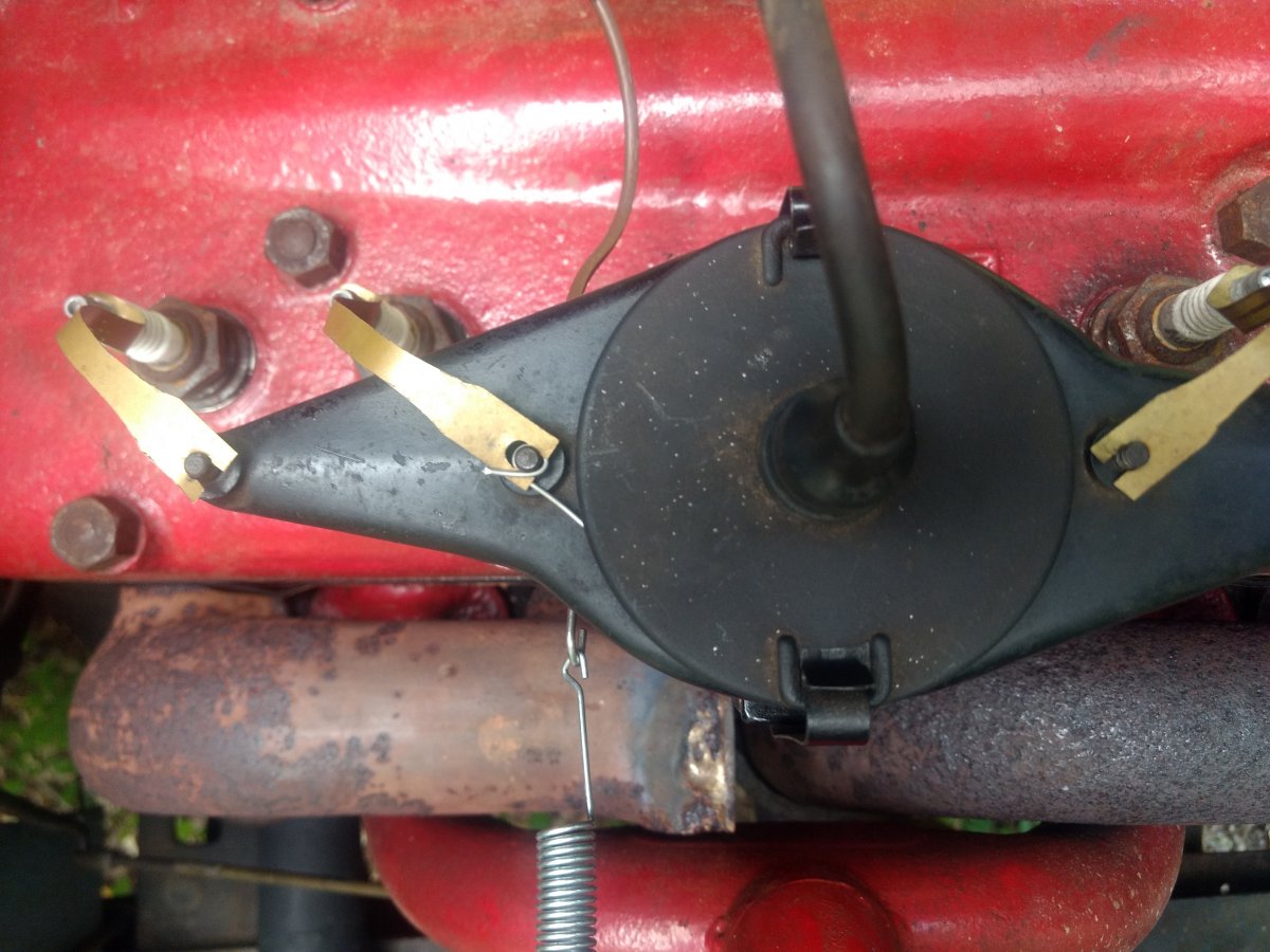

    The old girl developed a dead skip. What I love about this thing is how simple and honest it is. Just take a scredriver (with a non-conductive handle, voice of experience there) and short the plugs one at a time to a head bolt, #3 had no spark. Funny thing, on first start-up, there's a strong spark, but after a minute or so, nothing. Swapped #3 and 4 plugs, #3 still dead, so not the plug. Didn't have a new condenser to try, so I sat and pondered for a bit. Must be the cap. sanded the rotor ends and the little metal studs in the cap a little, didn't help. Broke out the multi-meter and checked for continuity from the studs on the inside of the cap to the ones on the arms, all is well. Checked resistance, and #3 reads spotty and low. Must be a break in the wire inside the bakelite arm? I ordered a new, modern-wire style cap and a spare condenser then, rather than sit around waiting, I started fiddling. Rigged up this little wire and filed a notch for it in the cap rim, kind of duplicating a desperation roadside repair job. It worked. Try that with a computer controlled modern mess. Hahaaa. (Don't worry about that #4 connector being loose. One or another pops off every time you unclip the cap.)
    I also found another small saddlebag and mounted it on the drivers side. My knee touches it when I'm cruising along, but it's not obtrusive. Doesn't stick out past that new frame. Just another spot to put miscellaneous little bits and pieces. My spare condenser, when it comes, for example. I have a screwdriver (straight slot, dammit), a pair of pliers, and a Crescent wrench in there right now. It's more convenient because of the little twisty metal closure. The other ones are much bigger, but the buckles on them are more trouble to deal with. Anyway...
    I'm going to miss the look of those br*** straps going to the big old plugs, but I wont miss getting sensitive parts of my anatomy too near one of them accidentally while I'm messing around with other stuff under the hood. It'll pop the hell out of you.

    Got the new distributor cap in today's mail. Couldn't wait to pop it on there and see if it solved my problem. The wires are from a kit at Tractor Supply. I had to buy the whole thing a while ago just to make a coil-to-distributor wire for something or other, so I was delighted to get some use from the rest of it. I might have cut a couple of the wires a little short, but it came with about a mile of the stuff, so I can just re-make them, if I decide to. Here's the proof:
