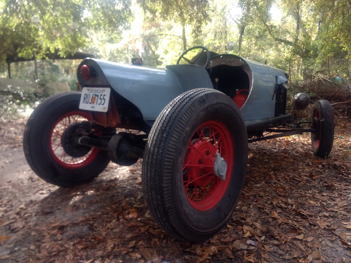

  5. rwrj
    Joined: Jan 30, 2009
    Posts: 882
    rwrj
    from SW Ga
    1928 Ford Model A modified.

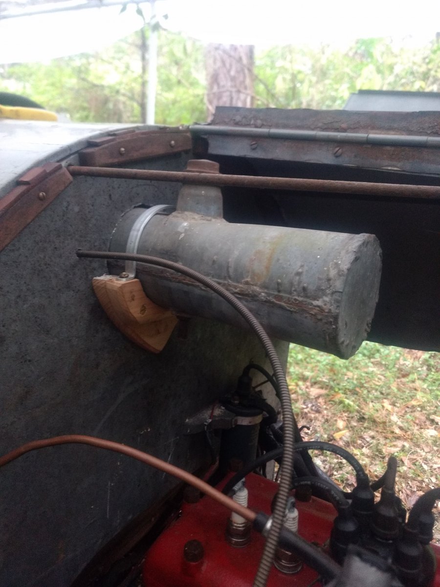

    While I'm waiting on my new springs, I've been piddling. I'm worried about the difficulty of ***essing how much fuel is in this thing. Right now, I'm just using a dip stick, which works fine in a rough, inexact kind of way, but I can easily foresee running out of gas on some remote back-road and having to suffer the indignity of calling for rescue. My solution is a reserve tank. I have the old homemade galvanized tank off of an antique garden tractor my father acquired somehow years ago that I had zip-tied to the early T firewall back in the very beginning of this adventure, figured I could run it as a gravity fed reserve if I mounted it on the firewall. Got to thinking about it and holding it up in different spots, and settled on cutting a hole in the firewall and mounting it longitudinally instead of cross-ways. Fits better, and gets the fill neck a little farther from the firewall. Before any of you point it out, I know its over the hot exhaust, but I figure I'll mostly be filling it with the motor cold, so that should be ok. It does have 4 tiny holes in the cap for venting, but I don't remember it ever sloshing liquid gas out of them when it was on the working tractor. I'll keep an eye on it, I promise. Here's where I am now. and how I got there:
    I know that tank looks like a mess, but it doesn't leak, and it has sentimental value to me. It was already old when we got the tractor back in the 70's, so it's a relic of my childhood.
    The plan is to run the main line up in a loop above the height of the new tank so It won't just gravity feed back into the main tank, then back down. I'll put pet**** at the bottom of the tank and tee the main line in below that. With the pet**** off, the reserve tank flow will be blocked, and the rest of the system will operate like it does now. When I start to run out of gas, I'll reach back and crack the main tank cap to release the pressure, and I'll try to rig it so I can open that pet**** from the dash. We'll see.

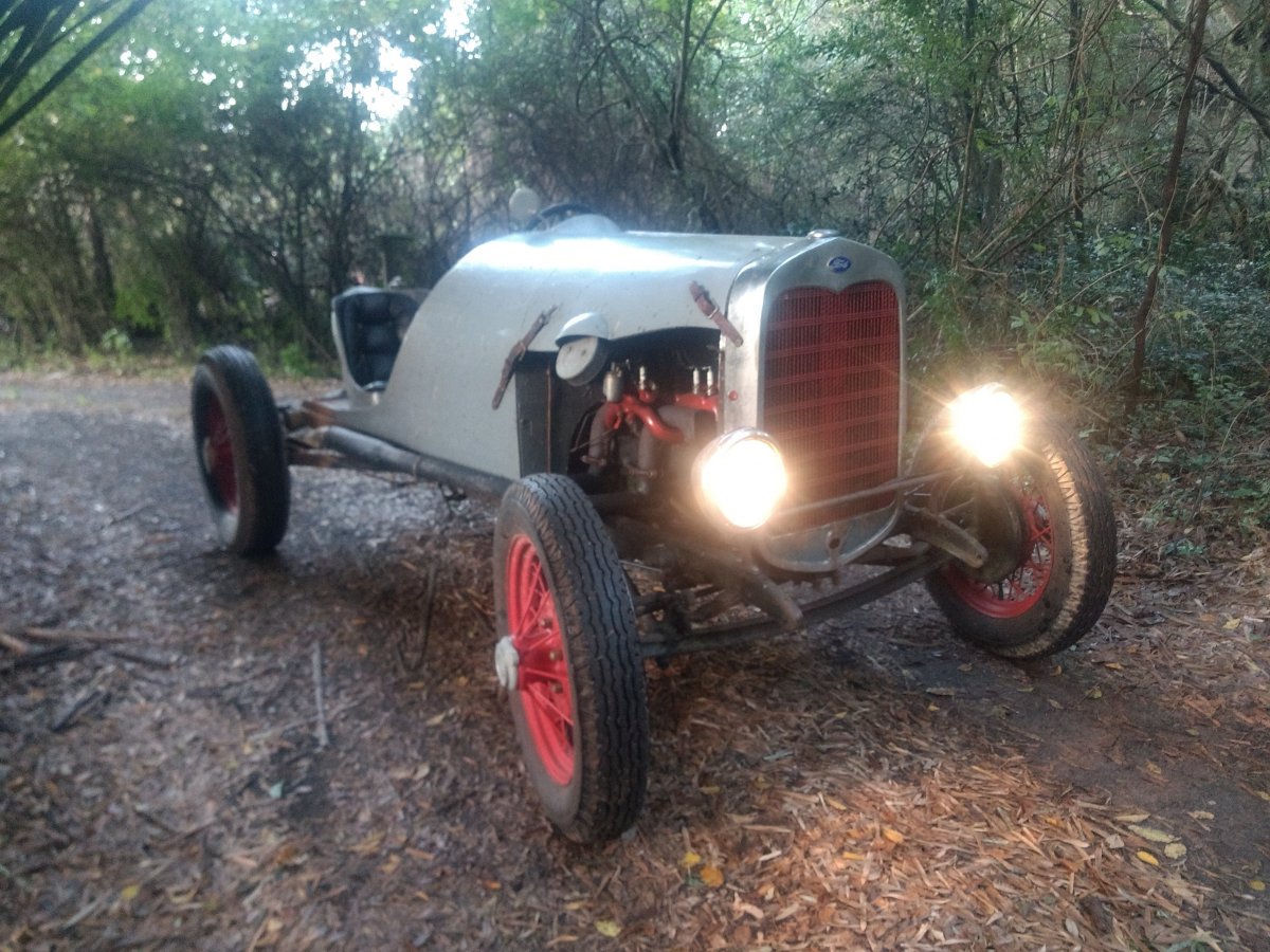

    I went for a little trip late this afternoon of about 30 miles. My cousin and his daughters were up from South Florida, staying farther out in the country. I took a roundabout route of back roads, about 5 miles of it on dirt. We had a cold front move through this morning, with rain, and that red Georgia clay was slick. The tires threw a good bit of mud, more from the wet sandy parts than the clay, oddly enough, but it didn't really get on me too bad. The washboard was pretty pronounced, though, and me and old Shade Tree got jiggled mighty good. Right after we got back on the pavement on the way out there, she started skipping and backfiring. "Dammit" says I, "you've done shook a bunch of sediment up in the tank and plugged the fuel filter, or vibrated the damn ancient fabric timing gear to pieces, or rattled the manifold brazing aloose, or..." I pulled over and she died. Hit the starter rod, nothing. The only thing that had rattled loose was the negative battery cable. Hahahaa.
    Anyway, the only other eventful happening was when I p***ed the dipsy dumpsters at a crossroad, fellow taking out his trash hollers "that thing is cool" as I was idling at the stop sign. I thanked him and blasted off, didn't feel hardly self-conscious at all. The cousins all loved it, too, but they've been raised right. Visited until almost dark then headed home. I was smart this time and took the little wooden battery cover off so I could ride that dirt road with my heel on the battery, keep it from bouncing around so much. I'm going to have to tie it down, somehow.
    Well, I'm making too big of a deal of this (some of you fellows take real trips in your hot rods), but I really enjoyed it. Even had to turn the headlights on towards the end. Here are a couple of fuzzy pictures.

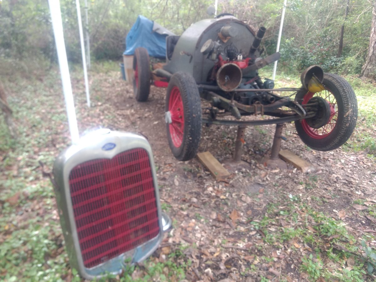

    Well, I stole a couple of hours this morning from Santa Clausing and got a start on the near complete valve-train rebuild. Too bad I didn't find that camshaft when I had the engine all torn down, but that's just not how things usually go around here. It started raining after that first picture was taken, but my tarp shelter isn't leaking, so I forged ahead. I think the pictures are pretty self-explanatory. The only detail that doesn't show is that I have dropped the oil pan, too. Just FYI, if you cut the wheels all the way, it will just clear the tie rod and drop without much fuss.
    Tomorrow I'll try to get the timing cover off. Have to remove a couple of the rear motor mount bolts and jack up the front of the motor to do that. There's a bolt hidden behind the solid front mount on AR Model A's. Might get the valve-train removed tomorrow, too. Who knows? Anyway, I'll keep the thread updated. Thanks to all of you who are following along.
