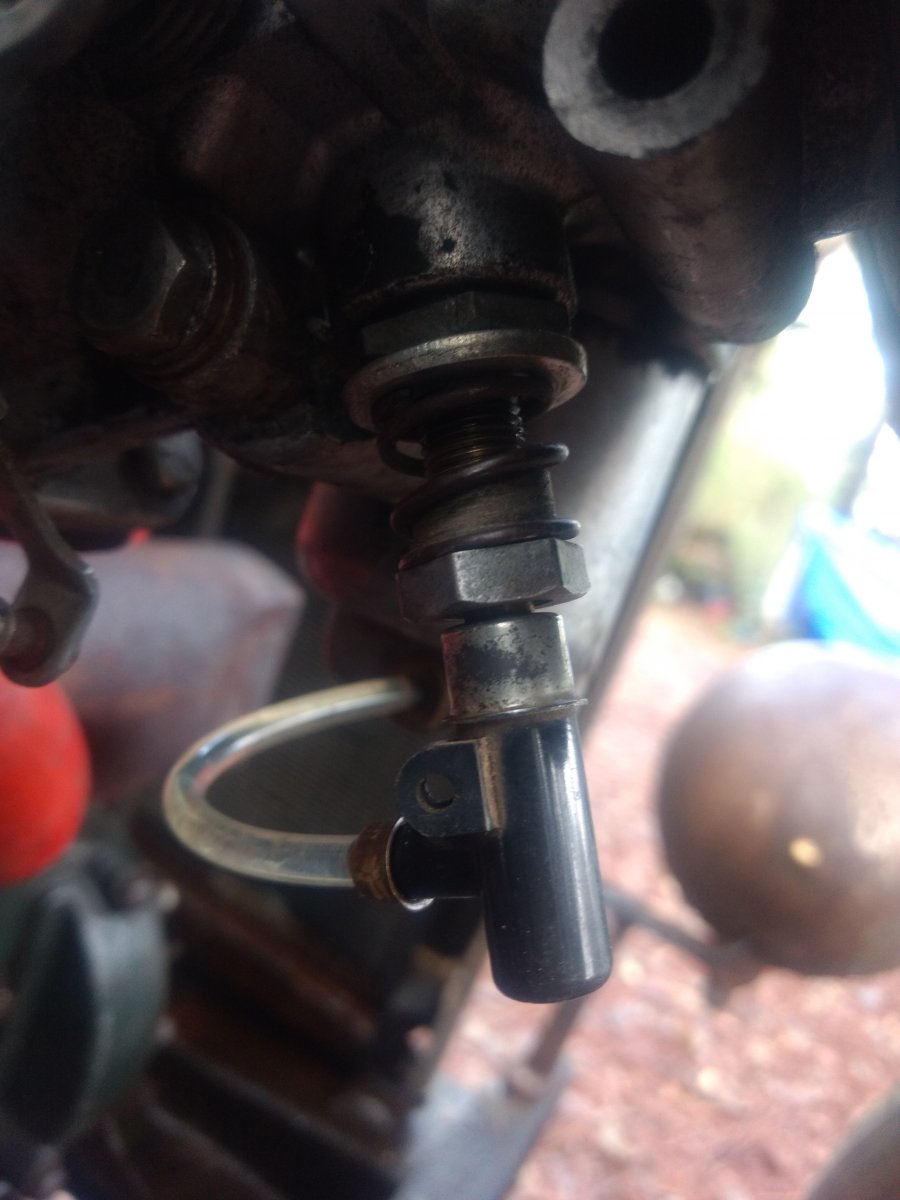

    I adjusted the valves again. I didn't do a good job the first time. I don't have a hand crank for this thing, and I don't think I was successfully getting all the way around to the heel of the cam on every valve without one. All but one of the gaps were off, all too wide. I made this thing this morning from an extension I ruined trying to get an O2 sensor out of a cursed non-Hamb mess we used to own. It is way too weak to start the car, but it will turn it with the plugs out.
    It was sure worth the 30 minutes or so it took to slap that together. I also recommend taking the manifolds off, also worth the extra few minutes.
    The jackleg crank made it much easier, and I'm confident the lash is right now. Here's a video of the idle:
    I haven't road tested it yet, but I'm pretty happy so far. Knock on wood.

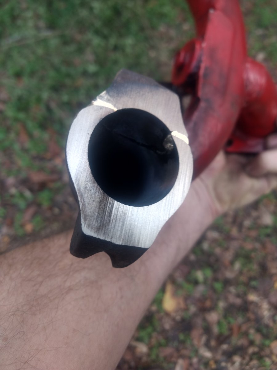

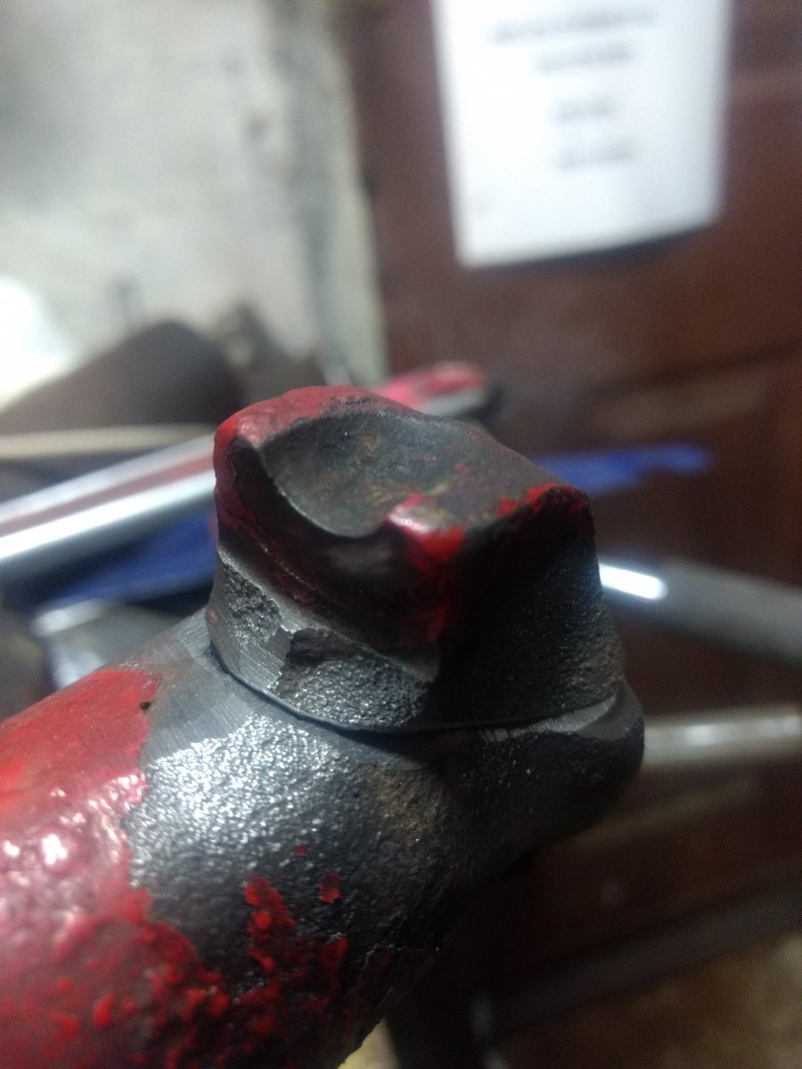

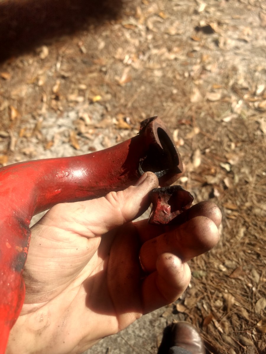

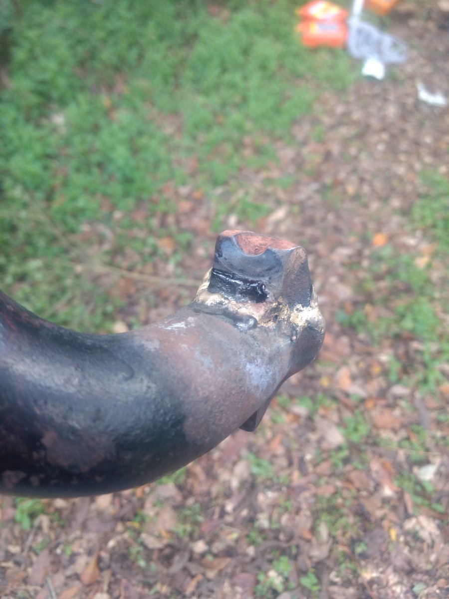

    That's the intake manifold. Guess I tightened it a little too much when I put it back on from adjusting the valves the 2nd time. That ear must have popped off as it was cooling down from my second run- in. Dammit. I know that crack looks rusty and old in the picture, but it's just the lighting. Honesty compels me to report that the broken edges looked real fresh, no evidence of a previously existing crack or casting flaw. This one's on me.
    Anyway, I wirebrushed it down and sanded the outside edges back and brazed it yesterday. Went back this morning had hit a couple of spots on the inside where I hadn't gotten a complete flow through, then faced it off and threw it back on there (carefully, you know), didn't even touch up the paint I had burned off, Y'all. I like the way the brazed repair kind of winks at you from the depths, even though it's not the prettiest job. I decided not to sand it down and pretty it up, but left it ugly for strength. It fits the rough and tumble nature of the car, anyway. Knock on wood, but it seems to be running well again. The low this morning was in the mid 30's here, and it's still in the mid 40's, so I'm going to wait until after lunch for a shakedown run. I'll do my best to post a video, if no new thing arises.

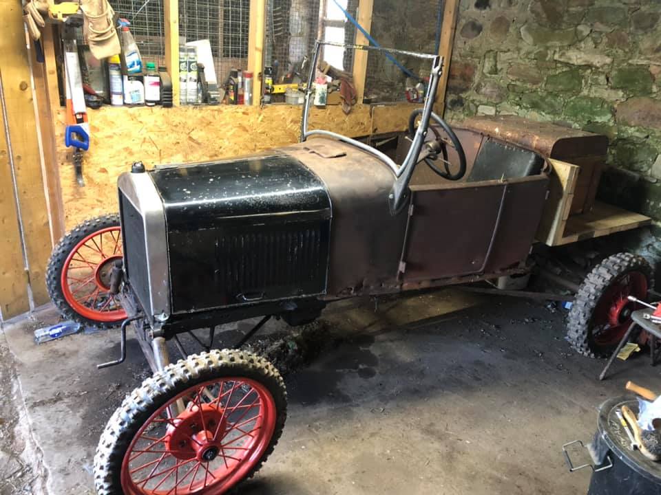

    Something I should do, in the meantime here is a recent pic of it 73252289_2815128861865060_7070073681740824576_n.jpg 73308229_2815128878531725_4454350276769349632_n.jpg 72104744_2770731952971418_4779299015529332736_n.jpg
  17. rwrj
    Joined: Jan 30, 2009
    Posts: 878
    rwrj
    from SW Ga
    That's just perfect. Thank you for showing it. I really like it.
    BeaverMatt and Blackbob like this.
  18. Blackbob
    Joined: Nov 19, 2008
    Posts: 191
    Blackbob
    Thank you :) still a lot to do but I am enjoying fettling it into shape.

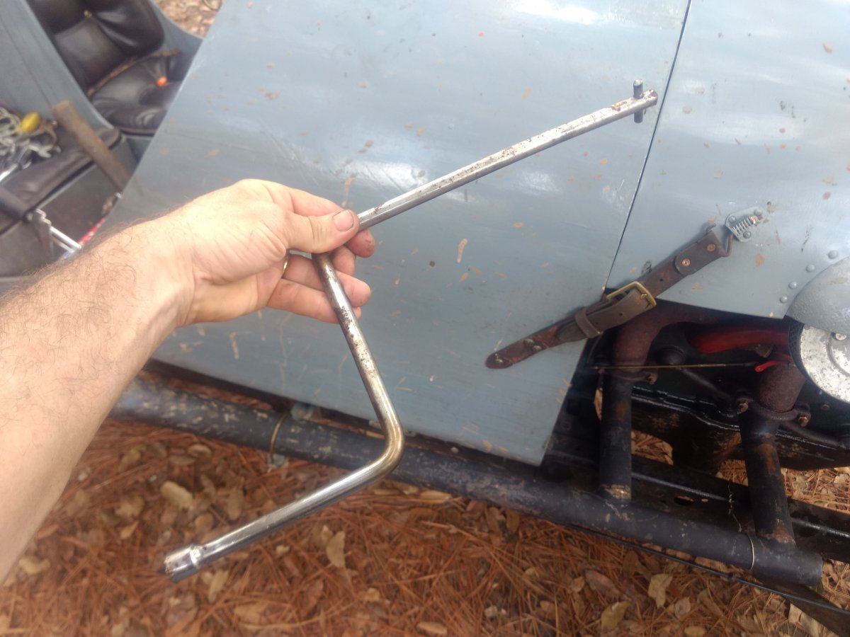

    Did some drilling and cutting.
    I rounded off that stub on the pet**** where the handle was, dis-***embled the remaining part of the u-joint so I could drill a new hole 90 degrees to the stock one, drilled another hole through those ears and the handle stub, popped in some jackleg rivets, and got this:
    It's not too pretty, but it will allow me to run a rod through the firewall so I can switch it from inside the car. I might just use a 24" extension and fab up a handle for the inside. Why complicate things?
    The idea is, when I run out of gas in the main tank, I'll just reach behind me and pop the gas cap to release the pressure (it's possible without too much contortion), then switch to the reserve tank and poot on off. I'll loop the fuel line from the rear over the reserve tank, so I don't just gravity feed back into the main tank, then tee it in just past the pet****.
