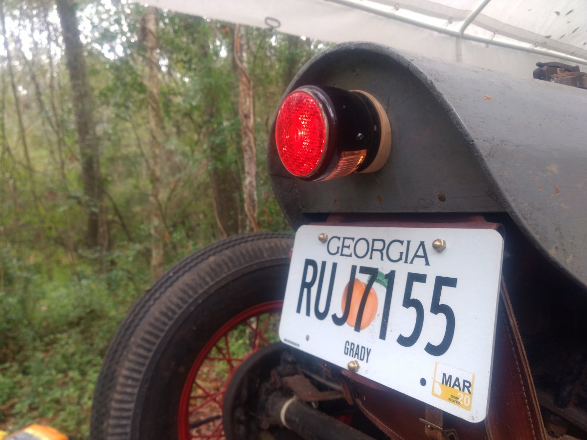

    Rain this morning, so no test drive. I did take another couple of thousandths off of the bottom end of the needle. Since I couldn't drive, I piddled. The plastic trailer taillight has been bothering me for awhile. It was always just a stop-gap. I bought an older metal one off of the cl***ifieds here, decided to use it instead. It's not really "period correct", but it's a lot better than the box store special. Installation was pretty straightforward. I just made a little angled wood block to get it level. Some drilling and bolting and wiring and I was done. The first picture is the old one.
    I guess the difference is pretty subtle, but I like the fact that it is older, metal, and I think the lens is a definite improvement. Plus, it's progress.

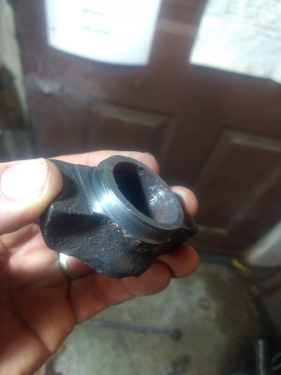

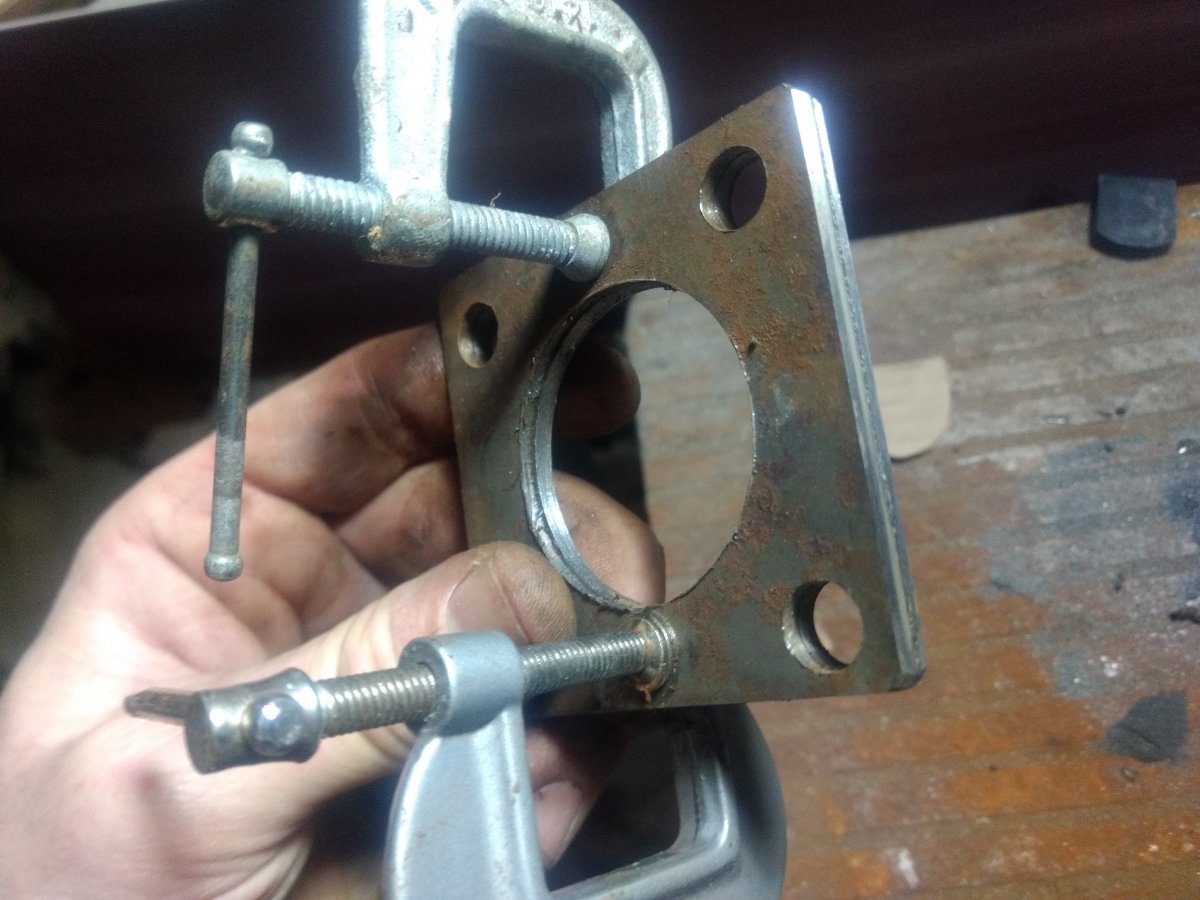

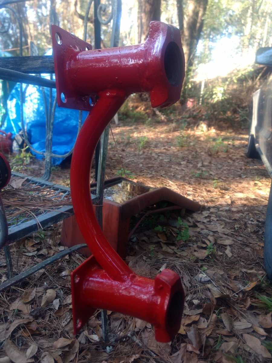

    All right. Opportunity knocked in the form of a post in the cl***ifieds by lake_harley for a pair of H6 SU carburetors from a Triumph TR4, so I bought them (thanks again). They appeal to me because there are two of them, and because my HS6 was introduced in the early 60's (as I recall, too lazy to Google it right now) and the H6 is the older version, dating back to the late 30's (again, too lazy...). They arrived in good shape, and I immediately ******ed them off of the Triumph manifold and started figuring on how to fit them to my Model A block.
    I bought a 1 3/4" id conduit elbow from the local big box store. Cut the mounting flanges off of an old stock banger manifold (I'm keeping the current carb/manifold intact, just in case) and chucked them in the lathe to turn a seat for the conduit.
    I had to slice that end of the conduit and braze it back to reduce it, and I know I'll still have a big shoulder right there, which is far from ideal, but oh well. Brazing that thin conduit to the cast iron was pretty tricky. I eventually got them sealed up, (had to use a bit of JB Weld, shhhhh) but it's not too pretty. I measured carefully and clamped the flanges to a board to keep them lined up and fitted a 3/4" cross-pipe, then marked, un-clamped, and drilled holes in the main runners before re-clamping it all and brazing.
    I've always heard dual carbs need that cross connection, and every stock dual SU intake I've ever seen has it, so I figured I'd better have one, too. Hope it's big enough in diameter. Next I made the plates to bolt the carbs to.
    Nothing special, just hacksaw, holesaw, drill bits, and the edge sander. I clamped them to a piece of angle iron and brazed the rest of the mess to them.
    Sanded the JB Weld almost all back off, painted it up and called it a day. It's drying now. I'll take the carbs apart this afternoon and make sure everything is ok inside. Lots of piddling around to get the throttle linkage and all, but hopefully I'll be able to see something next weekend? Knock on wood. Thank you for looking.

    Mine may not actually be a Triumph manifold, that's just what the little paper tag wired onto it says. The runners on it split into two ports each after the balance tube, which made using it too much of a challenge. I also can't weld aluminum, all I have is an OA torch. Thank you, 97, for complimenting the manifold. Too bad it won't work. I've gone to some effort on this thread to own up to and describe my mistakes, so here goes nothing.
    As soon as the paint was set up enough, I couldn't resist holding it up to the motor. Dammit. That balance tube won't clear my home-made dual exhaust manifold, so I ran back to the store and picked up a couple of 3/4" conduit elbows. Modified it like so:
    I'm not going to lie, I was pretty proud of myself for figuring out all those angles. Almost made up for not checking the fit the first time, before I brazed it up. I brazed the new work up and dashed outside again. Damn if I hadn't put the bend in backwards, sticking in TOWARD the exhaust manifold. Kind of lost that good feeling. Oh well, at least I knew myself well enough to have bought two elbows. Third time's the charm:
    At least I feel like I'm getting a little bit better at brazing, with all this extra practice. Hahaha. I think I'll have a beer.

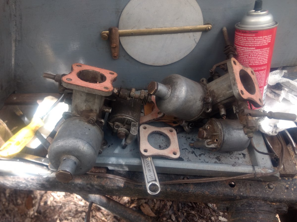

    I got an unexpected day off from work because of the weather, and put it to good use. I had already torn the carbs down and cleaned them up. These carbs use an adjustable throttle connection so that you can set each idle independently, then lock it down. Trouble is, mine are now farther apart than they were, so I sawed the middle rod of the ***embly in half and soldered each end into a 1/8" br*** pipe.
    There's a video below that shows how that thing works. I also made a br*** plate (that you can see in the video, as well) to hold the stock Triumph throttle bell-crank (forgot to take a picture of that, you can kind of see it in the video, too), and reversed the orientation of the choke/enrichment linkage. I still have to make a longer rod to connect the two levers for that system, and run a longer choke cable down to it. Anyway, I got it all installed before the rain hit, and she started right up. I won't go into the ritual of adjusting dual SU carburetors here, Google and Youtube will take care of that, if you're interested, but I have it pretty close, and I'm pretty happy with it. Won't be able to get on the road until the weekend, but I'm hopeful. Here's the proof:
