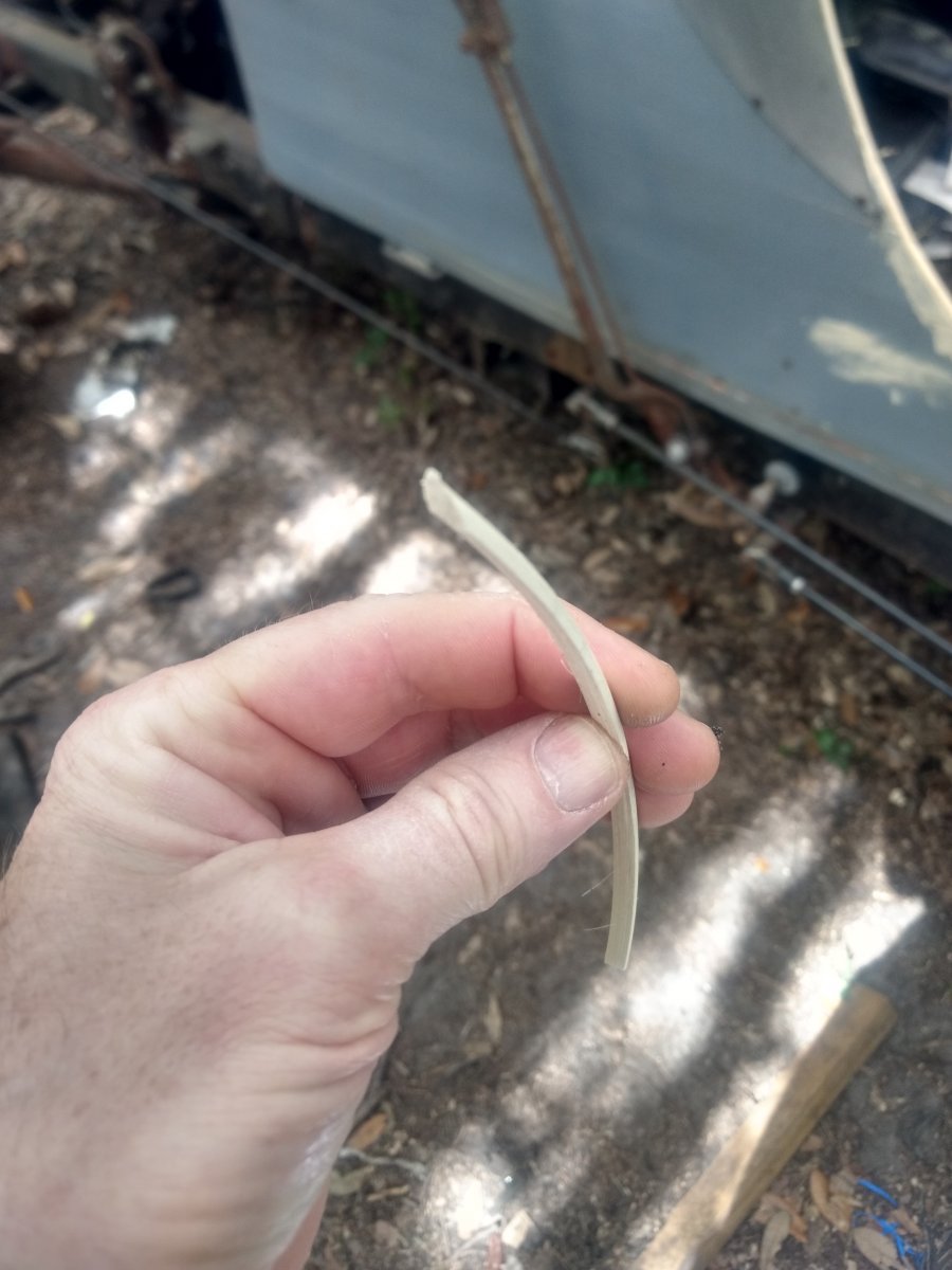

    The first step was to flatten the edges with a 4 in hand rasp. I had rounded them slightly back when I built the body, but I need a flat to glue to. You can see the bead and cove edges of the strips pretty well in this picture.
    Then I tacked the half round on with tiny nails. It's really flexible, which made taking the bends easy, but also meant that I needed a lot of nails.
    Next, just paint on the epoxy and let the capillary action draw it into the cracks. This takes a little time, because you have to keep going back and repeating the process until there are not holidays (little cracks with no glue in them). I used some masking tape to make sure I didn't drip through onto my dashboard and saddlebag. After I was satisfied that I had enough glue penetration, I mixed up a little fairing compound and went over the whole business.
    It might be hard to see, but I went around the terminal edges of the rear projection, the seats, and the main cowl. Now it's just a matter of letting it all dry, pulling the nails, hitting it a lick or two with some sandpaper (that fairing compound sands really well), and painting. I might sand the whole body and re-coat it, or just touch up, depending on how I feel.
    Here's a picture of a s**** of the half round, just for educational purposes:
    I'm pleased with the results, so far. Once it's sanded and painted, it should look better than the exposed end grain did, and, most importanly, it should strengthen the whole structure. And, once again, even though I used a modern epoxy glue, I could have done this with one of the glues they had back in the day. Probably should have, but the epoxy was at hand, so...

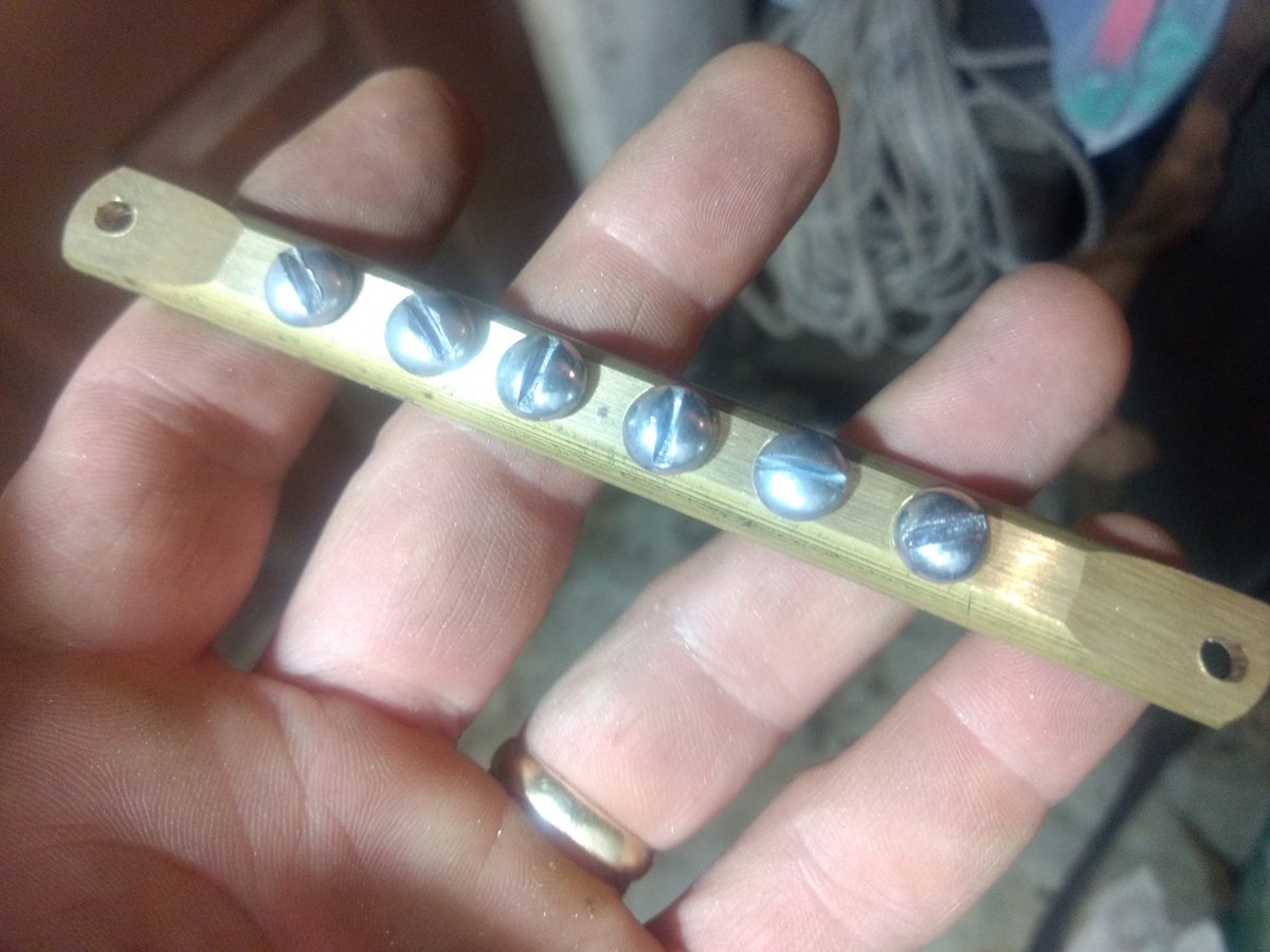

    I've also decided it's time to do a more proper wiring job on this thing. To be perfectly honest, a little mishap that occurred when I was moving switches and hooking them back up kind of prompted this. I don't have any headlights right now. Ha. Back to the point. I need a wiring block, (is transfer block the right term?)

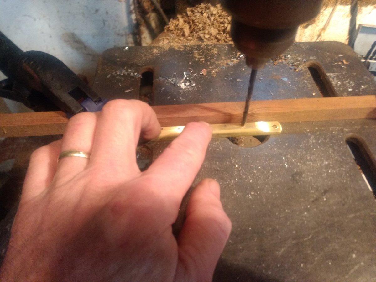

    so I took a piece of bronze half-round rubrail:
    Did a little cutting and sanding and drilling and tapping:
    It mounts on the firewall. I think it will be protected enough. I'll run a feed from the starter post with an inline fuse holder to the bottom terminal, then feed into the dash from the other ones and run them up the steering column. When I get a minute. I'm just going to run the one fuse, like a lot of the Model T guys do. If I'd had sense enough to do that in the first place, I wouldn't be in this fix.
    I probably don't need that many spots on that block, but extra won't hurt. Thank you for looking.

    I see wood piece under br*** but are screws going into metal firewall? I also need small wire/fuse holder so watching this part closely

    Nah, the firewall is wood. The other piece will eventually be glued on just so the screws have a little more bury. I would like to eventually build an old-timey metal clip style fuse holder into it, but for now I'll just run one of those plastic inline doohickeys.

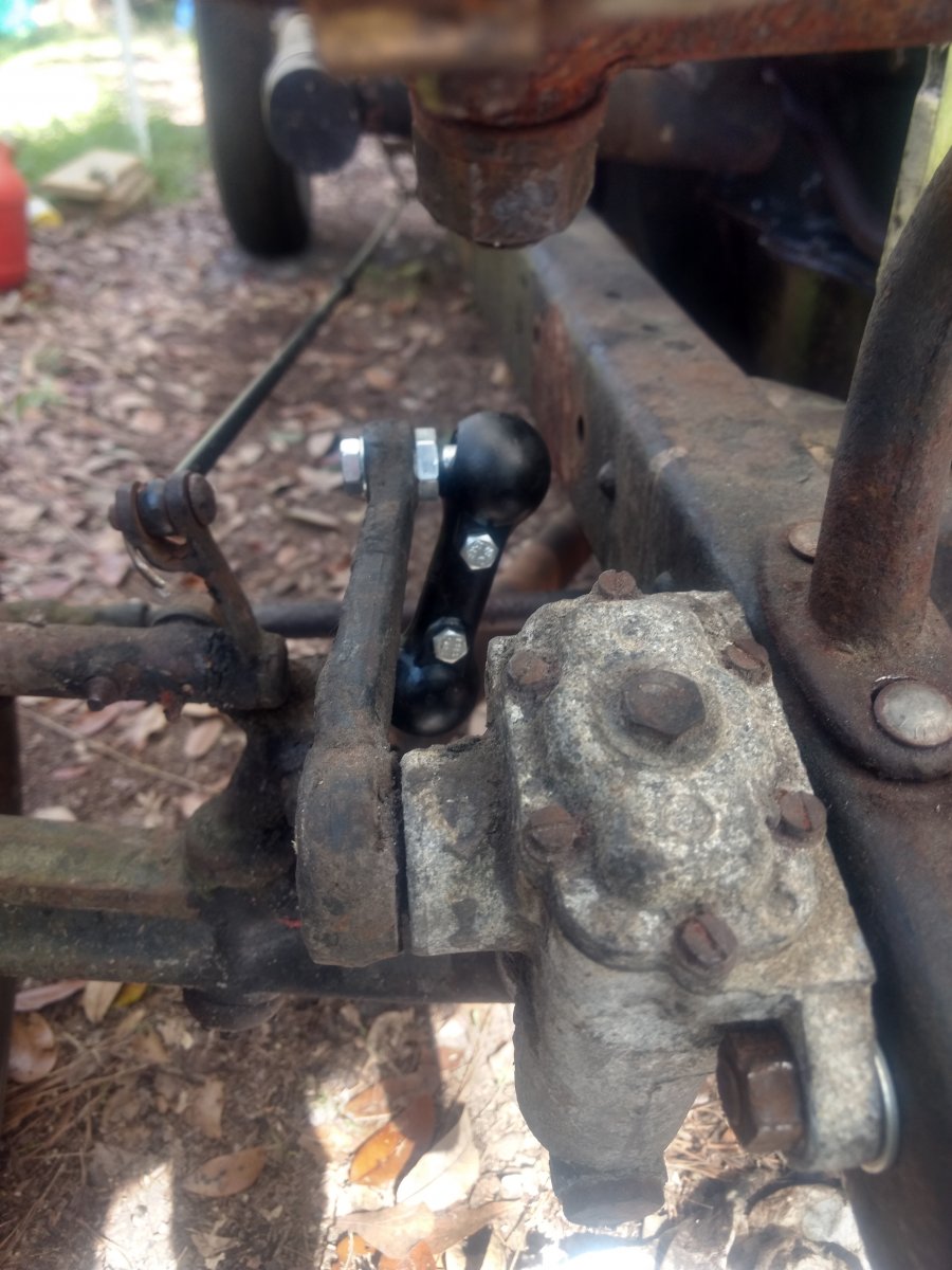

    Well, not much has been happening with the speedster, but I did get the shock parts in and got the rear shocks mounted. This is what my hickory wedges looked like after a couple of days in the old oil:
    Sorry it's such a terrible picture. I think my ancient phone (ancient for these modern times, about 1/20th the age of the car I'm working on) is on it's last legs. Anyway, they dripped dry over the next couple of days, and turned out pretty nice, if I do say so myself. Remember, one wedge on each side of the frame, opposing each other. Real solid, right now. Some road time will tell the tale.
    Don't those new dogbones and that shiny hardware just jump out at you? I'm sure time and miles will blend them in. I hope everybody is healthy and well.

  18. Had a blast reading through you thread. I was interested to see how you incorporated the MG shocks and you nailed it. As you say they dont have the asthetics of friction shocks but will definetley work better and they look functional and cool. Such a sweet build all round. Well done!
    On a side note I was pretty impressed in some of the small details like the leather case in the ****pit, and that engine turned dash! Details I must keep in mind.

    Flat44, it didn't. Hahaha. Just a leftover. Josh, thank you. I like them fine, and, even though I wish they were older, the basic design certainly fits my timeframe.
    97, that's an intriguing possibility. I did find time for a quick blast this morning, and the wood and shocks stayed tight. I got up close to 70 mph, no more wheel hop, not too wiggly. Granted it was only about 10 miles on paved roads, but I'm encouraged. We'll see, I guess.
