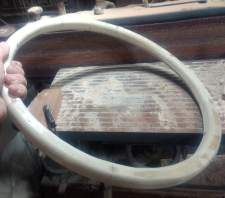

    Got a little more done on the steering wheel this morning. I'm really missing my weekend drives, but progress on the car is the****utic. This wil be kind of picture heavy, so if you're not interested in wood-working...
    First, I un-clamped the two rims and temporarily clamped them back together with the joints staggered, then marked them so I could cut the points off. Made them roughly 16 sided.
    Then, I temporarily screwed them together and slapped together a little jig so I could find the center and mark the outside rim:
    Took that to the edge sander and carefully sanded down to the line:
    Marked the inner edge from the outside using a shop-made adjustable doohickey:
    Broke out the jigsaw and cut carefully (The trash can was just the right size to let me prop up the wheel and still have space under the blade):
    Then I was here:

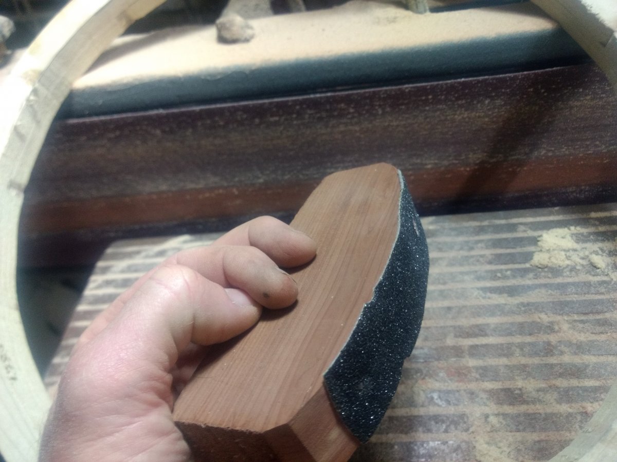

    That cut was pretty imprecise, despite my care, so I made this rig to smooth out the inner edge:
    I got on a roll and forgot to take pictures of the next few steps, but they were pretty straightforward. I clamped my router upside down with a 1/4 round bit in it, one of those jobs with the roller bearing on the tip, and took off all four edges. Then clamped the wheel in the vise and smoothed all the router woopties out with a long strip of sandpaper, kind of the same action as those ****-wiggling strap machines they used to sell back in the 60's. (Skip to 1:15 on this video for the action shot. Hahaha)
    Anyway, I eventually ended up with this:

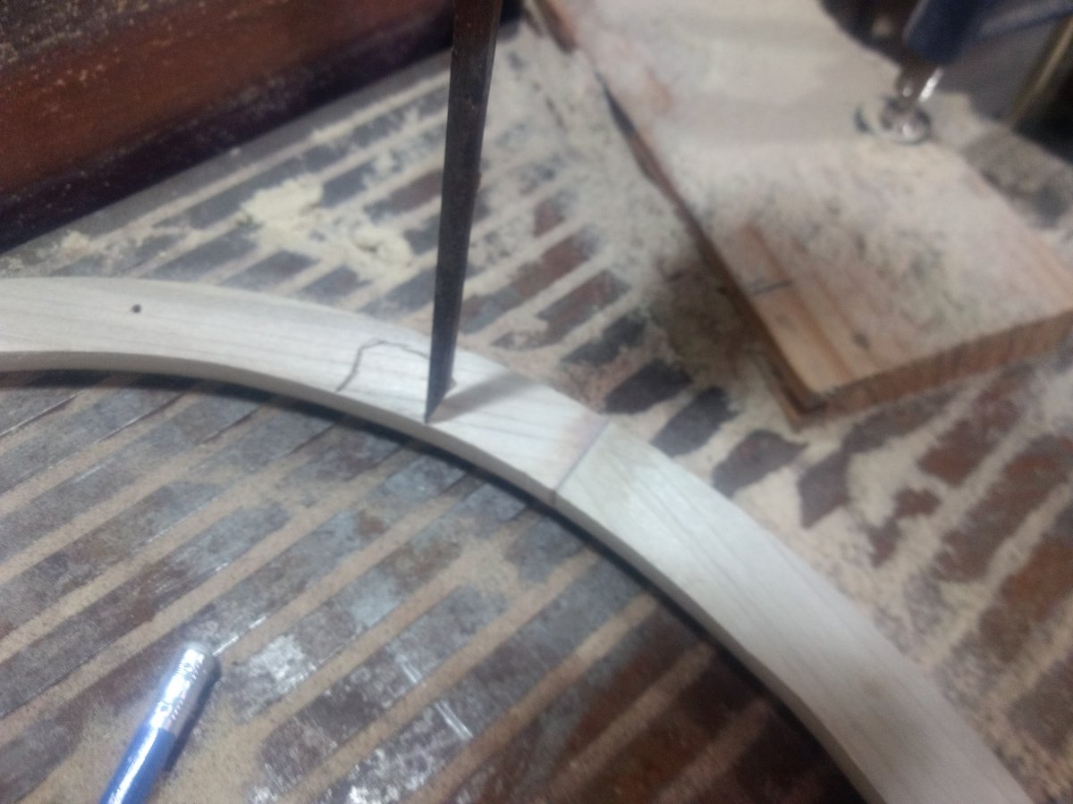

    Dammit. Hit "post reply" instead of "upload a file". Where were we? Cutting the mortise:
    Did that 7 more times (4 on each rim, each half as deep as the spokes are thick), then glued, screwed, and clamped it up:
    Of course, me being me, there was a little drama involved, but I'll go into that when I post how I fixed it. Hahaha. Everybody be safe.

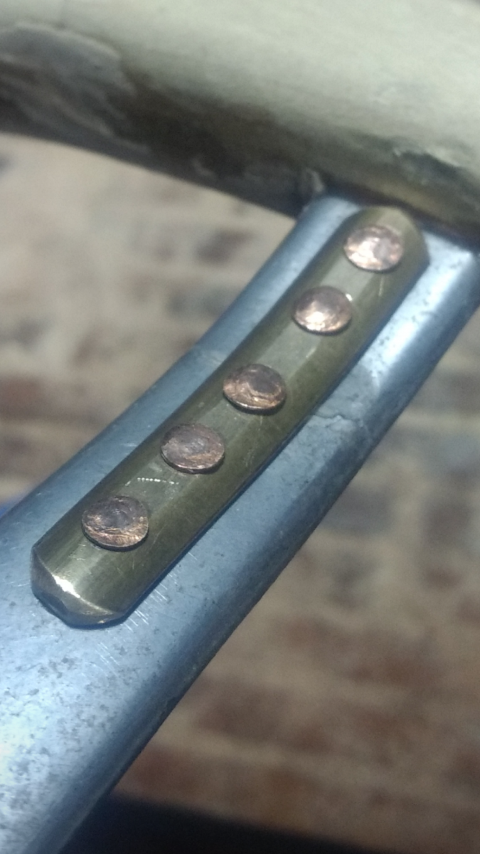

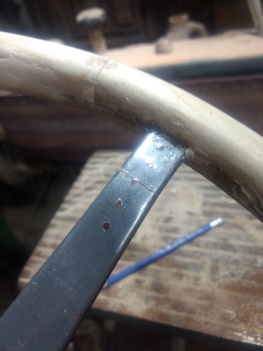

    Thank you, all. I don't have any idea where it came from. I got it cheap because the really thick original wooden rim was broken. I had to cut it off, and discovered that whatever trauma broke it had bent one of the spokes a bit. "No problem" I said to myself. "I'll just ease it back into line cold". Didn't work. I had it just about there, decided to tweak it one more time and "pop", the ear broke. That's the drama I alluded to a couple of posts ago. I've just had it glued together temporarily while I made the new rim. I have some of those miracle aluminum welding rods, but I haven't fooled with them much and don't trust myself not to ruin the whole rim. Plus, they didn't have those things back then, anyway. This morning I set out to repair it in a way that fits in with the spirit of this whole deal. Here's the break:
    So I bent this little piece of bronze and drilled it:
    Then held it up to the wheel and drilled the arm, then just riveted it on. Again, I would never used dissimilar metals like this in a boat, but I'm not too worried about electrolysis on this project.
    Obviously, I put the bulky stuff on the back. All you see from the front is a hairline crack and those little dots, which will lose their shine pretty soon. I think it's strong enough, and I'm happy with it. I have some more sanding to do, then I'll paint the rim black and see about putting it on the car. My little bronze shaft extension will have to be shortened and have a bigger tapered nose. All in good time. Stay well.
