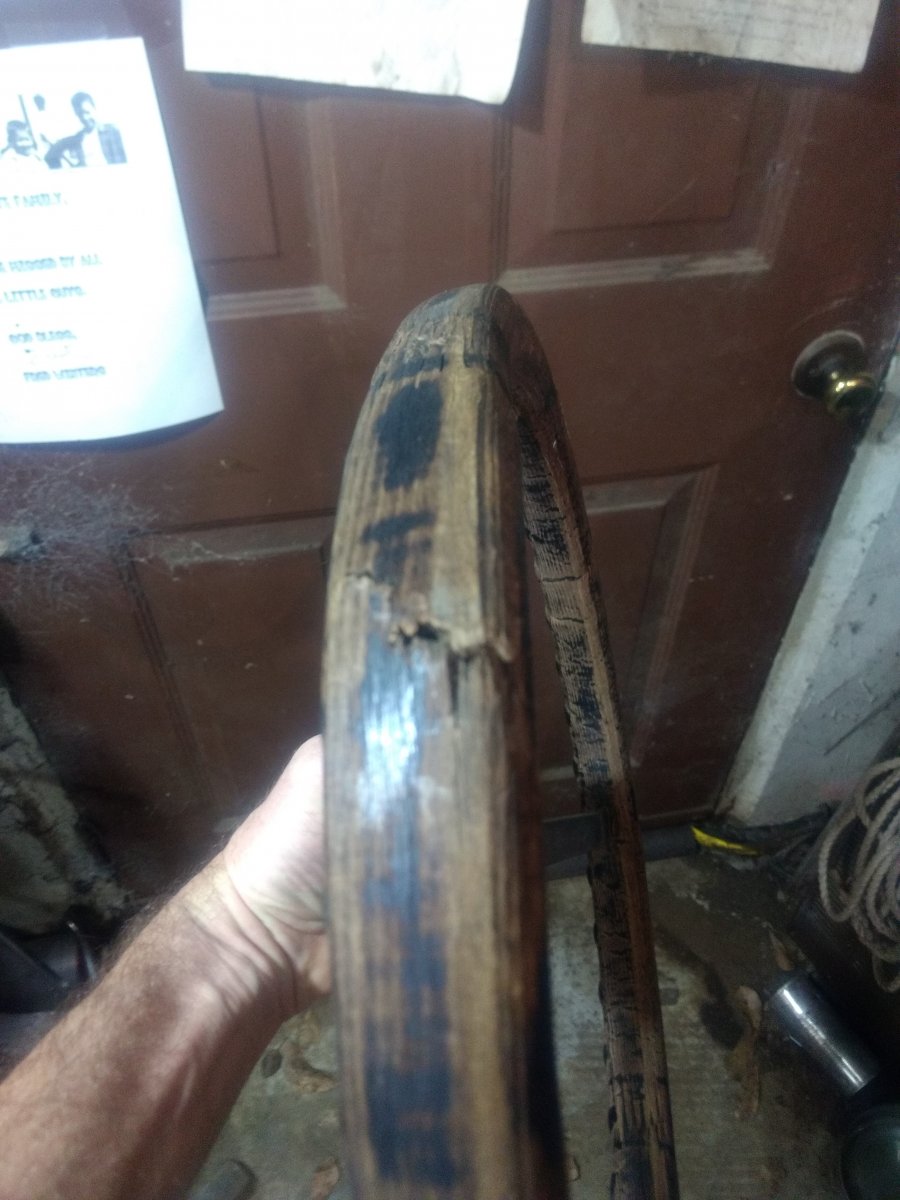

    Thank you for the compliments. I finished the wheel. I'll start with the only picture I have of how it was when I got it:
    Doesn't show real well, but that rim was not only busted, but the fibers had separated so that it was significantly fatter there, plus the arm was bent, and the rim was too clunky and fat, anyway.

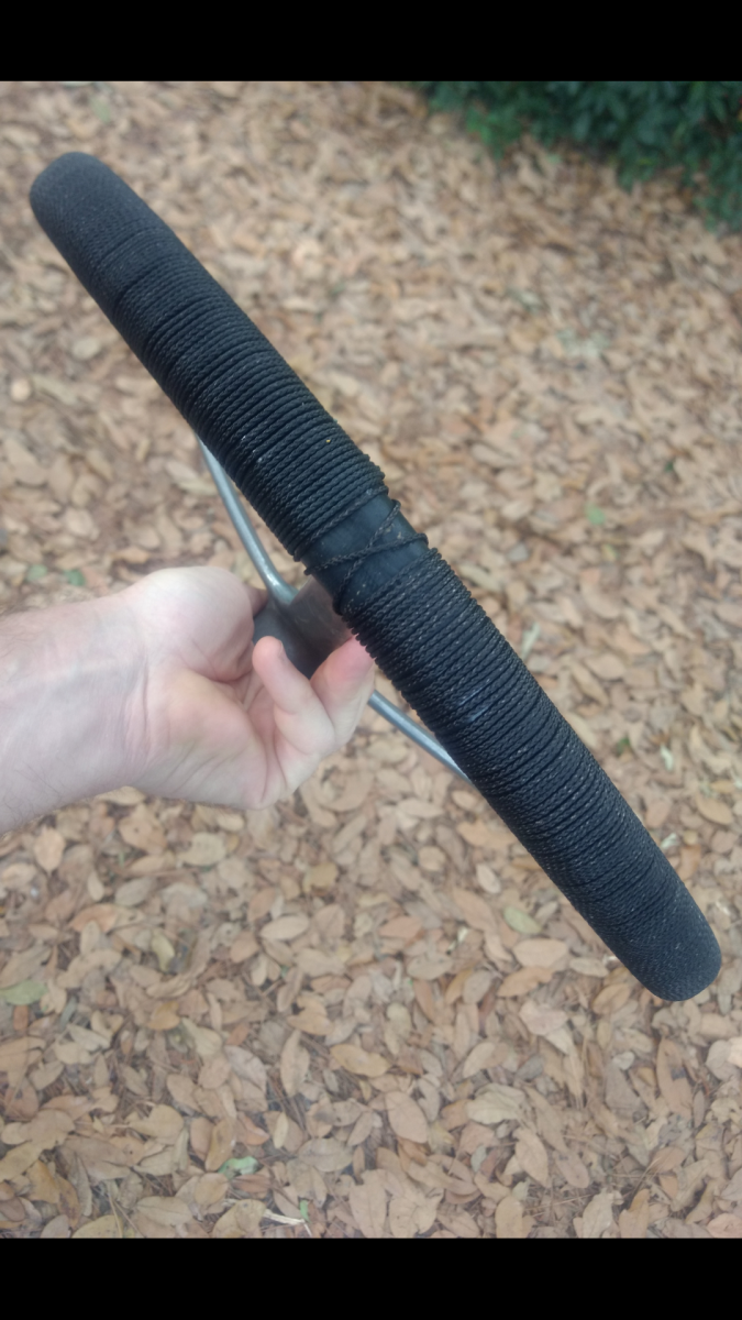

    So, here it is after final sanding, coated with epoxy just to seal it. I didn't go overboard with the sanding, it's still a little square. It was getting pretty thin feeling. If I had it to do over again, I'd cut the original pieces a little larger. (@Stogy had a point about that).
    Now with a couple of coats of black Rustoleum brushed on:
    It's flat paint, just still a little wet in that picture. I wrapped the wheel with bank twine, which is a braided nylon that's been tarred with some petroleum product for weather resistance. Used in making nets and crab traps and such. Really tough stuff. That's one continuous length of it, and was a tedious process, to say the least.
    It'll do. The twine brought the rim back up to a real comfortable thickness. Looks better in the pictures than in real life, but, then again, so does the whole car. Haha.

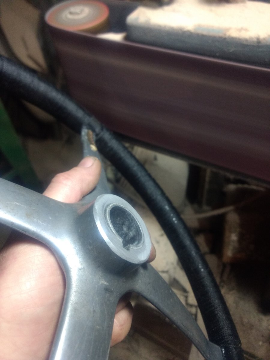

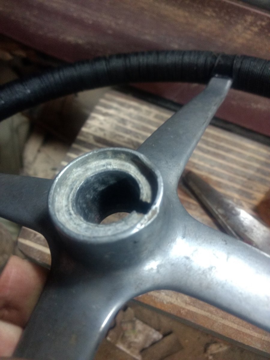

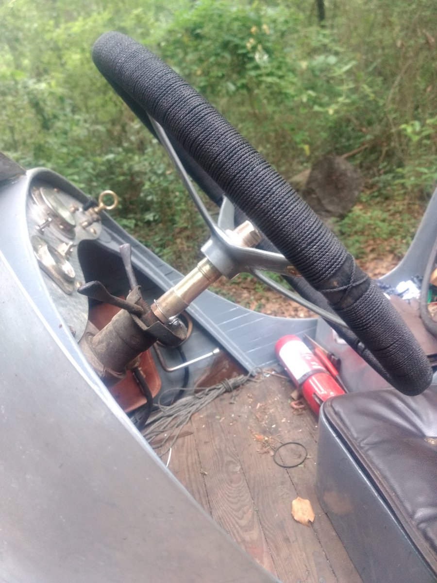

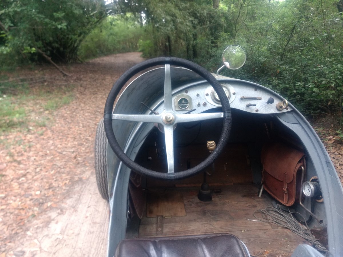

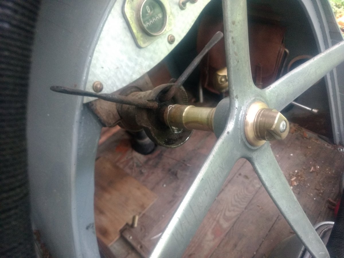

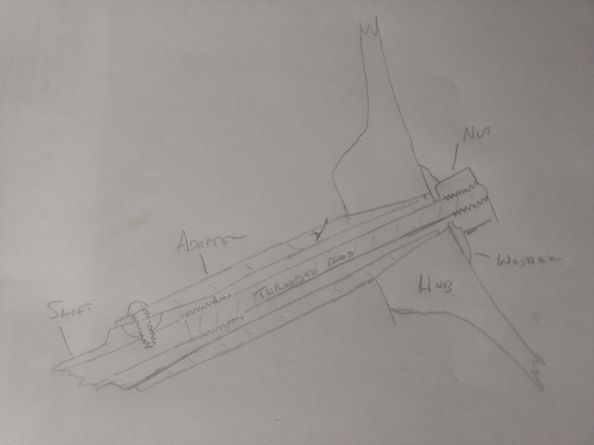

    I finished up with the steering wheel project last night and this morning. The hole in this wheel is larger than the old one, and the spokes have a curvature that moves the hub forward, where the other one was flat. I had to shorten and re-taper my bronze adapter and make a bronze washer because the nut was now barely larger than the hole in the new wheel, and I wasn't comfortable with it. I also re-drilled the hole on the column end of the adapter in hopes that I could get the spokes lined up. I'm using a set screw instead of the old woodruff key, didn't have enough meat in the big end of the tapered hole to cut a groove for the key. I have that screw safety wired through the slot. It's a little dodgy, but the old wheel was the same way, and I never had an issue with it. The way I have it with the rod threaded into the steering shaft on one end and the nut pinching it from the other, those tapers get pulled tight. I had a hell of a time getting the bronze adapter off of the shaft. I know it's hard to picture how this whole mess works. I drew a quick picture:
    I also wasn't happy with the back side of the hub. It had a flange that obviously fit over some part of it's original column, but it was dented, and I didn't need it. Off to the shade tree milling machine (edge sander and eyeball)
    Anyway, here are a few pictures of the finished (?) product:
