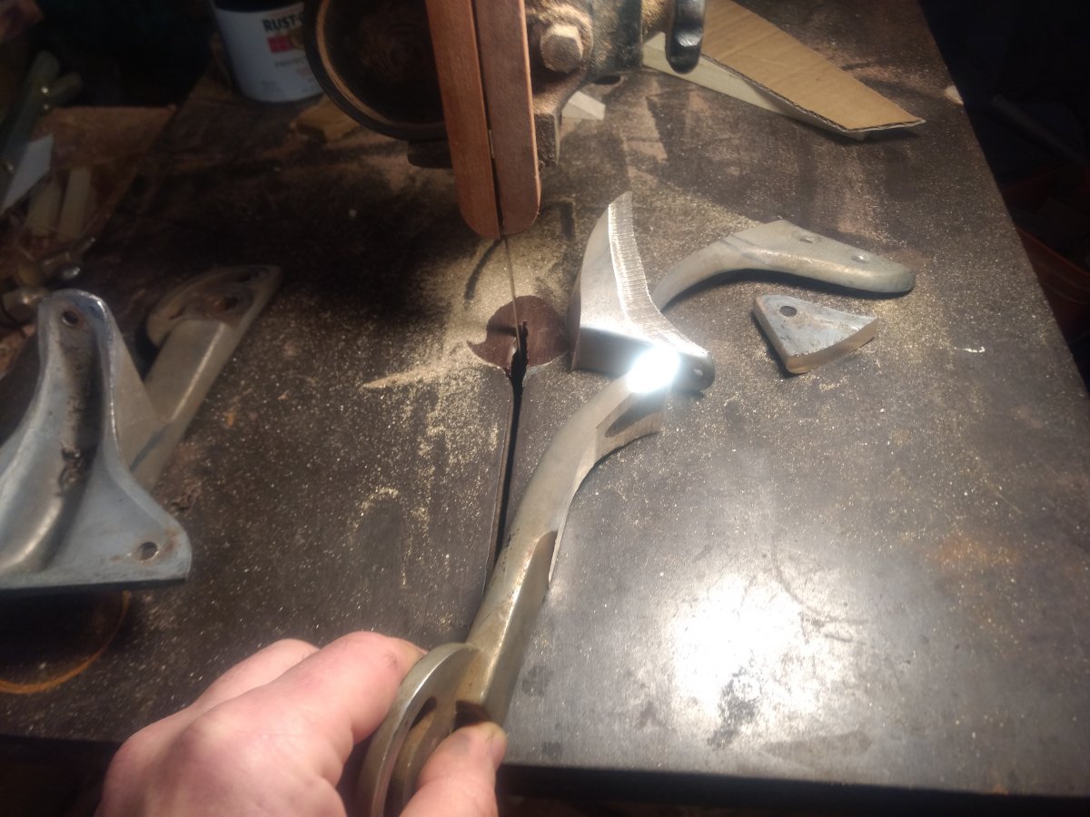

    I won't try to respond to all of you, but I appreciate the comments. I'm a law-abiding citizen, and have a strong respect for the men and women who enforce the law. I don't resent having to put a windshield on at all, and I'm hoping I can find a truck rear window or something else flat that I can cut the gl*** out of. I have read what @Lloyd's paint & gl*** had to say (thank you for that) and I'm pretty confident I can figure it out.
    I pondered this business last night instead of sleeping, at least for a while, and this morning I found a little time to work on the windshield support brackets. They just weren't going to fit, so I decided on some major surgery. (Looked on Ebay first, saw that I could replace them for about $75 if I ever get around to doing something with the MG). My inspiration is a 1930 Frazer Nash Super Sports, plus any number of other depression-era sports cars. You'll have to google it, I didn't want to steal somebody's image. Anyway, the brackets are cast br***, so I threw the metal-cutting blade on our antique bandsaw and started cutting away the ugly:
    You can see the other bracket in stock configuration on the left. Then to the edge sander to smooth them up:
    I din't take a picture of this, but I cut a s**** piece of wood with square ends and clamped the brackets on them so I could re-mark the plywood pattern. If the hinges are out of square or out of plumb, the folding action won't work. Then trotted it out to the car to see what I had:
    Like I said, I'll cut a piece of wood to fit under the gl*** (plywood) and between the brackets. It will be pretty substantial, because I'll have to drill those brackets and screw them to it. The wood filler will in turn be glued and screwed to the body.

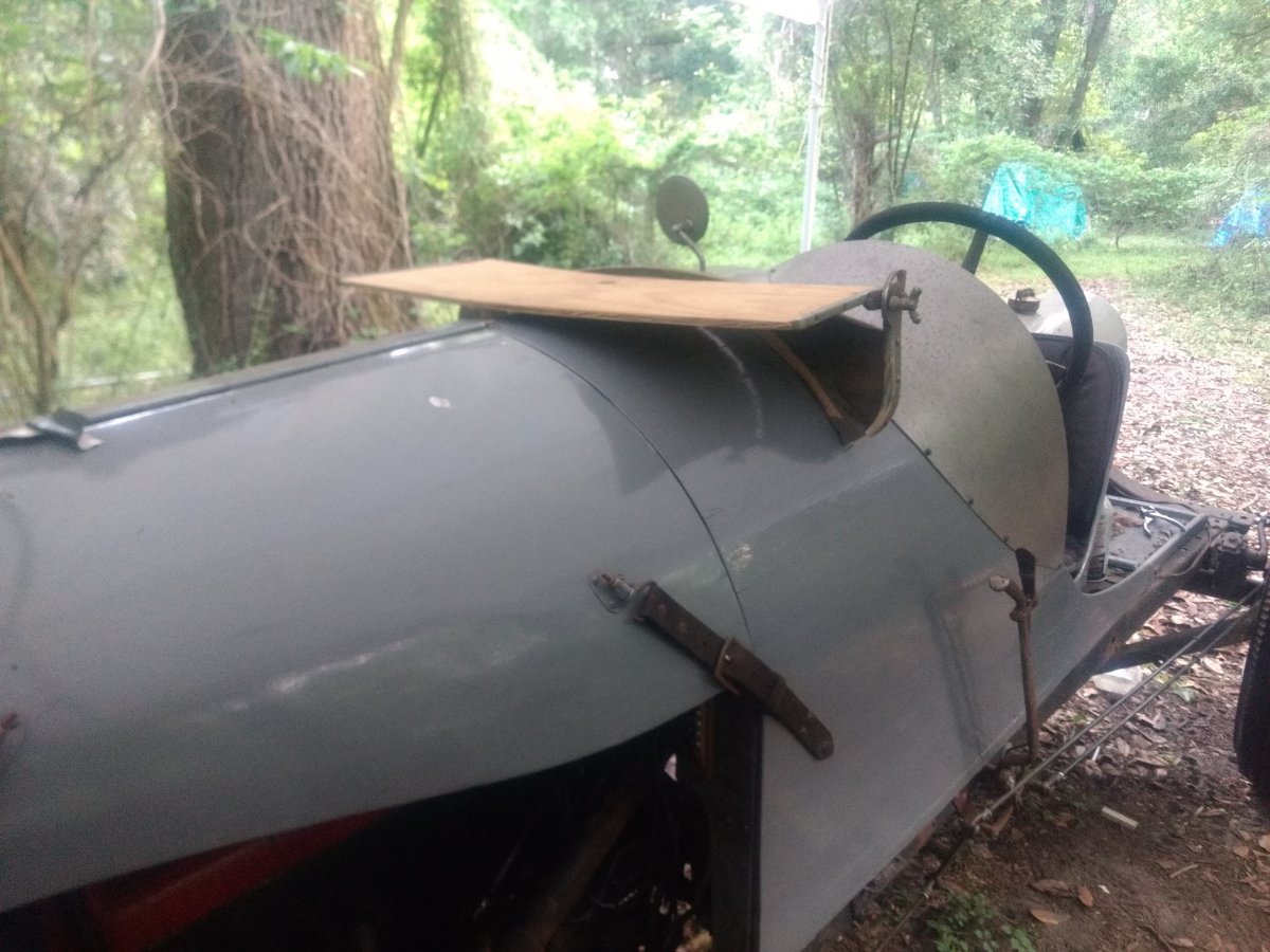

    I agree, but I don't know how many 8 hour drives I'll be taking in this heap. Hahaha. This is a windy ride, though. I think I mentioned a while back that I can't even hear the engine at speed, just wind wind wind.
    I got the wooden filler piece marked and cut out yesterday evening, and the brackets drilled and countersunk for screws. It was ticklish business for me, has to hold the brackets at the right angle to allow the folding to work, then has to be beveled on the bottom to fit the car with the windshield at the proper rake. Lots of trial and error, but I got it. I made it as thin as I could over the hump of the body, but discovered when I mocked it up that the gl*** would be riding on the top of the body when it was folded, so I added a stip to the bottom to raise it up a bit. If that description is confusing, you can see it in the picture. The main piece is Tulip Poplar, kind of dark, and the piece I added is Atlantic White Cedar, real light colored. I stole an old trick of cutting halfway through the Cedar piece at about 1/4" intervals so it would take the bend, then glued it to the main piece. Sanded it all down this morning and fitted it up again. Just right.
    I was satisfied with that, so I measured and marked the right spot, got a 4-in-hand rasp and took the paint off of my glue line, mixed up a batch of epoxy thickened with colloidal silica (this is all WEST System stuff for boatbuilders), and glued it down.
    The little nail you can see in the bottom of the 1st picture is just temporary. I put one at each end and one in the middle so I could get it all lined up again after I rasped the pencil lines off. I'll close this out with a view from the driver's seat, complete with Stogy's owl. Hope you and yours are all OK.
