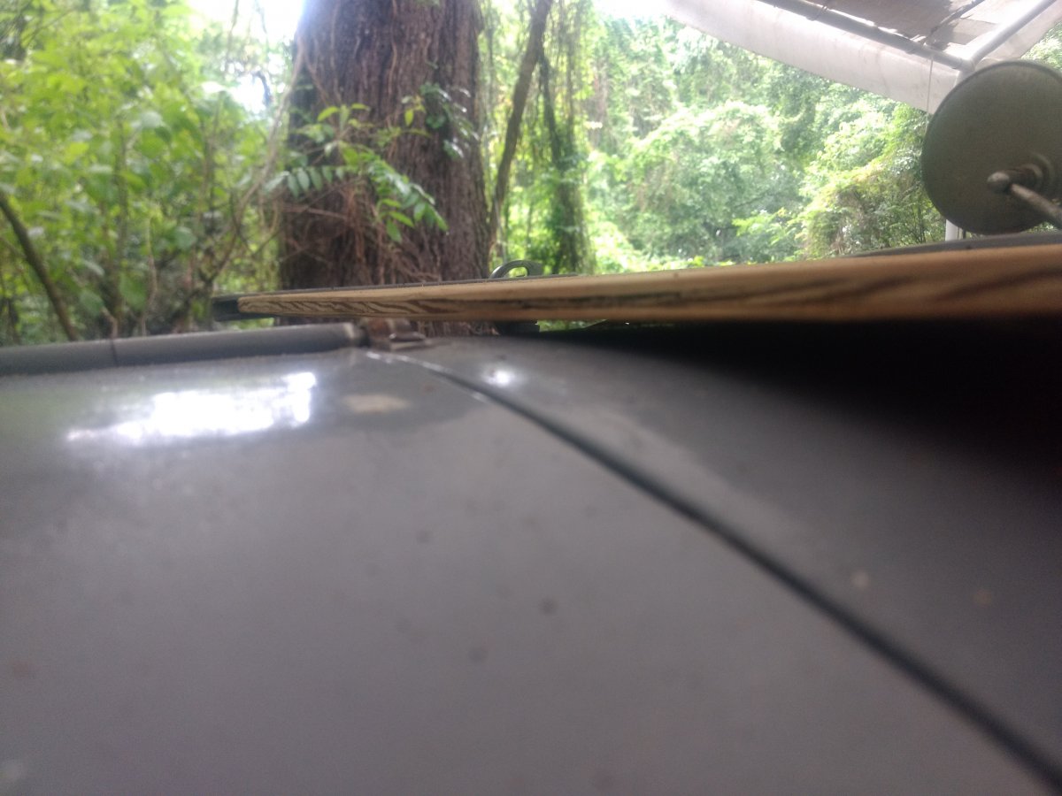

    Either way, I need to be able to hold the windshield to the frame. I grooved a couple of pieces of Tulip Poplar:
    Marked and trimmed:
    Glued and screwed:
    I cleaned and roughed up the metal parts and spray-bombed the whole business with a little sandable primer:

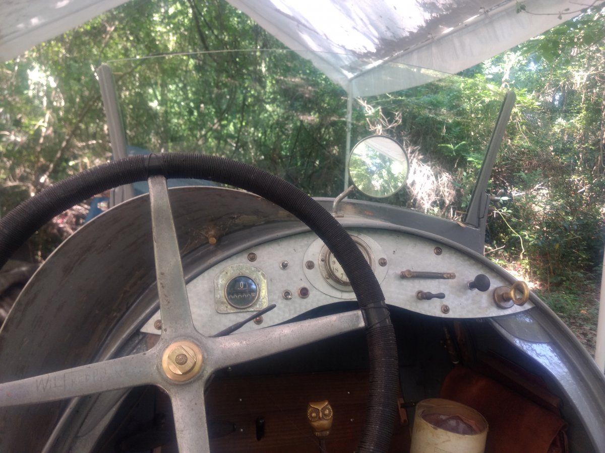

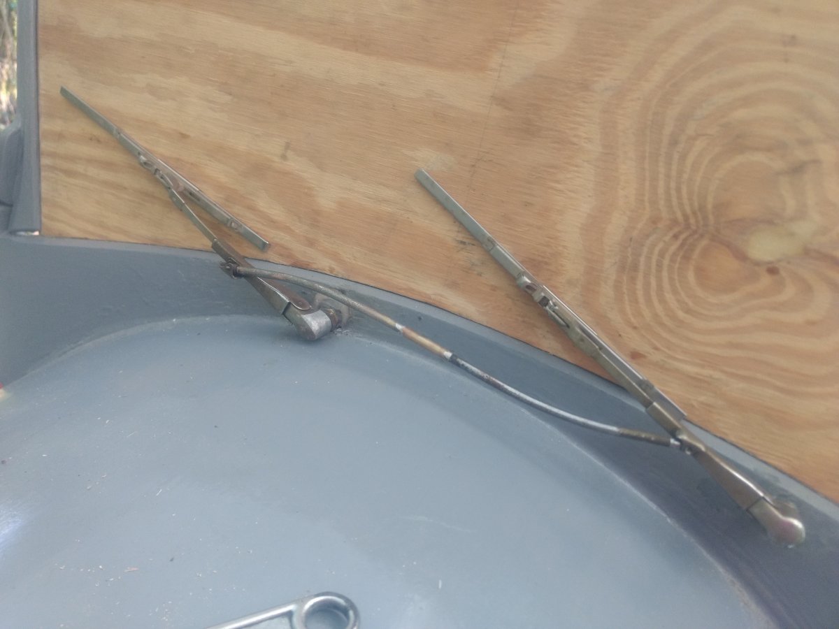

    Well, this represents quite a few evenings and early mornings of piddling. The Georgia law requires a windshield made of safety gl*** (which I'm still working on), and wipers that are operated by the driver. I'm in serious danger of getting too cute here, (as a matter of principle, I don't like things that are over accessorized) but in the interest of legality, here goes.

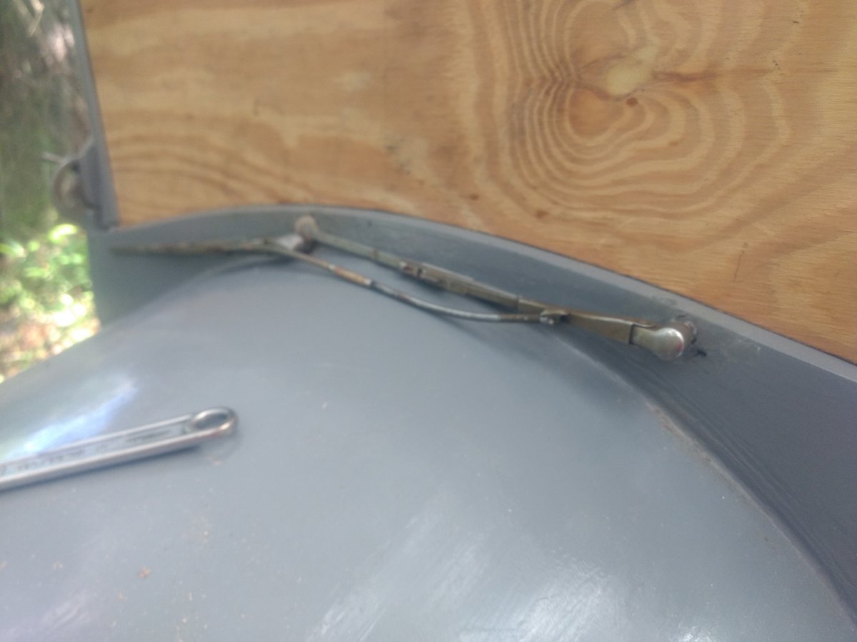

    The MG TD has really slick little wipers. They mount to the top frame of the windshield, along with their kind of clunky motor. I'm not interested in the motor, and I won't have a top frame on my windshield, so I decided to put them at the bottom:

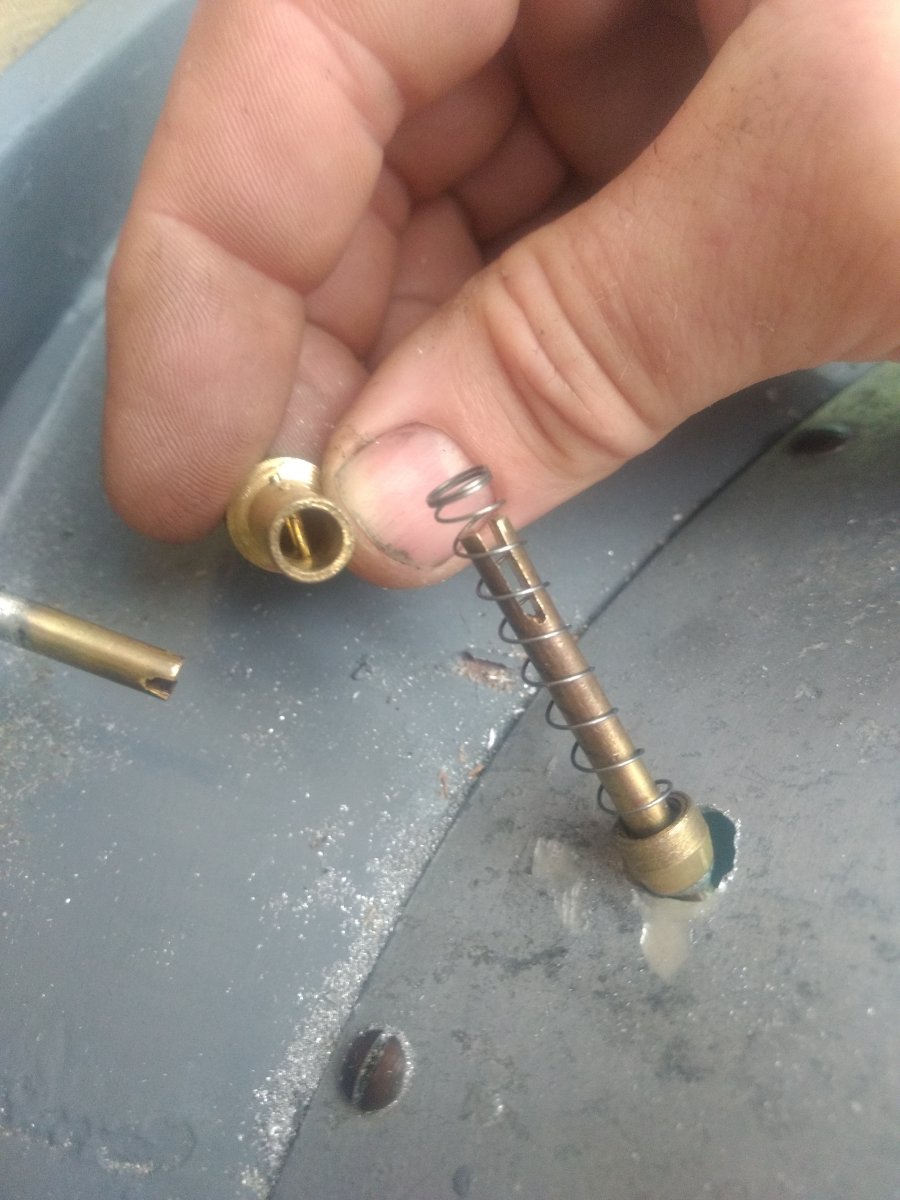

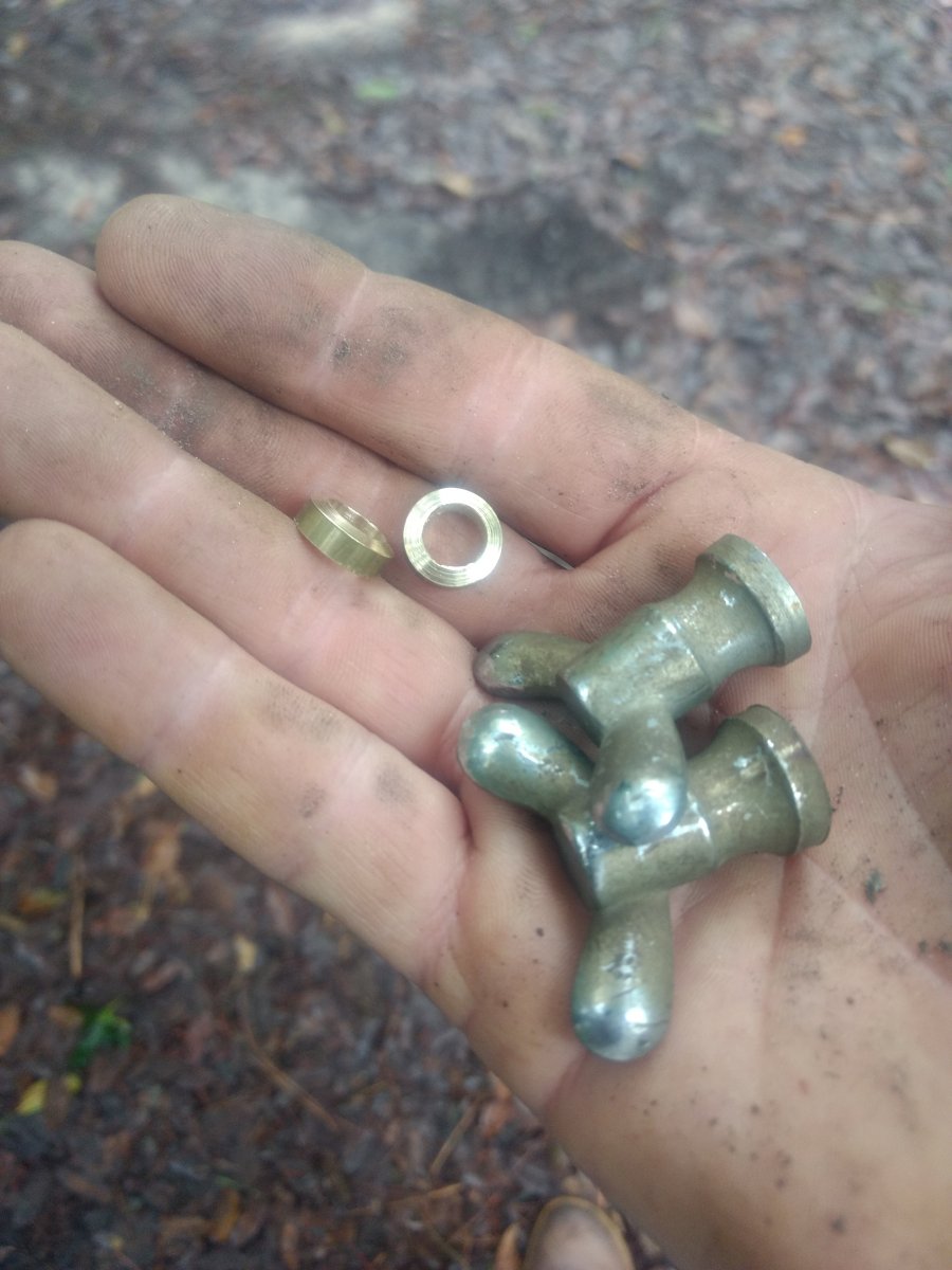

    I drilled and tapped these little bronze doohickeys to glue in those holes and accept the threaded bushings the wiper shafts run in.
    It was a mess of trial and error to get these things positioned so that they would do their job and still let the windshield fold. After I glued the bronze sockets in, I realized that the p***enger side wiper was too high, and the windshield hit it before it got folded all the way down. Had to hole saw it out, rasp the hole lower, and glue it back in. Still hit, so I reduced the top part of those bushings (that the wrench grabs) as far as I could. Compare to the first picture. It was still just the tiniest bit too high, so I did a little cosmetic surgery on the wiper arm itself with the edge sander.
    You can see I had to bend, shorten, and splice the connecting rod to allow everything to work. It was originally straight, but the little receivers on the wiper arms wouldn't allow me to drop them down onto the frame, so I had to put those opposing bends in. Here they are at rest ready to fold, and up ready to wipe:
    Again, I'm sorry for the blurry pictures. I'll eventually replace this phone, but it's not a priority right now.
    Next, I had to figure out a connection to the actuator handle I was planning. The problem was that I needed it to be able to disconnect so I could park the wipers on the frame. I came up with this mess. The little collar has two cross-pins that ride in those slots. The long slot lets me pull it back far enough to disengage the wiper arm, but keep it captive in the collar. The spring applies enough pressure to keep it all together. It's a little wobbly, on purpose, so I didn't have to worry about lining it all up too perfectly, it acts as a tiny U-joint. It'll make more sense in the video. The windshield is to the left, my little aluminum cowl is to the right.
    I turned a bronze socket for the right hand side of that mess to rest in, carefully wallowed out the hole in the aluminum with a chainsaw file, and glued the socket into the cowl with thickened epoxy. I was going to make a little soldered on collar for it and screw it to the aluminum, to be era-correct, but I was getting a little tired of fooling with it and took the easy, modern approach. Maybe one day I'll fix it right. Slapped together a handle and called it a day. Here's a video of all of it:
    It gets a little wonky towards the end because I have to hold the little collar back with one hand while I park the wipers with the other. Sorry again for the ****py video quality. Best of luck to all.

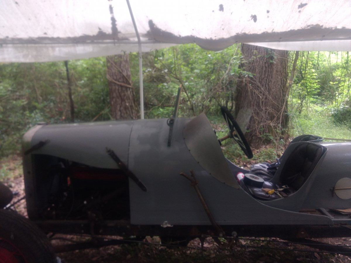

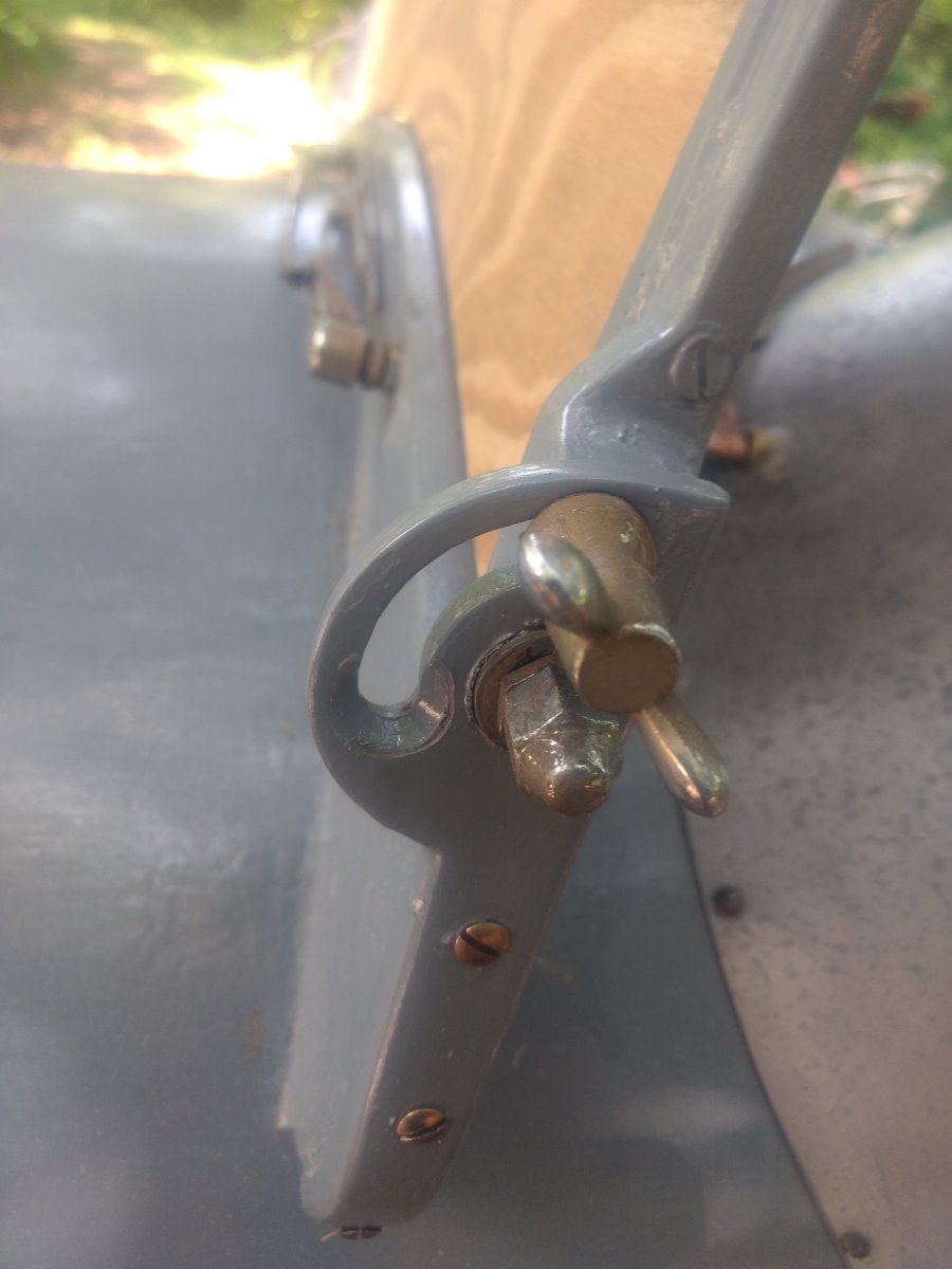

    This isn't very dramatic, but I fixed those wing-nuts so that they would hold the windshield right. Pretty simple stuff, but I didn't have a lot of time this morning, so this job was a good fit. I think the pictures tell the story.
    You can see that gap of around 1/4". It looks like it's sitting on my hood rod clamp, but that's just the angle. I'm not sure if it's going to hit the body or not. The windshield arms are held pretty solidly by this arrangement, but I'll probably put some kind of temporary padding under it until I figure that out.

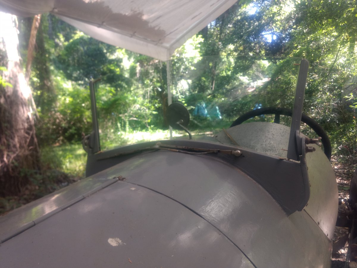

    Well, I got a used Suzuki Samurai windshield and tried my hand at gl*** cutting. The good news is that I have a windshield, the bad news is that I screwed up my first time cutting the bottom curve and had to move the pattern up the windshield a couple of inches and try again. I was successful that time, but I couldn't avoid the little modern black writing in the corner. It kind of has the wrong vibe. Add to that, it's even upside down. Hahaha. I'll keep my eyes open for another flat windshield and redo it, one of these days, maybe. Anyway, I bedded the gl*** with some gooey black stuff, letting it dry. Hopefully I can get a little drive in tomorrow morning. Our lockdown in GA has expired, so discretionary travel is OK again.
    I'm hoping it will be strong enough without any framing on the top and bottom. If it breaks, at least I'll be able to do something about that writing. Hahaha.

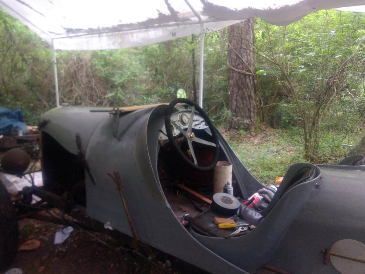

    Good ideas. I didn’t get to go for a drive this morning, but I at least got to pull around to my little picture spot so I could step back and get some perspective. I think it looks a little Chitty Chitty Bang Bang in the up positionbut I can get used to it. Folded down I really like it. A lot less obtrusive with gl*** than with plywood. Video:
