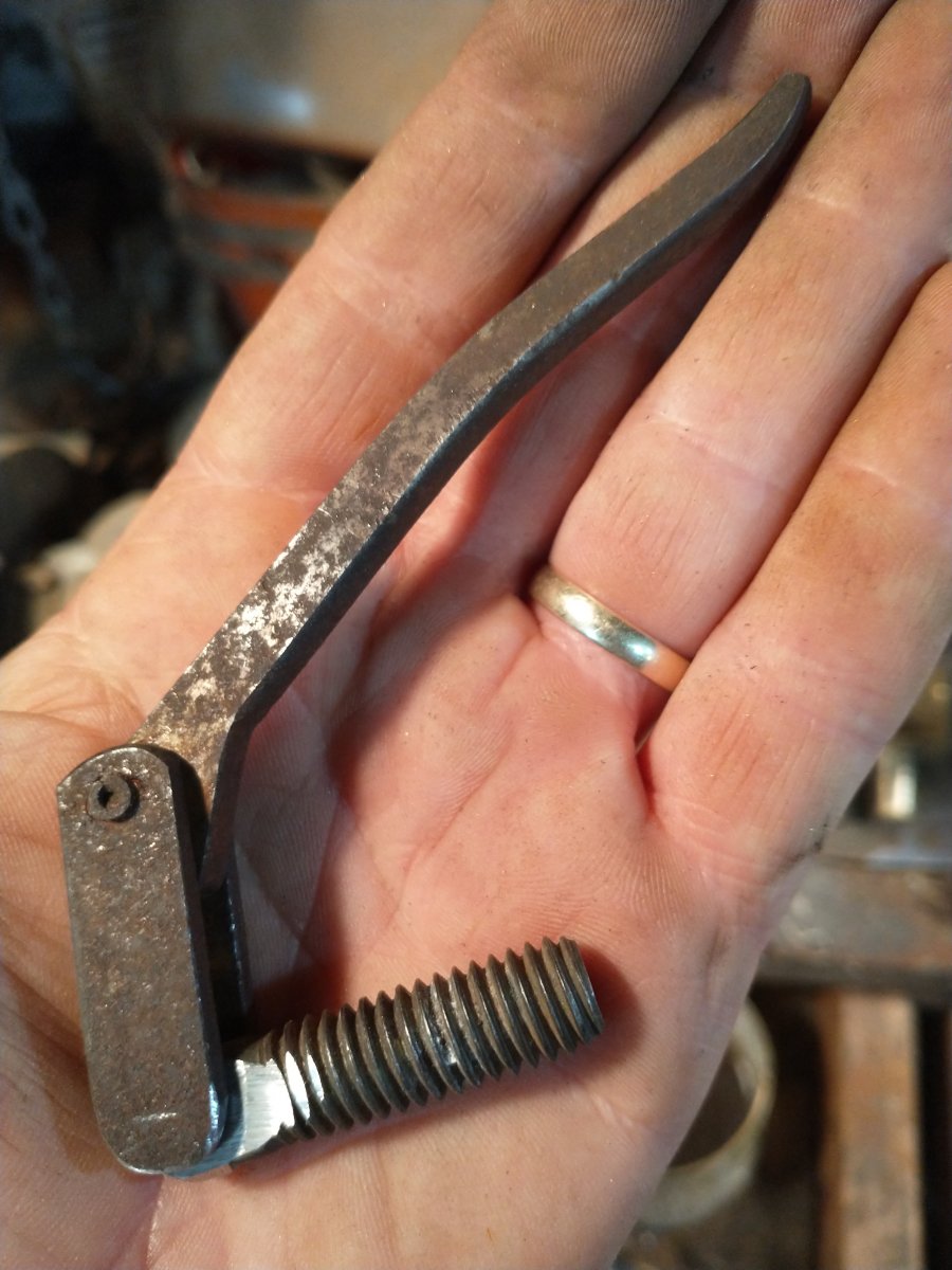

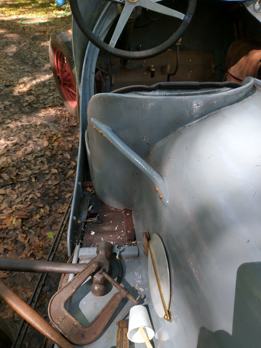

    Well, so much for not updating this thread any more. I have been pooting around in this thing quite a bit, and recently rode along with one of my daughters driving.
    You can see how much fun we were having. Being a p***enger is a completely different experience, though. The little handle on the dash is nice, but on a left turn, it doesn't really help much. I decided to add one more handle, which also serves to brace the driver's seatback. The edge has a tendency to flex a bit when I'm hopping (climbing?) in and out. Hasn't busted again since I added that reed edging a couple of pages back, but...
    Anyway, this is about as iffy as anything I've done on this rig, but I just used a length of solder to outline the angle of the seatback to the little tail extension
    See that aluminum boat handle in the bottom right corner of the photo? My first thought was to just bend it to fit, but that didn't work. Oh well, I'm better with wood, anyway. I staggered around my junkpiles with that wire template until I found a cut-off limb (Privet, I think, leftover from s**** carving or walking stick making or something like that) that fit in that angle.
    A little sawing and carving and sanding, and I have this:
    Sorry about that nasty thumbnail. I lost it changing the u-joints on an off-topic project, just growing it back out. Anyhow, I s****ed the paint off and glued that piece on with my trusty WEST System epoxy. Notice the high tech clamping system. Haha.

    I was worried that in a real panic situation, that epoxy wouldn't hold, so I added some mechanical fasteners. Settled on copper rivets and roves that we have for boats. I reinforced the seat back and inside the rear part with thin strips of bamboo. A little paint and I'm pretty happy with it.
    Here's how it works:

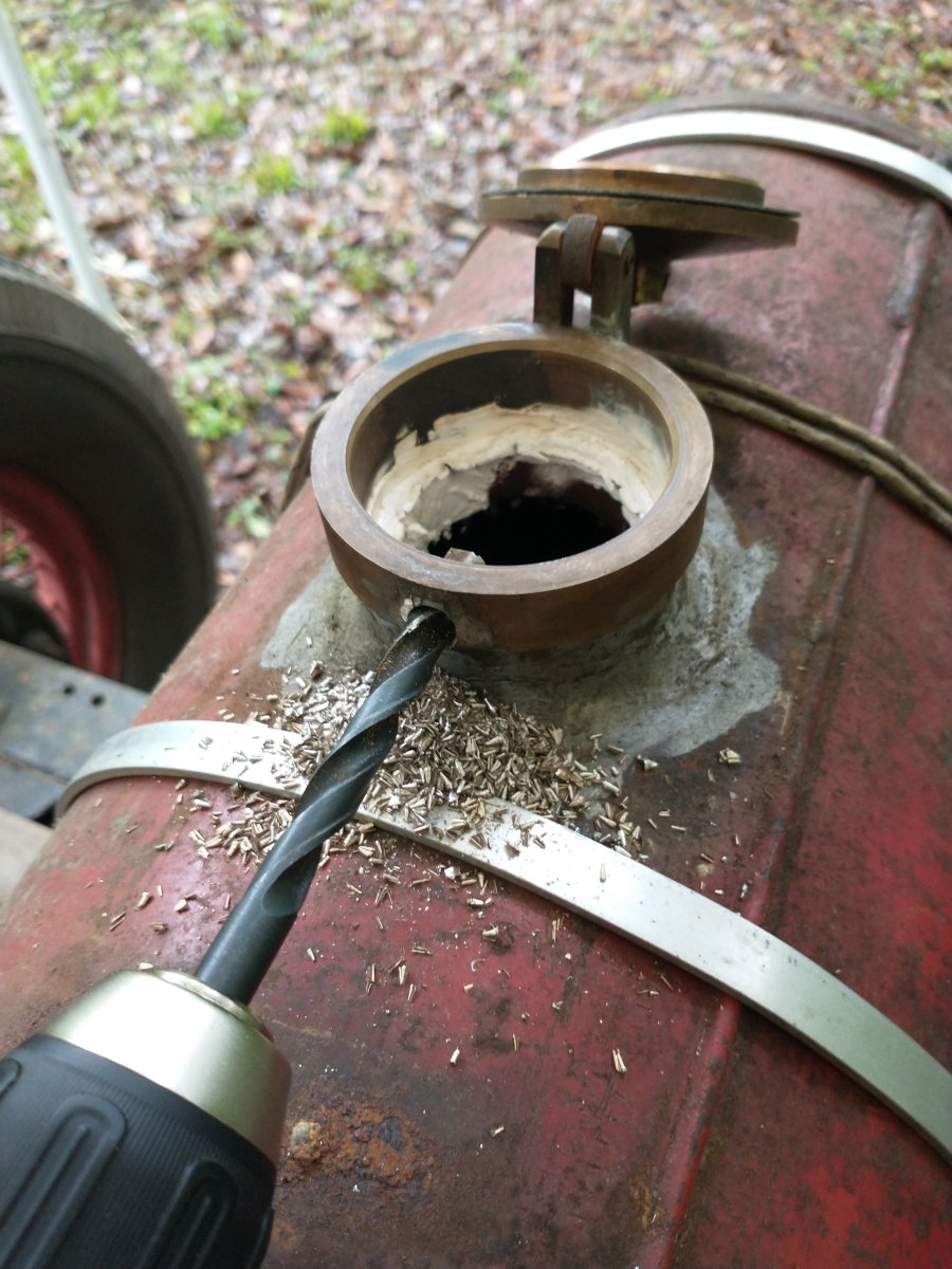

    I also managed to bust the silver-soldered ears off of my fuel cap clamp, so I fixed that the way I should have in the beginning. The other side is still silver-soldered, but I has two ears to take the strain, and, anyway, I busted the front part being stupid, so I think those back ears will do. I think the pictures are self-explanatory.

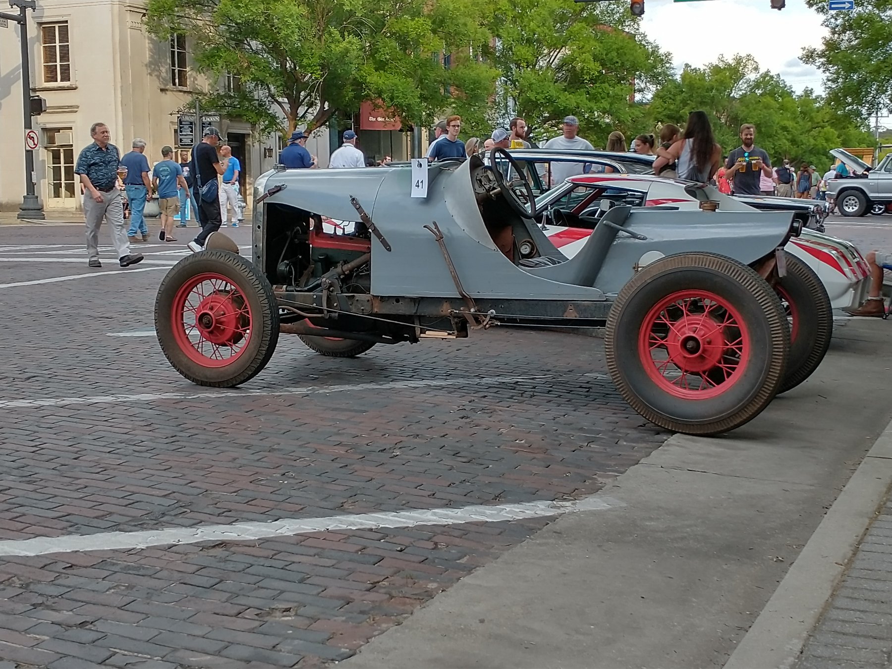

    Well, I just p***ed something of a personal milestone. Our local police department hosts a car show every year as a fundraiser, and I screwed up my gumption enough to enter old Shade Tree. This was my first car show as a participant, and I had no idea what to expect, but I pooted up there and parked as directed on our old brick Broad Street. We have a real nice little town, and they throw a big evening of shopping and what-not on the 1st Friday of every month. We had a big crowd, and there must have been 100 or more cars up there. Mostly muscle cars and modern stuff, but I saw one clean stock A Fordor and a real nice 60's style '32 coupe. I was parked next to an honest-to-God late model Ford GT. Talk about extreme ends of the spectrum. I got a picture of the two of us:
    That extra space is because he had a little trouble backing in. Or maybe he just wanted a little distance between his jewel and my pile. Haha. Honesty compels me to admit that the GT got a good bit more attention than poor old Shade Tree, but a lot of it was from Gen-Xers and former bodybuilders who were trying to simultaneously puff out and **** in. Shade Tree was very fascinating to old people, young kids and, oddly enough, young to middle-aged women.
    Due to my crippling shyness, I stood off to the side and didn't talk to any of those people except for two different friends of mine that wandered by and two other dudes that heard me talking to one of the friends and figured out it was my car. They wanted to know how fast it would go, and how much it was worth. I didn't have a useful answer for either question. I spent most of the afternoon either skulking around the edges or wandering around looking at the other cars. Mine sure was a fish out of water in that crowd. I mean, I washed it, but I didn't spray the tires with any miracle juice or even vacuum out the dead leaves from the tongue-and-groove floorboards. I must have a lot to learn. Haha. The owl gearshift knob was a hit, though. All in all, I guess it was a positive experience. I'm not sure I'll do it again, but at least I gave it a shot. I'll leave you with a couple more pictures:
    And one last one to illustrate one of the weirdest coincidences in recent memory for me. If you've read this thread carefully, you will have noticed that I have used a good many of my late father's ac***ulated parts on this car. He was born on 6/4/1941. This show was on 6/4. Look at the number they gave me. Damn.
    Oh well. Good night, all.

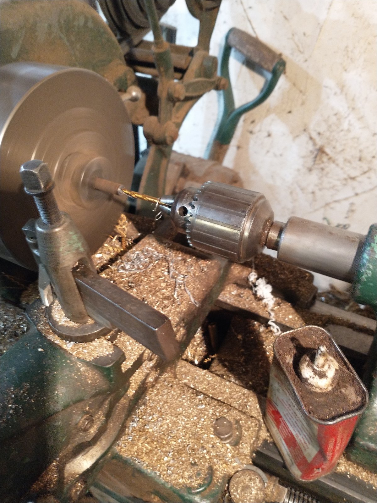

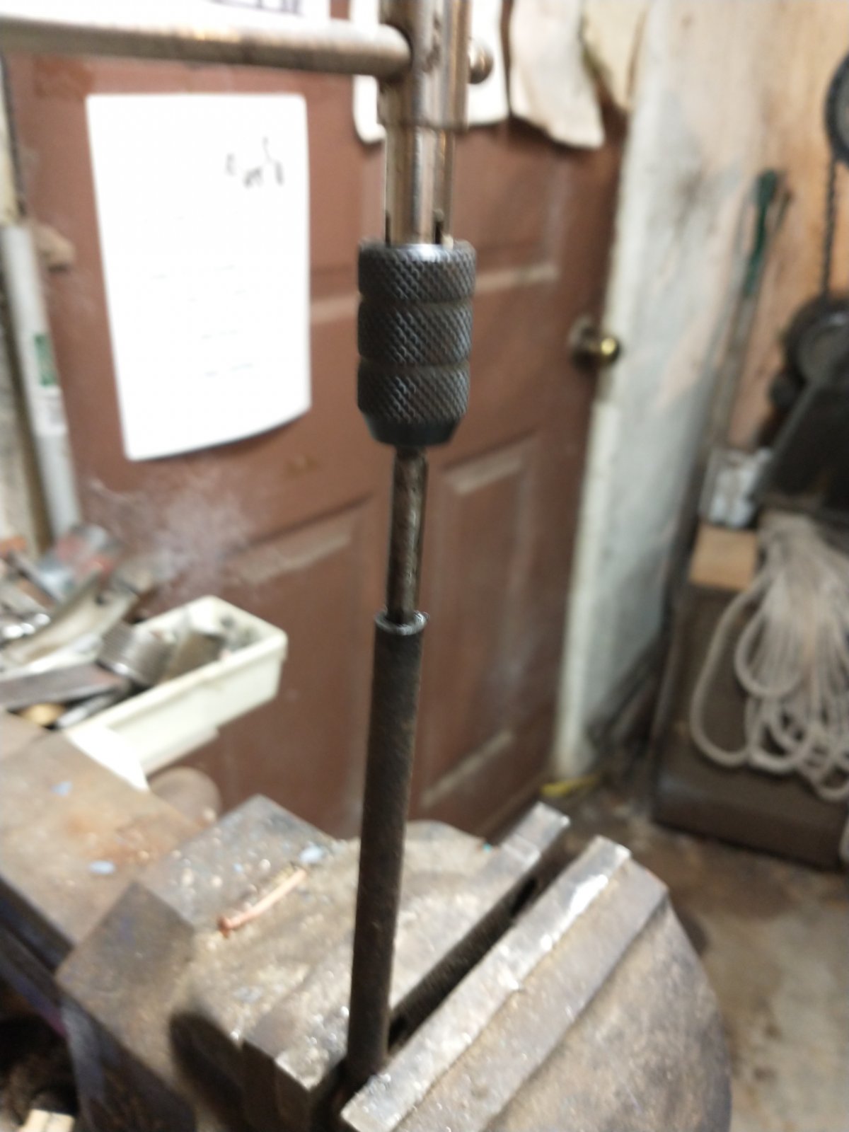

    Thank you all. One positive from the car show is that I discovered that my brake light no longer worked. Turns out the little wire connector between the brake arm and the switch that I fabbed up as a pattern for a proper job and then never replaced because it was working parted company at some point. That's what I get. I set out to replace it with said proper job this morning. It needs to be adjustable. I used the end of an old brake rod and some mild steel rod I had laying around. I think the pictures will be sufficient explanation.
    That's the brake rod end. I smartly (luckily?) cut it long enough that I could get the big end past the teeth of the chuck.
    That last one might need a little explanation. Lying under the car, front to the right. The big silver thing is the brake light switch. I had to use that little split ring because I didn't feel like unbolting the switch to feed it's hooked end though the rod, which has to be fed through the hole in the crossmember, so I couldn't wiggle the rod around to hook it up. Good thing I made it adjustable so I could accommodate that ring. Don't say anything about the wiring. It's working. Hahaha

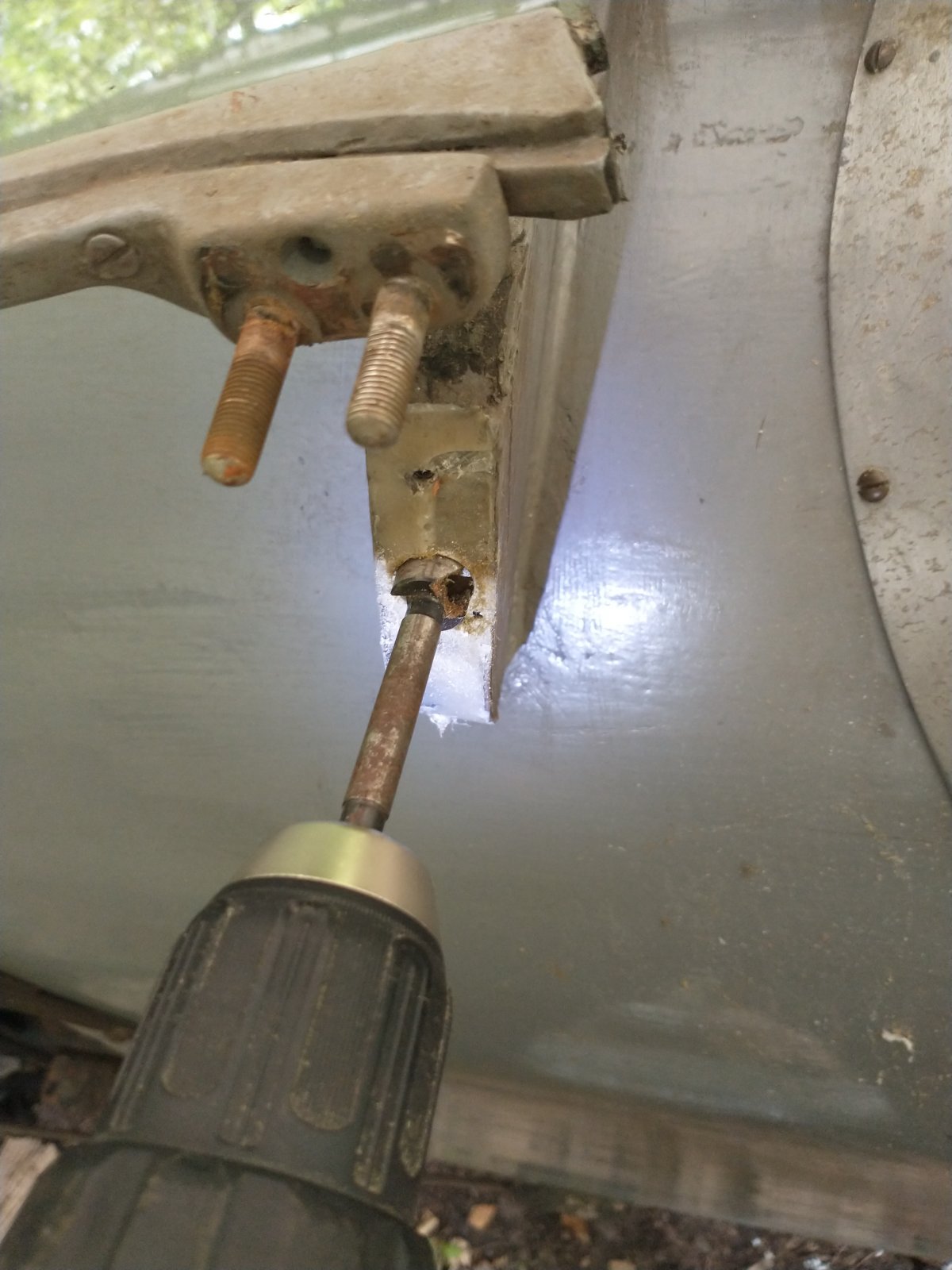

    The other project is safety related. I had a pretty concerning blind spot to the rear on the driver's side, to the point of feeling dangerous on multi lane roads. I had an old side mirror of 50's vintage. Not exactly period correct, but it is convex, which will help. I fiddled around and decided the best thing to do is to mount it on the br*** windshield bracket in between the top 2 screw holes, so I took that off and promptly drilled a hole between the bottom 2 screw holes. Oh well. I know those of you who have followed this won't be surprised at that. 2nd try got it in the right place.
    I could have just covered that extra hole up with my thumb in all of the pictures and pretended to be perfect, but where's the fun in that? Anyway, the base of the mirror was too big, and had that 50's streamlined space-race vibe, so off to the edge sander for some adjustment.
    While I was at it, I rounded the little point off of the bulge where the mirror joins the stand. Then it was just a matter of bolting it together.
    See how the nut sticks out on the backside? Had to drill a relief hole for that.
    And, just like that, a well-spent half hour. Works just fine. The image is a little fuzzy at speed, but I can see if the left lane is occupied without wringing my neck, so... That extra hole is going to gripe my *** for a while, but I'll get over it or figure a way to hide it.
