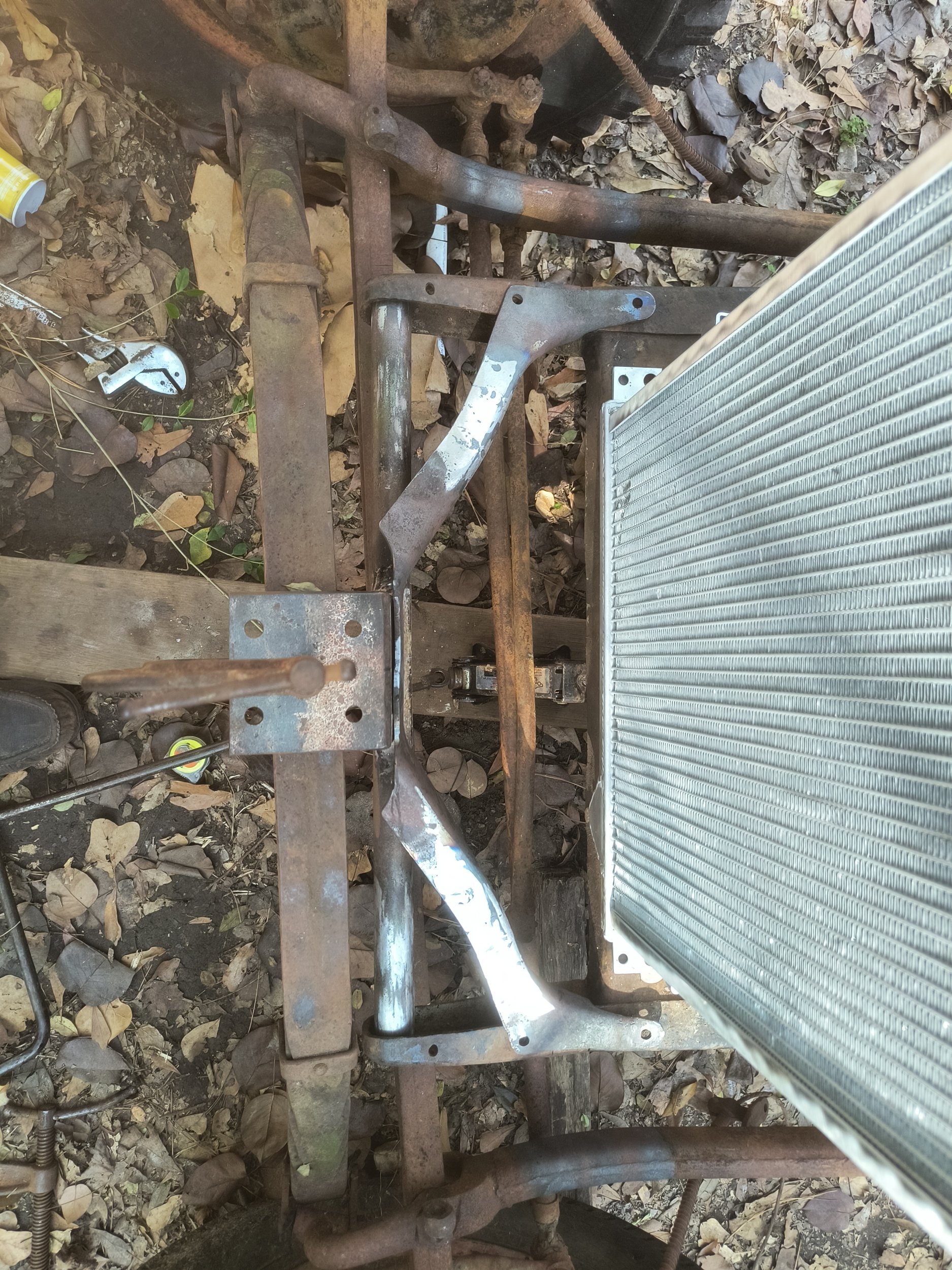

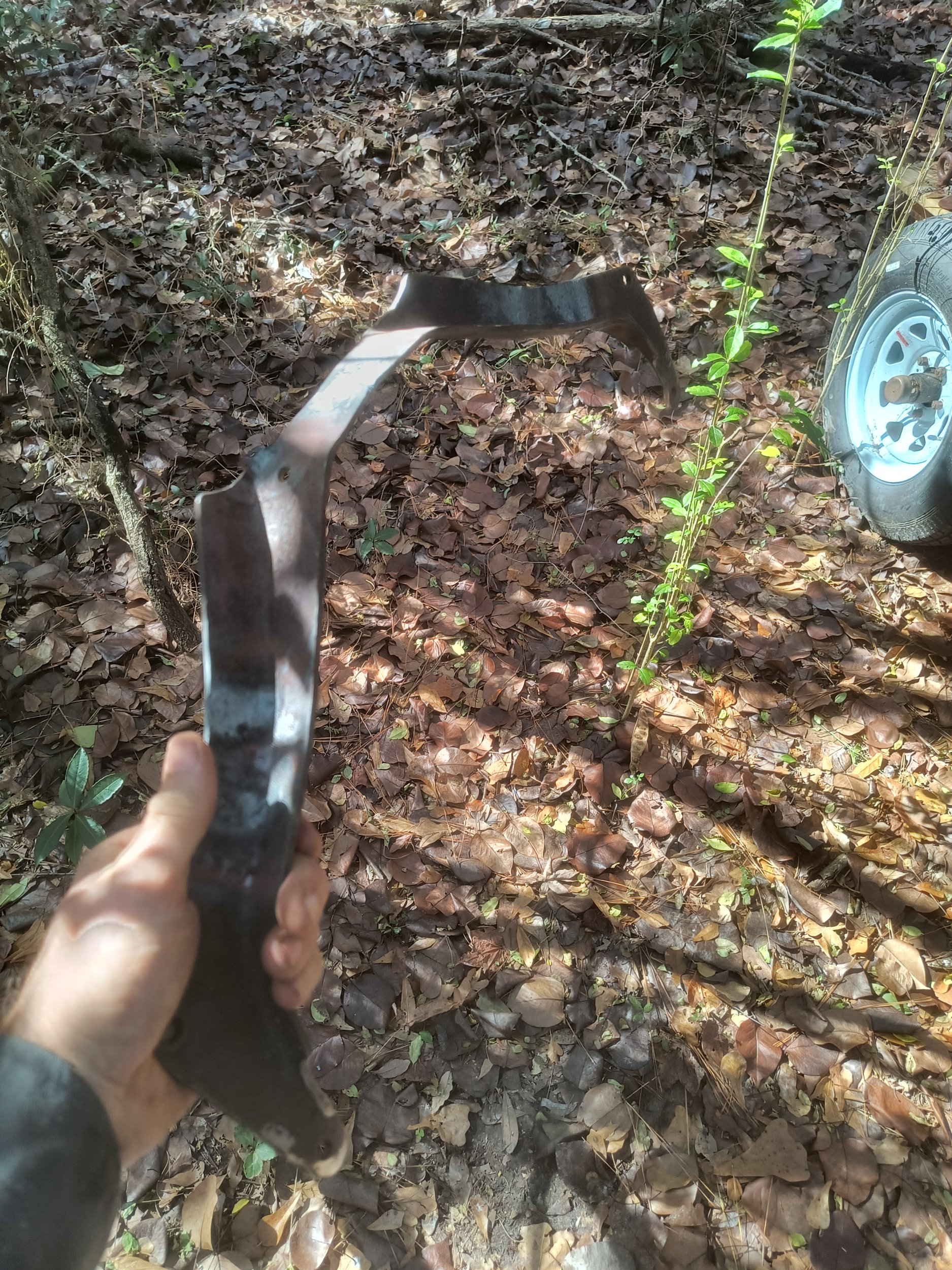

    I'm busily modifying the old T parts to fit my front end application. They have a curvature to the "foot" that fits the modified frame horns almost perfectly, but I decided that I liked the look of them better flipped over, so I had to reverse that curvature. Seemed like it would be a challenge because of the L-shaped crosse section, but the forge and anvil made short work of it.
    You can see the original curve. Sorry my phone decided my hand was the most important thing here.
    I should have flipped the finished one over here to be a mirror image of the one that is still original, but if you tilt your head and hold your mouth just right, this picture makes sense.
    One of the unexpected side effects of these brackets is kind of lucky. I know I'm going to need to reinforce the upper sides of the frame horns where I cut the notches so I could angle them up. These brackets fall right on top of that area. What luck. However, when I got them in the ideal position on the frame, they weren't lining up with the angle iron spring perch, so I had to curve them a bit.
    I thought about using the forge for this, too, but I was pretty sure that the facet I ended up cutting would have just turned out wavy if I heated and bent it. I do feel like I'm getting somewhere now.
    brEad, Stogy, Deutscher and 1 other person like this.

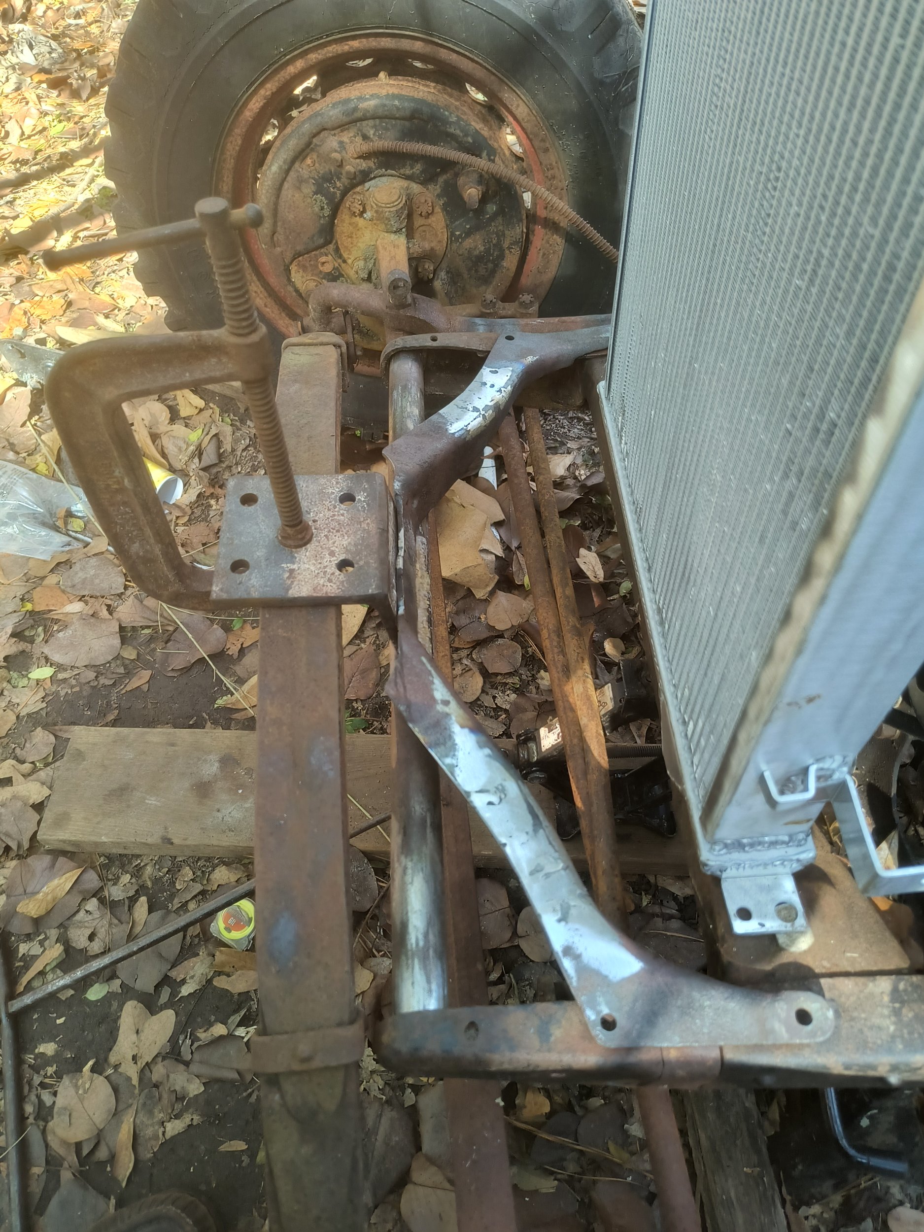

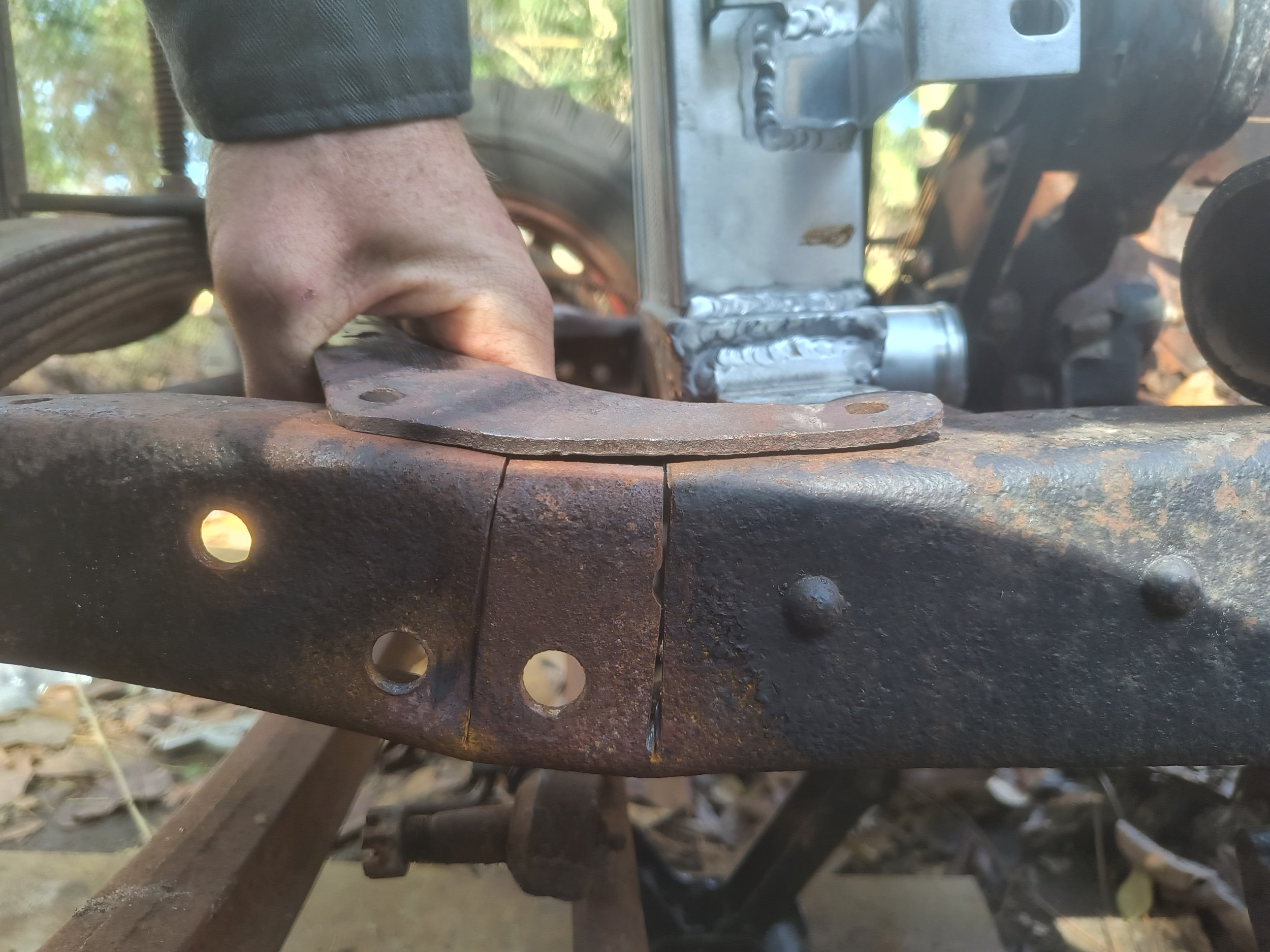

    I recognize that the last few posts have looked pretty questionable. I could see it in my head, but I'm not sure my communication skills are up to the challenge of making my plans clear. After a morning of grinding and bending and hacksawing and measuring and welding (not pretty, but I did at least get penetration, went ahead and welded from both sides, anyway) and about 30 trips back and forth, I have what I hope will be a little more understandable.
    This last one illustrates how the foot of the bracket will bridge the cuts I made on the frame horns. I'm hoping that will be enough of a reinforcement.
    brEad, BigJoeArt, cactus1 and 3 others like this.
  7. fourspd2quad
    Joined: Jul 6, 2006
    Posts: 938
    fourspd2quad
    Properly welded it will be just fine, myself I would box that section also

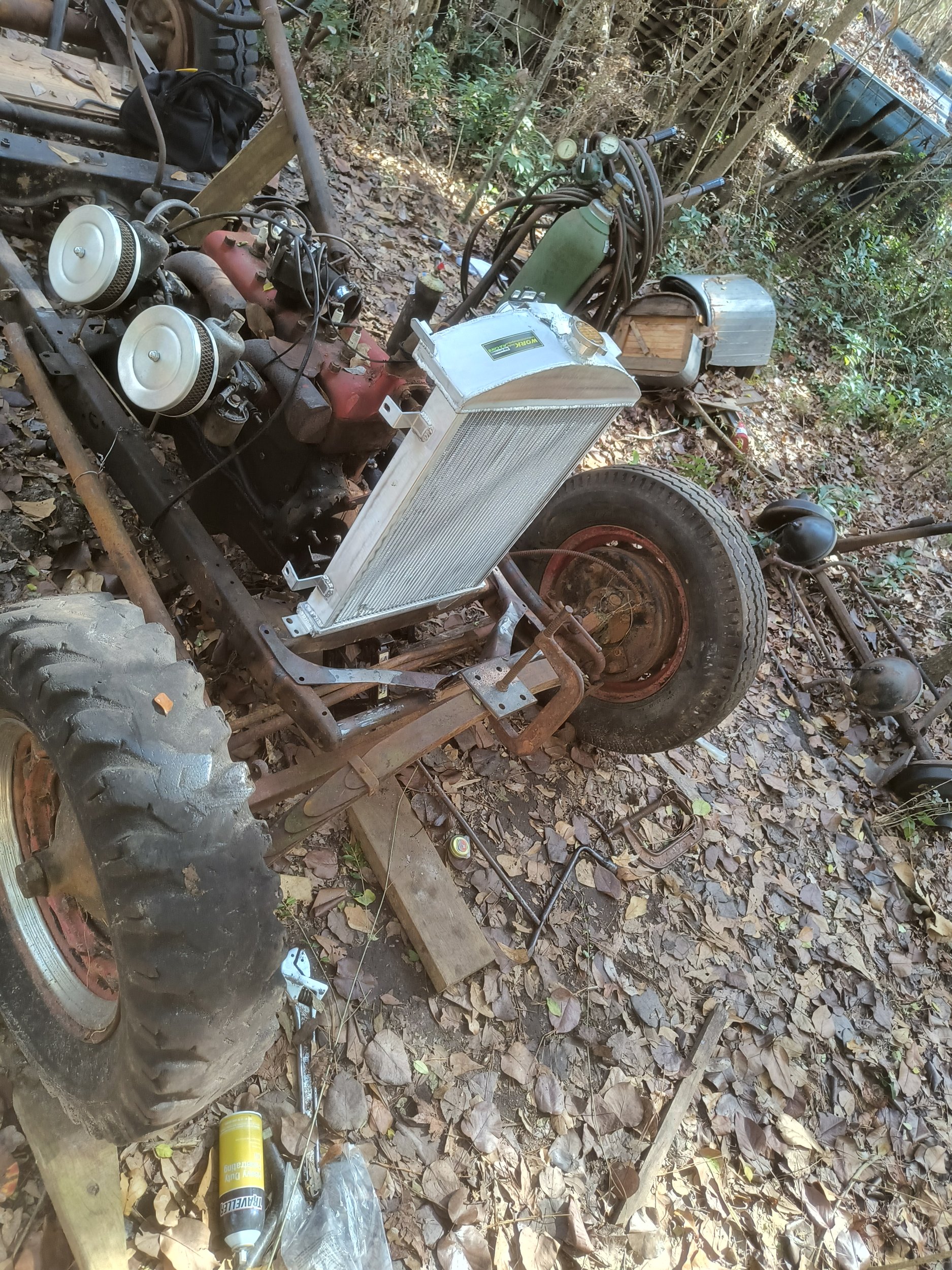

    Well, I've got the front end mocked up enough to hold weight. I'm bolting the front crossmember ***embly in, partly because I don't think I could get a hot rivet tight up under the original cross member where the rear of each bracket falls, and partly because I fully expect that adjustments and/or repairs will be needed once I finally get to drive the car. The local big box store was almost out of ****on head 5/16" bolts, so forgive the temporary hexes. I'm hoping the ****on heads will look enough like rivets that they won't be too noticeable. I'll fill the Allen holes (?) with something I can get out easily. I used 3 bolts per side, the middle ones are between the pie cuts.
    Somehow didn't get a close up of this, but the middle of the bracket is bolted to the angle iron with four 3/8" bolts. That's probably overkill, but I wanted to tie this center section in pretty solidly, since it's basically flat. In hindsight, I don't think I need the inside two. Oh well. I just drilled and tapped that 3/8" angle iron to receive the bolts, so I can eventually trim them flush on the inside. I just used the shackles from the original Model A front end to clamp it all to the spring because they were lying around, but they seem to fit well. Haven't fooled with the center pin yet, just mocking up at this stage. Here it is supporting it's own weight, at least in the front. You can see the aforementioned bolts in the first picture, if you squint.

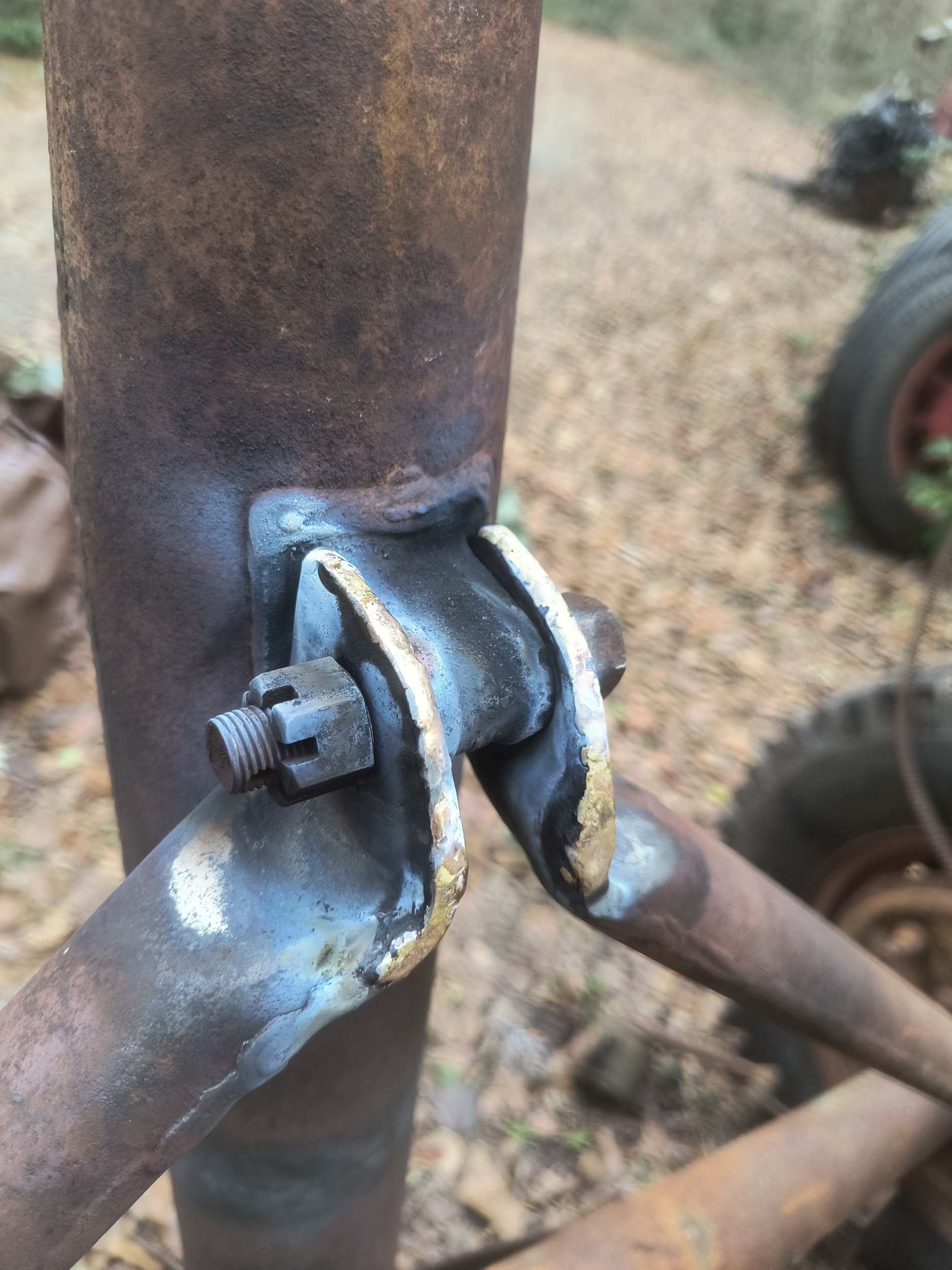

    I had to shorten my radius rods for the rear end. Right off of the bat, let me say that some of you might be a little grossed out by how I've done this. I could have made or (gasp) bought some custom plug-in fittings for the cut ends where they attach to the torque tube, but I went with wagon technology. I can always cut them again and make some more elegant terminals, if I need to. I think this will work, though.
    First step was to bolt them on one at a time and bend them so that they crossed just under the lug on the tube.
    I realize that one is crossing the lug, not under it. That was before I finalized my plan. I fixed it after the picture was taken. Next, I cut them off a little long and bolted them back on (one at a time again) and carefully marked where the face of the lug fell on each one. Took them back off and compared. The marks didn't quite line up from one to the other. Shoot. That means the tube is not perfectly square with the differential. I measured carefully, and came up 1/2" different, which means 1/4" off. I sat for a bit pondering. I wasn't happy leaving it that way, but I didn't want to intruduce a side load on that long bearing at the nose of the driveshaft. Which was the lesser of those two evils? I decided to square the axle, theorizing that the stress on the bearing would be pretty light. Hope that turns out to be the right decision.
    Anyway, having decided, I just pulled it with a ratchet strap and re-marked the radius rods.
    It took a moderate amount of tension, but nothing crazy. This is the point where I decided to take the old school route. I've seen plenty of pictures of old original cars, especially fairground racers and such, that have split radius rods (and even wishbones) with the ends just flattened and bolted on, so I though I'd give that a try. Off to the forge and anvil.
    I know that looks like hell, but just wait. Anyway, once more back to the car, bolt them on (one at a time, again) and torch bend them to fit.
    I marked the lug outline on the inner face of each rod and hacksawed the ends to a rough shape, then inside to the bench grinder and edge sander. Ended up with this:
    Back out at the car, I bolted one up to the backing plate and marked where to drill with a close fitting bit.
    Inside to the drill press, then out to bolt them back on and mark the other one. I have become an expert at bolting on 1937 radius rods. Haha.
    Guess what? Yep. Unbolt that one and back to the drill press. After I did that and got everything re-***embled, I removed that ratchet strap to see if it turned out square. Dead on.
    I think I'll weld or braze around those ends where I smooshed the walls together, just to prevent water intrusion, but I'm pretty happy with that. I'm not planning on the same thing for the split 'bones in the front, since they are articulated. I think I'll use Model A tie rod ends on them.

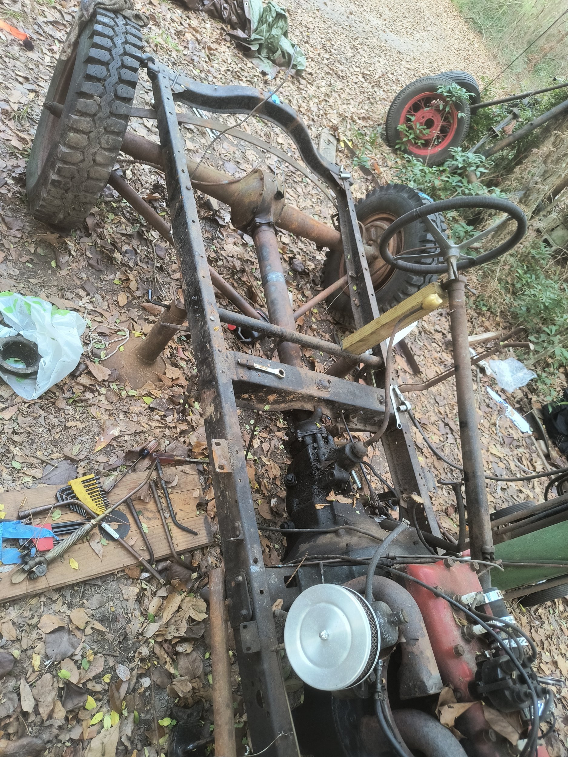

    At this point, the frame rails were sitting on the differential, at the ride height that looks good to me.
    You can see the '37 main leaf there. My original plan was to step the frame enough to just use the Model a spring in the original crossmember, but I ran into a couple of issues. One being that I was going to have to put in more of a step than I wanted to (no offense, I just don't personally like the look of those real tall steps), and the other that my gas tank would have to end up really high in order to clear the crossmember. I want the bodywork on this car to be reminiscent of the old car, want them to be related, so to speak, and that kind of dictates a similar gas tank arrangement for this one. A predicament for sure.
    On thing was certain, I was still going to have to step and shorten the frame, so cut the back of it off. In the rain, no less.
    I sat that piece up on top of the main frame and looked and figured and adjusted, I finally decided the best thing to do is to flip the Model A crossmember 90 degrees to the rear and use the '37 spring. You can skip to the last picture in this post real quick to see what I mean. Kind of like what some of the old racers used to do with Model T front crossmembers, back in the day. So, time to chisel and grind off some rivet heads. My appreciation for the strength of that system grows .
    I wish I had thought of using the cold chisel before. Anyway, I want to re-use those stock brackets, so they had to come off of the frame rail stubs.
    Lots or rivets holding all of that together. Whew. The frame ends with the brackets now need to fit inside the old spring pocket of the crossmember, which is 2 7/8" wide, so I just figured out what spot on those tapered rails, with the brackets on the outside, would fit there and marked out some ears.
    I drilled those holes where the corners will be hoping to avoid future stress cracks. Ended up with this:
    Then a little torch bending and t*******.
    This is how the brackets will go:
    Mockup:
    That big C clamp is holding the '37 main leaf to the new bottom side of the crossmember. Still figuring on the best way to deal with attaching that, but something will come to me. Thanks for looking.

    It's basically the Tardel method, I just made my filler brackets with a little more slope, purely because I like the looks of it. Told you my welding aint too pretty. At least I can see from the back that it penetrated fine. After I got it all done, I slapped the crossmember back on it so I could measure and check for level again. Seems good, so I'll drill and bolt the crossmember brackets and start putting the axles back on tomorrow. Damn near got a roller. Knock on wood.
    Hardly looks like a Model A frame anymore, does it?

    It's not a Model A frame anymore... it's a SPEEDSTER frame.
