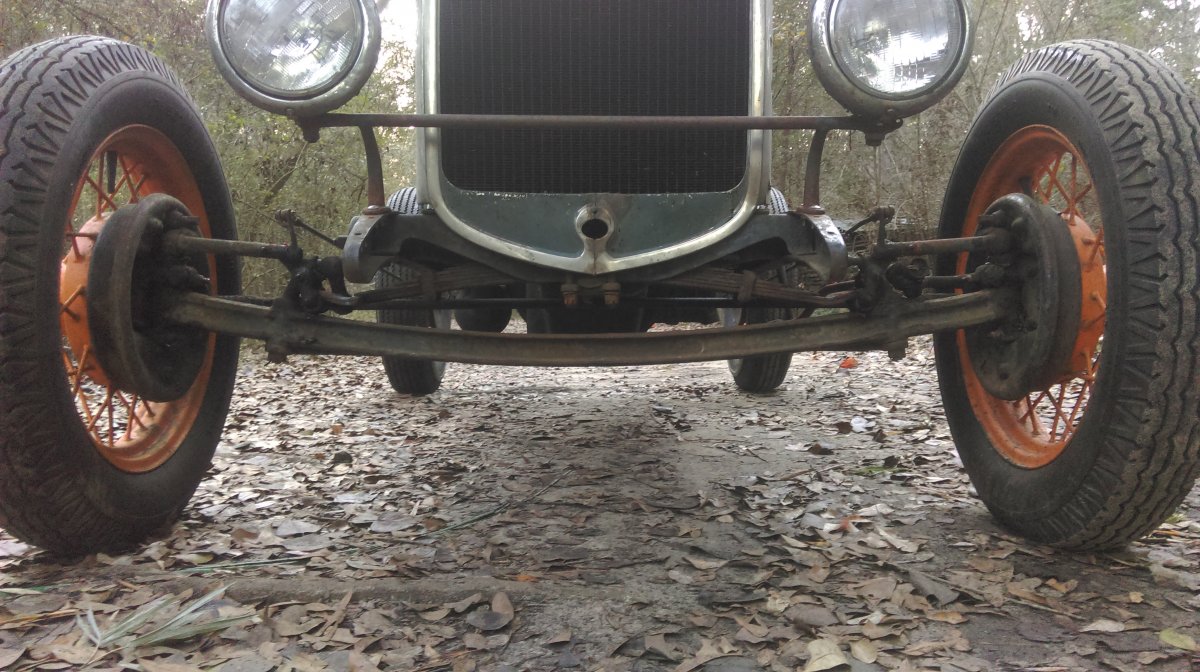

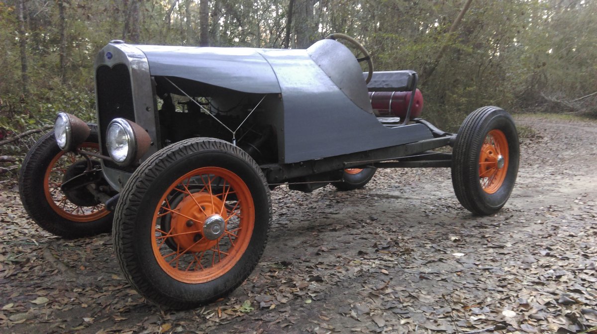

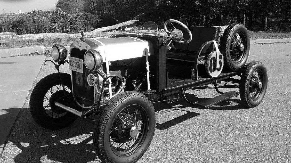

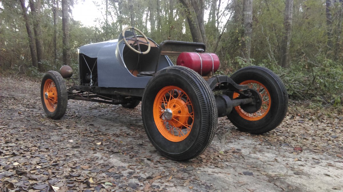

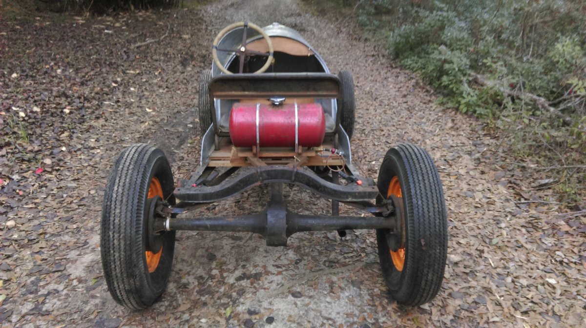

    I stumbled on a pair of 700-19" tires for a good enough price that I couldn't resist trying them out. They are really big, but new old stock and in fine shape. They'll work for now, until I find something else. Kind of reminds me now of some of the old cars like the ones Jimmy B posted in his "Modifieds as they were" thread. I think a lot of those old time guys ran what they had, or could get, and aesthetics were kind of secondary. I also wonder if they didn't have large diameter rear tires just for the salt, for the gearing advantage, and smaller ones for the street? Kind of like how they had to put the fenders back on to make the cars street legal?
    Anyway, I stole a picture from that thread as an example. If that's not appropriate, please let me know. I'm not trying to say my rig has anything on this car, just an inspiration kind of thing. I know modifieds and speedsters are different animals, but the ***le of my thread does say "speedster kind of thing." Left myself a little wiggle room. I think if I could find some 600-19s I would be set. Anybody want to trade for my 700s?
    Now a few of mine. There is also one of the bent front spring that I didn't manage to include in that post.

    I like the rubber rake, fine job!
    Bumps it from 'putt-putt' to '****-n-git' in my book. :D

    Run the 700's , like you said use what you have. There are no rules for a build like yours.
    weps and deathrowdave like this.
  8. rusty rocket
    Joined: Oct 30, 2011
    Posts: 5,254
    rusty rocket
    ^^^^^I love 3/4 rear views. Its forced perspective the rears look bigger and the fronts look smaller.^^^^^^

    Thank you. Yeah, the rear 3/4 does exaggerate it. I must have accidentally hit the "thumbnail" ****on on those last two. I tried the 700s out before I lowered the springs and was not happy. The lowering helps, though. I found the one picture I took of the first try, and I'll re-post the profile I just put up, so we can see them together. Old height first.
    It's kind of subtle, especially in the pictures, but in real-life, the whole car seems lower and more appropriate. It really seemed to tower in the back before I removed the leaves and bent the ends on that rear spring. I probably only lost a couple of inches or so, but it made a difference. You can get an idea by comparing the angle of the frame to the ground.
    Dannerr, burl, cactus1 and 3 others like this.

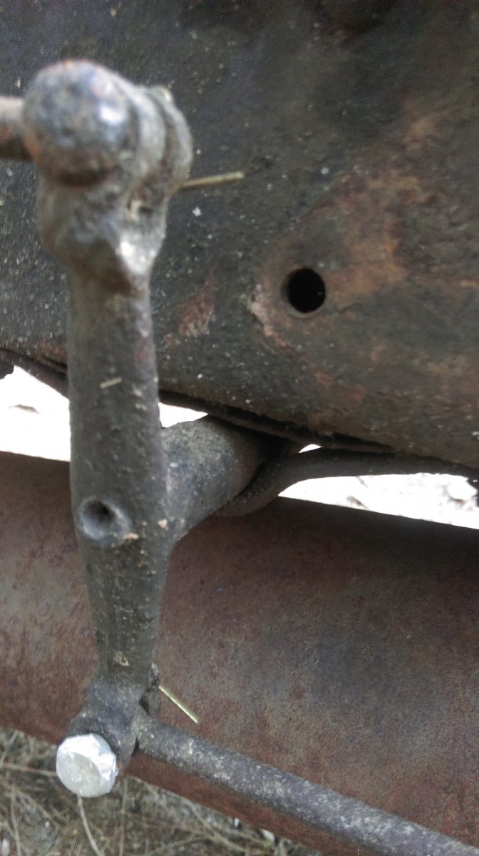

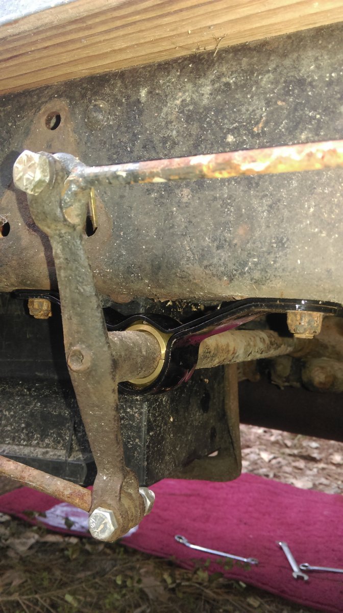

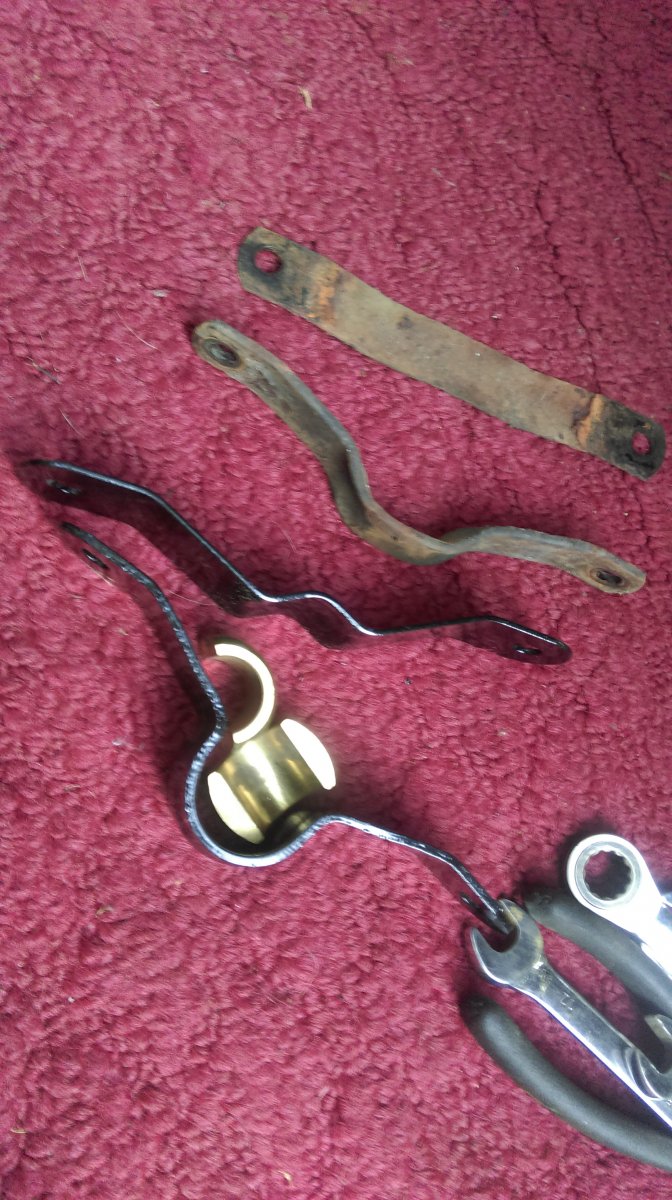

    I don't know how common they are. Got them from a shop that was liquidating all of its inventory. They are unused, rubber is still pretty soft, no cracks. Seem ok to me. Another reason I haven't tried them out on the road yet is that the brakes on this thing are scary. I have done gobs of research and adjusted them at the wheels (correctly, I'm pretty sure), but I can't even get them to lock up on dirt. Out on the open road, I couldn't panic stop for anything. I peered around underneath, saw the rod from the pedal to the cross-shaft was already adjusted as short as it would go. I have pulled all four drums, shoes have linings that look fairly unworn to my ignorant eye. This sloppy mess holding the cross-shaft to the frame rails looked wrong, though.
    So I hit up Mike's Afordable parts again (shameless plug, they have been good to me) and ordered some split bushings and the appropriate brackets. The weird thing is that there is no way the old brackets have room for a bushing. The shaft just runs on the brackets. Are they stock? Modified? Did early '28 A's have non-bushed cross-shafts? Here they are with a set of the new parts.
    Got them installed no problem. I didn't grease them yet. As far as I can tell, there was never a provision to do so. Maybe because grease would attract dirt and accelerate the wear? Anyway, they are obviously new parts, kind of shine like a diamond in a goat's *** on that old ch***is, but oh well.
    It was getting dark by then (shade tree, remember?) so I decided to forgo adjusting anything. After all, the cross-shaft is in pretty much the same place, just held there better now. Jumped in and tested them on dirt. Absolutely no change. Phooey. I'll have to go through the whole procedure, by the book, and adjust all of the rods and wedges, hopefully get some brakes working. I still think the new brackets and bushes are a damn sight better than what I had. Progress (I hope).

    Have you checked to see if there is any slop at each connection for the brake rods? If the holes are worn oval in the clevises and arms at the brakes or cross shaft, it all adds up. The pins need to fit snug at all the connections.
    I had all the worn holes welded up and I redrilled them. You can also go to a larger diameter pin size.

    I'll check the rod ends. I think a big part of the problem is that the rod from the pedal to the cross shaft is adjusted as short as it will go, which makes the arms at the ends of the cross shaft angled. My understanding is that those arms should be vertical before the brakes are applied, to maximize the mechanical advantage. I'll start there and work my way towards the ends.
