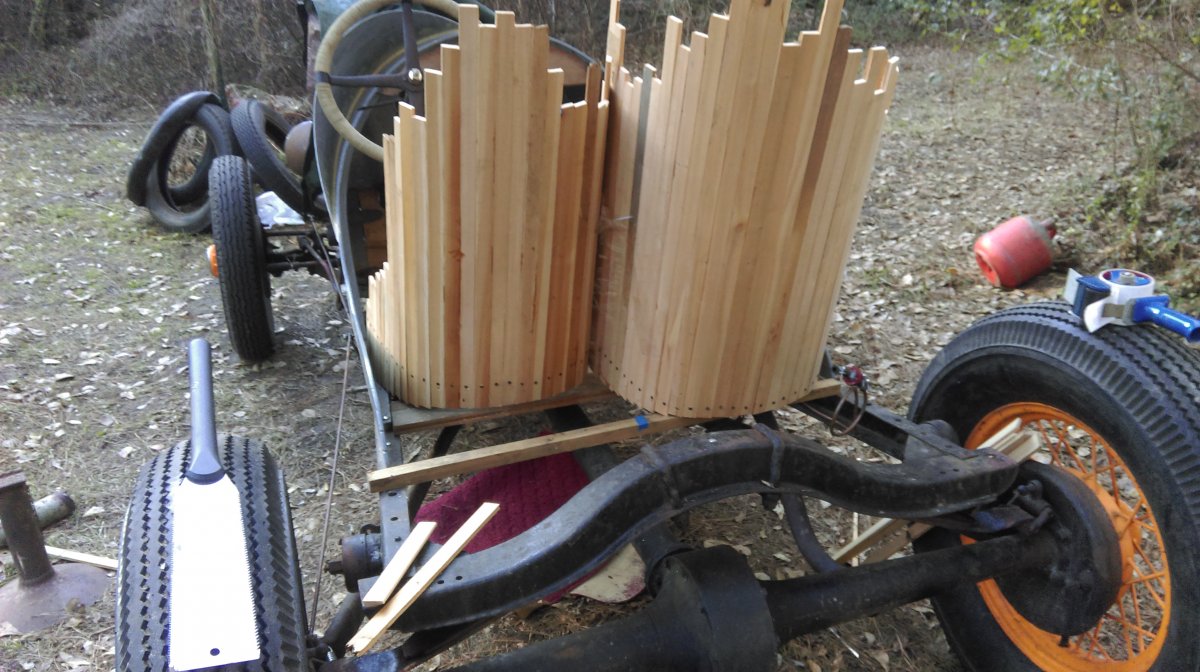

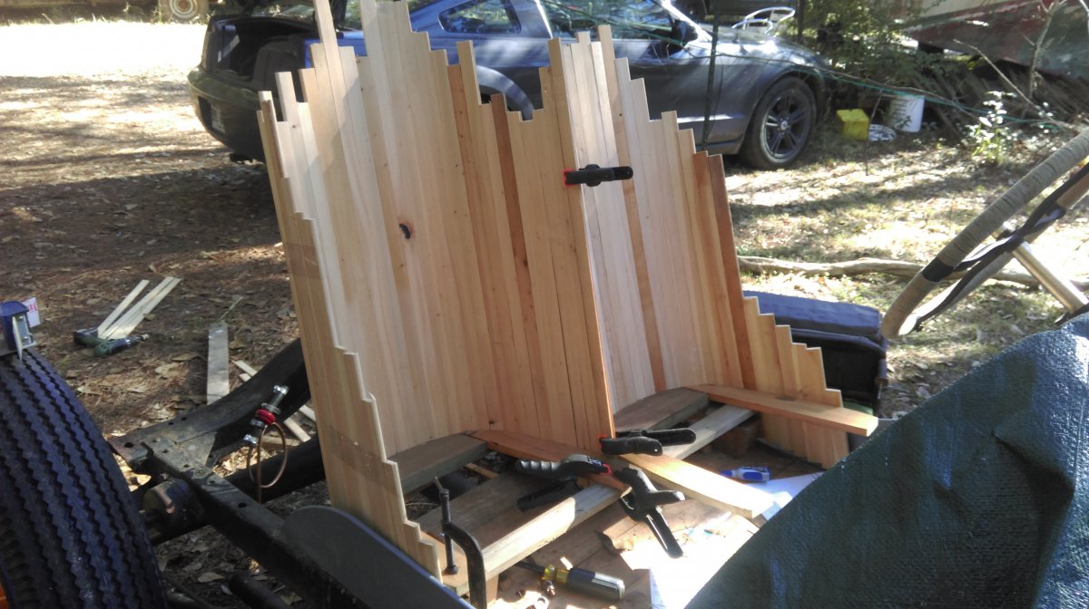

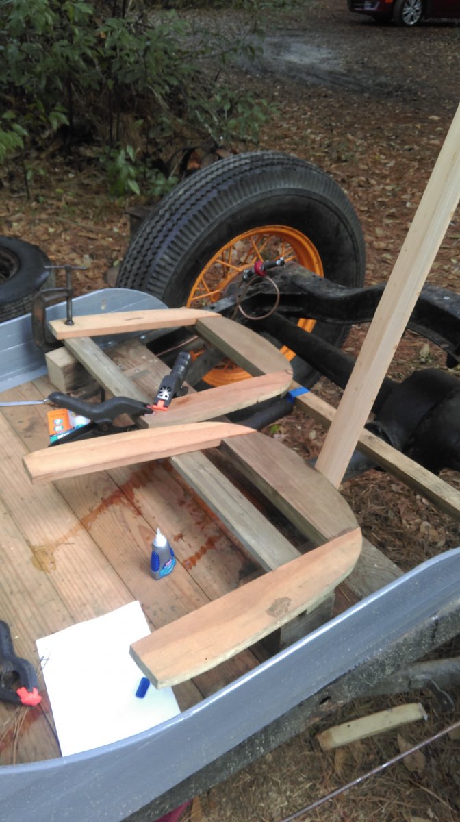

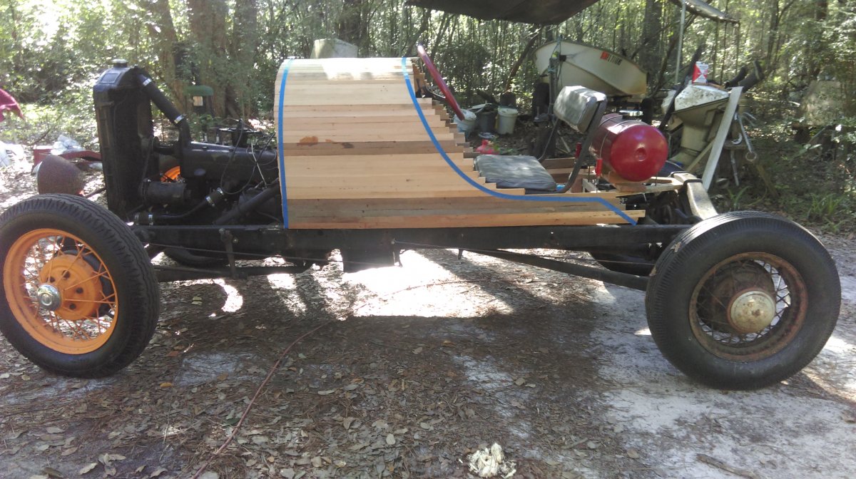

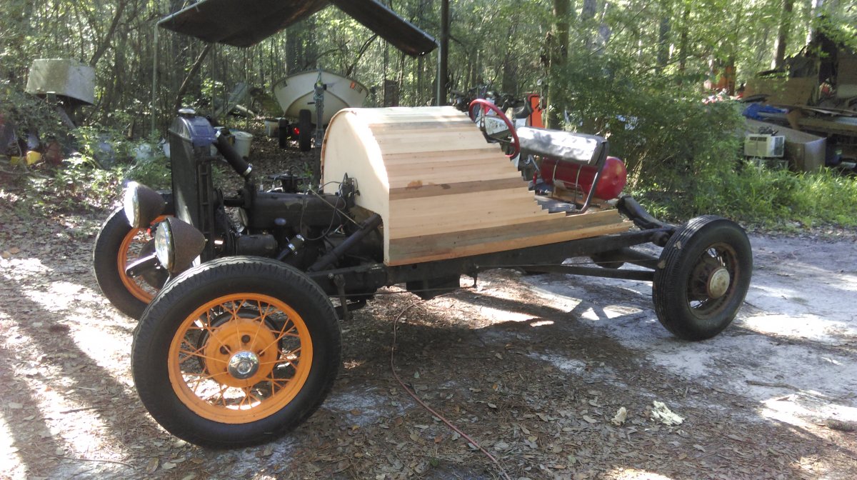

    The old Jeep seat had some issues. I felt like it sat too tall and, since it was just a flat bench, it didn't inspire a feeling of security, so I decided to make some seats. I copied the staggered arrangement a lot of European pre-war racers used, and I think Paco made a Model T speedster body with them, as well. Not much explaining to do. Same strip/epoxy method I've been using all along. Again, the epoxy is a modern convenience, but there is nothing here you couldn't do with one of the old hide glues they had back then. It would just take longer. You can see my mocking-up/eyeballing methodology pretty well here. Made them way oversize and just kept cutting the ugly away until I got it where it looks right to me. Probably some more adjustments to come.
    IMAG1378.jpg IMAG1379.jpg IMAG1380.jpg IMAG1392.jpg IMAG1396.jpg IMAG1398.jpg IMAG1397.jpg IMAG1399.jpg IMAG1400.jpg IMAG1402.jpg
    I just measured my**** and went from there. They fit pretty snug, but I think they will be comfortable enough.

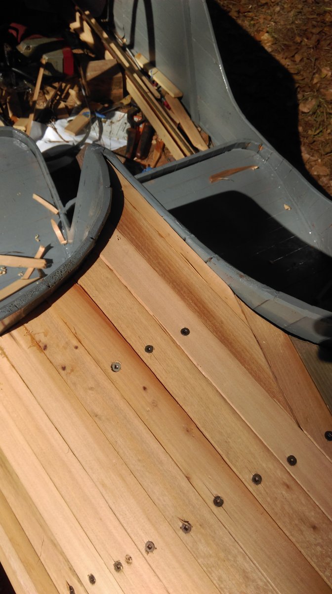

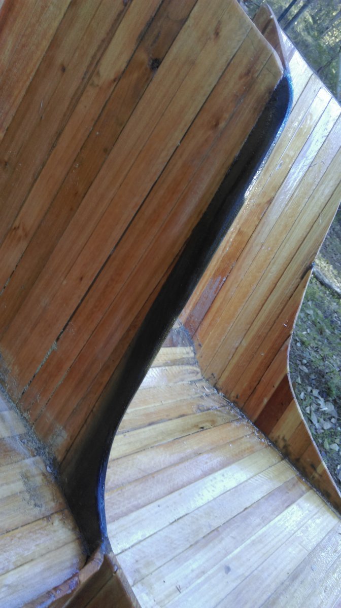

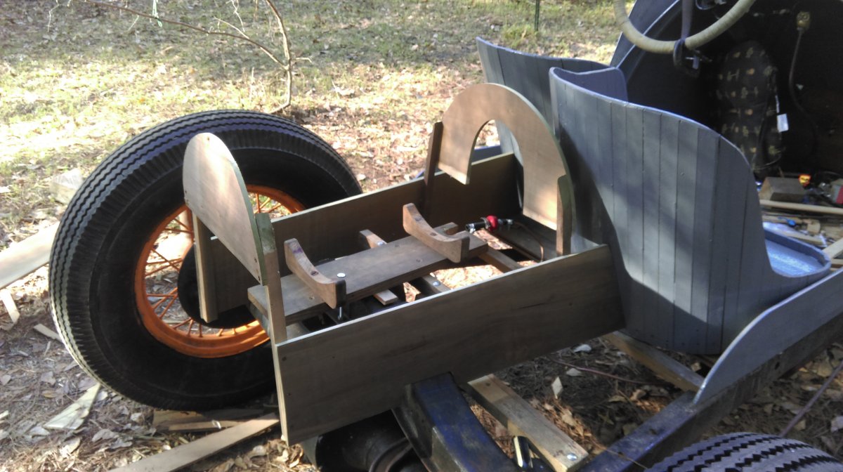

    Nibbled away at the seats some more this morning. Finishing out the front edges. I'm going to add some more bracing underneath. Sorry about the overexposed pictures. It's a real pretty day here. Obviously, the vertical parts will get trimmed. I'm going to leave 1/2" or so proud to keep whatever cushion I end up using from slipping forward. The ends are so raggedy because they are what I trimmed from the excessive height when I made the seat backs.

    These pictures are a little dark. Had to wait for some epoxy to dry, but I couldn't resist dashing out just before dark and roughly trimming the new fronts, just so I could get an impression. I'm pretty pleased. I am planning to add one last bit of bodywork over the tank, shamelessly copied from the car in the "totally insane race car..." thread. Pretty obvious where I got the inspiration for the seats, too. My tank will be covered by that projection, though.

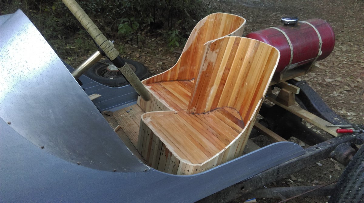

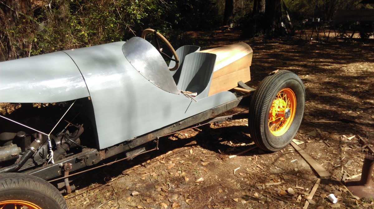

    I pulled it around to the regular old picture spot. I'm going to need to re-bend the gearshift, but I'm pretty happy with the seating.
    I have some work left to do in the middle where the two seat backs meet. The angle is awkward, and they aren't really fastened together at all, and that bothers me. It needs to match the angles of the outside edge of each seat. The tank looks awkward mounted like that, but I think my last bit of body will fix that. As always, thank you all for looking and for your input.

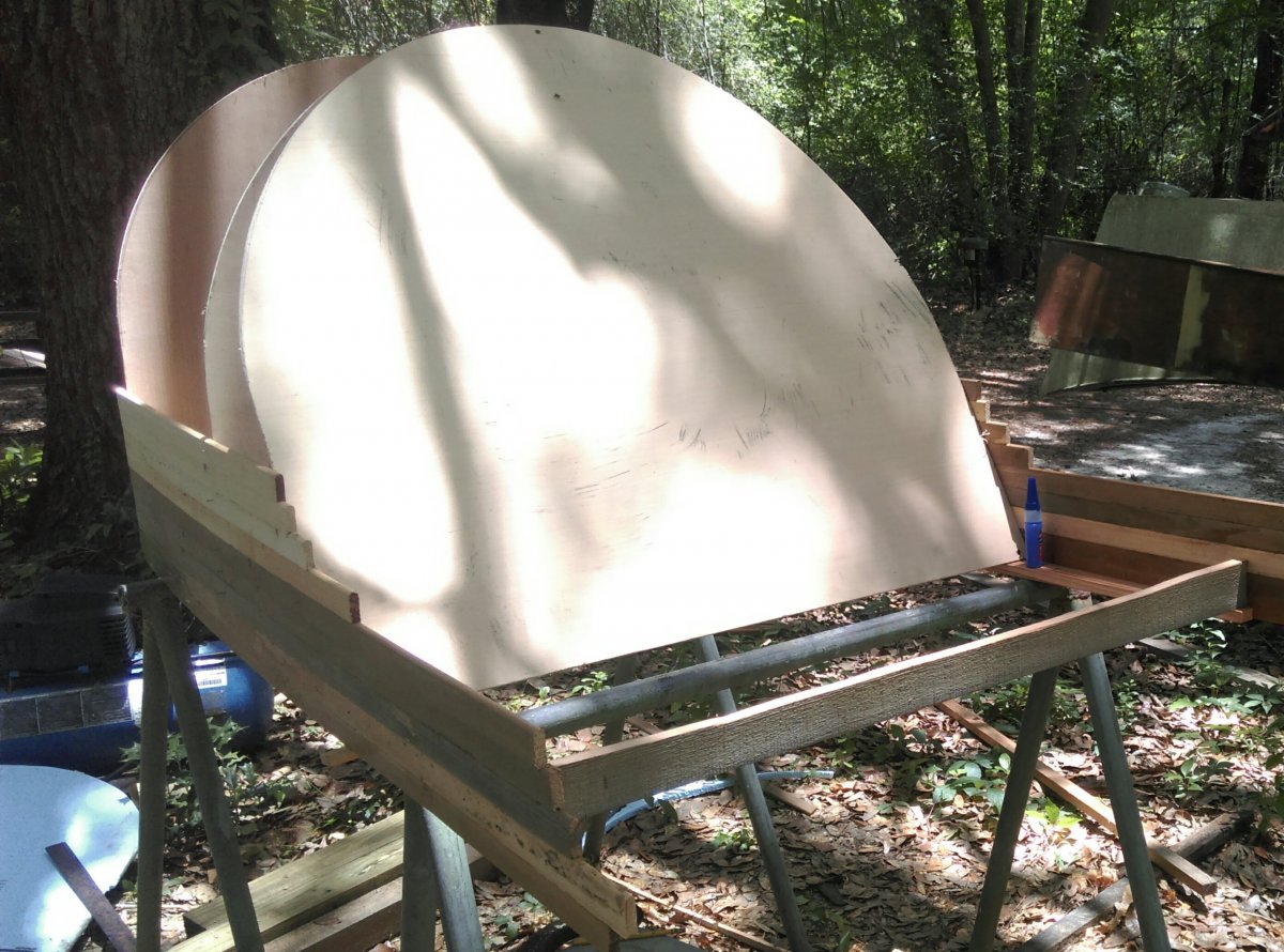

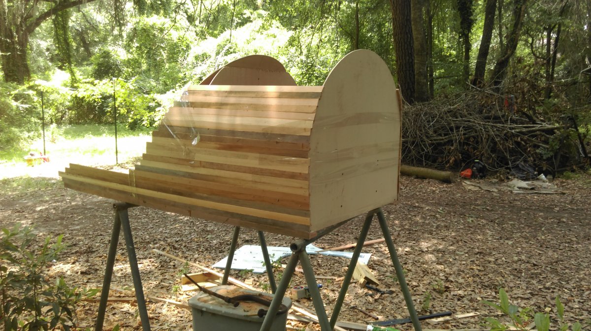

    Got a bit more done. I added this piece to the junction between the two seats.
    Then started working on the little rear projection. This will eventually have the filler cap coming up through the top. No plans, again, just winging it. The big side pieces (and the piece in the seats) are Tulip Poplar, leftover from boat planking projects. The two little planes in the last picture my father made. One convex, one concave. They let me make bead or cove faces on the big pieces and the beveled ends.
