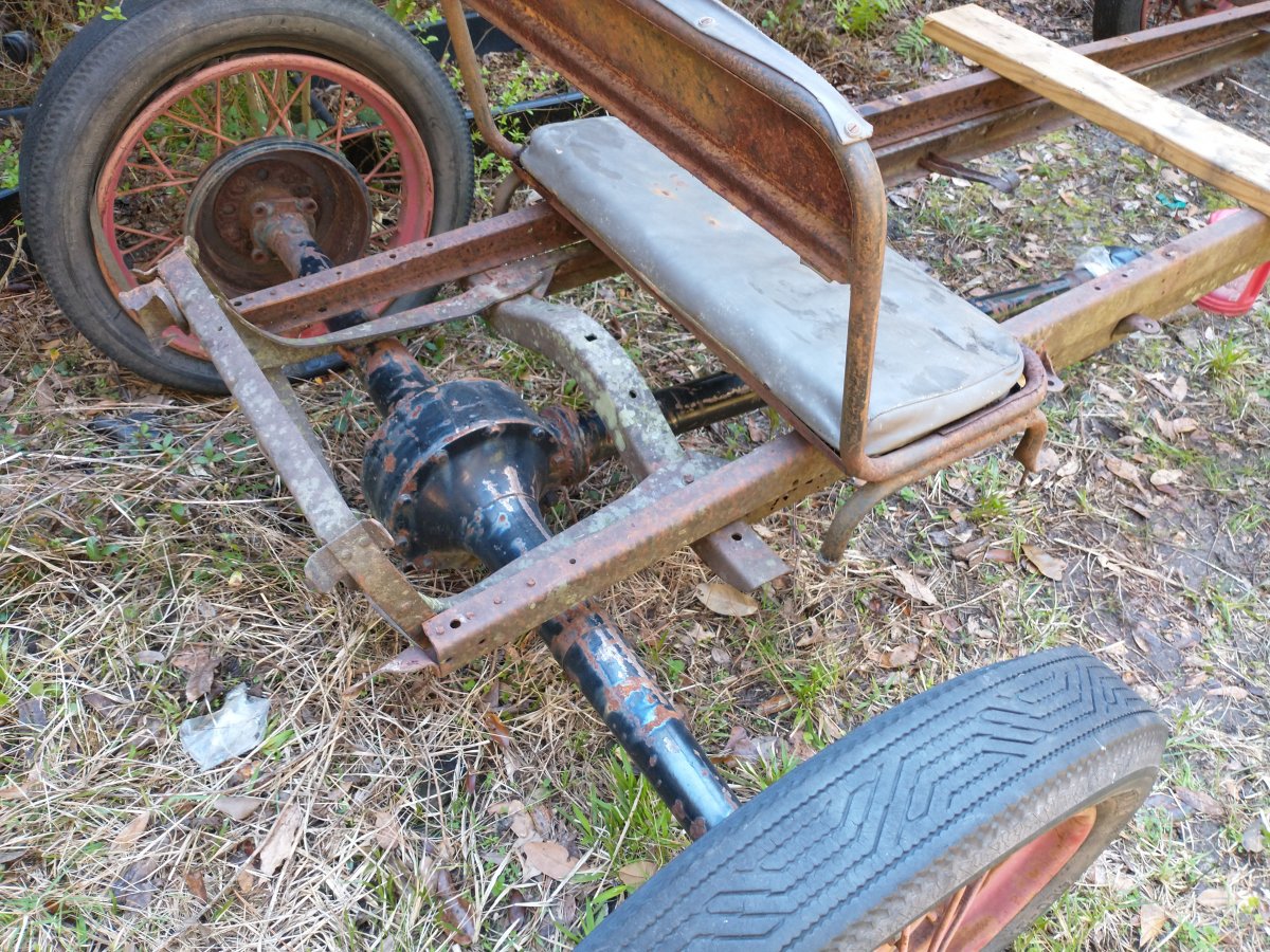

    Well, for those of you who followed my last (first??) build, you should expect this to be a long, drawn out deal. You won't be proven wrong. I have this little tin-side v8 60 that I picked up a few years ago and got running, after a fashion. It's still a work in progress, but it shows enough promise that I've been daydreaming pretty steady about what to do with it. I have a couple of old Model T frames that my father and I found in the woods decades ago (literally, they were just lying there), and I recently picked up a junky Model A front end and decent rear, so I decided to do a little mocking up. I'm thinking of some kind of American fairgrounds racer/pre-war British hill-climb special kind of thing with semi-elliptical leaf springs front and rear, so I picked what I felt was an appropriate wheelbase (around 90") and plopped the best frame down.
    That looked promising, but boy are those T frames floppy. I was looking at the other one lying there, and noticed that only the bottoms of the rails are tapered. Tops of the rails look perfectly straight and flat. What if I flipped that frame on top of the 1st one and riveted them together? I had to drill and cold chisel out the old rivets holding the running board brackets on, but that was no big deal. I told you these things were in the woods.
    By the way, if you haven't ever tried to un-rivet something that those old boys at Ford put together way back then, you may not have a proper respect for what a good way that is to join metal parts together. My plan is to hot rivet the two sets of rails together. I have no concern about the strength of that method.
    Anyhow, while I was cussing those rivets, I suddenly thought of swapping the top one end for end. Since it is upside down, the rear crossmember of the top frame sits upside down in the front. Should be able to figure a way to mount the radiator to that, and it gives me a strong front crossmember as a basis for whatever I build to support the front suspension. Ended up with this:
    The ends of the bottom frame will be cut off. They are sitting now approximately where the quarter elliptical springs will be. That transverse spring will obviously be gone.
    Same thing with the ends of the top frame, and those extensions on the bottom frame. I don't know what they are, maybe for a touring car body, but they are conveniently placed right now to imitate the eventual rear springs. Had to spraddle the top rails out a bit to clear them. The frames rails are parallel, so they will be lined up on top of each other when all is said and done. The board is about where the pedals will end up, old Jeep seat is the right distance from them for me. Just sitting there right now for dreaming.
    Again, I'm warning you that the updates will come at a trickle, probably. I don't really do a lot of planning, just kind of let things evolve.

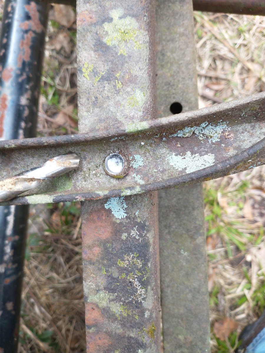

    Well, these old frames have sure seen better days. For the most part, they are in remarkably good shape, but each one has a spot where the rails have rusted through. The tops and bottoms are fine, all of the rust is in the vertical face. I don't know what the experts will think of my solution, but I just wire brushed the hell out of it, clamped a piece of copper to the outside, and brazed it up from the inside. It's pretty clumpy in there, but the copper peeled off of the outside just fine and it filed flat pretty easily. Keeping in mind that I am doubling the frames, I'm pretty confident it will be strong enough.
    I also removed for the spare tire holder and trimmed the top frame to length. I left the bottom frame long for now so I can keep propping it on the front axle. Helps with the dreaming.

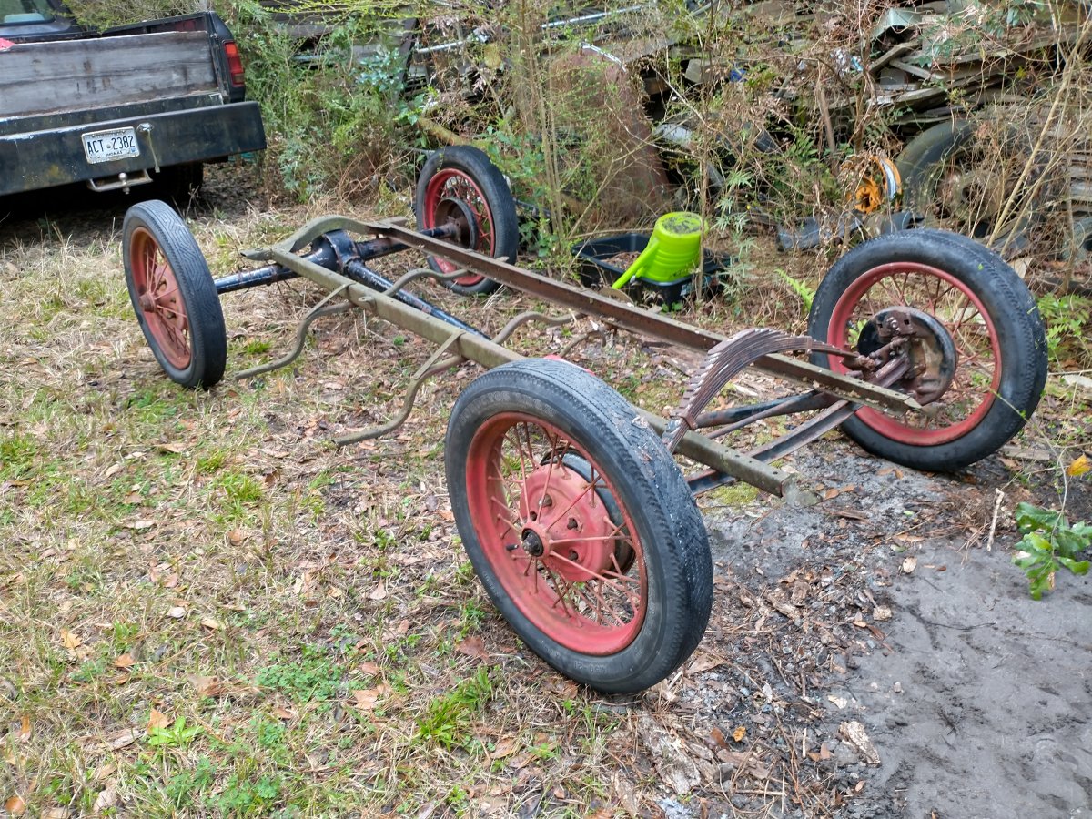

    Thank you. I got a bit more done this morning. The crossmembers are riveted on, of course, and since I'm laying the frames on each other top to top (the uppermost frame is upside down), those rivets were propping the top faces of the frames away from each other about 1/8" or so. You can see it up the thread in the last picture I posted. I decided the best solution was just to drill holes in the opposing frame faces for the rivet heads. A little measuring and drilling (and a little work with a rat-tail file, because my measuring skills apparently weren't quite up to the job) and they fit like they were made to be that way. I clamped the frames together and did a little more mocking up, looking at wheel base and ride height. As it is in these pictures, it's about a 102" wheelbase, just shorter than a stock Model A, but that's a little deceptive. The nature of the semi-elliptical (edit: That should be 1/4 elliptical) suspension I'm planning on means the frame itself is really short, around 6 1/2'. I think Frank Gerber's Whippet Special was around 80", which is pretty short. If I was using stock transverse springs, I'd be right about there with this one. I'm not confident that my suspension design skills are strong enough to make a useful car with that short of a wheelbase. My understanding is that short cars can work, but that they can also exaggerate design flaws. I'm hoping to end up with the short frame keeping the weight as close to the center as I can get it which, along with the decent wheelbase, will hopefully be nice to drive. I also want it low, but not "modern" low. As it sits right now, I'd have about 5" of clearance to the oil pan of the v8 60. I might raise it up an inch or two. That's my old defunct Model A radiator and surplus Jeep back seat on there, just for dreaming. The radiator I'll be using is about 3" shorter than the A one, should top out about where the upper tank starts on the mock up.
