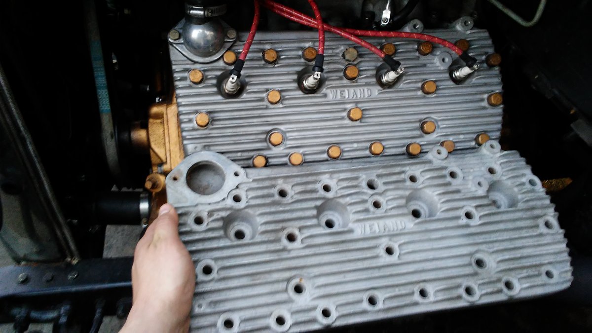

    After a major screwup on my part I had to the tear the motor back apart and redo the entire valvetrain..... I have it back together and is running well, finally!!!!
    I learned that it costs a lot money to be cheap sometimes!!!

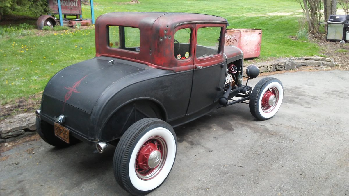

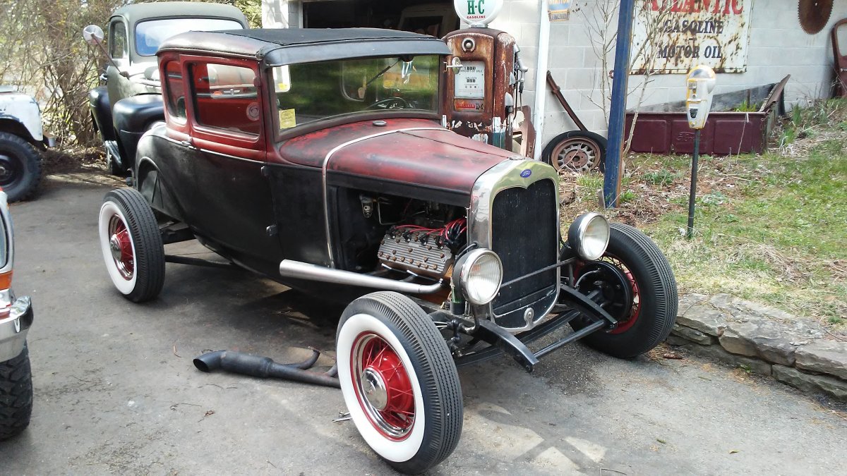

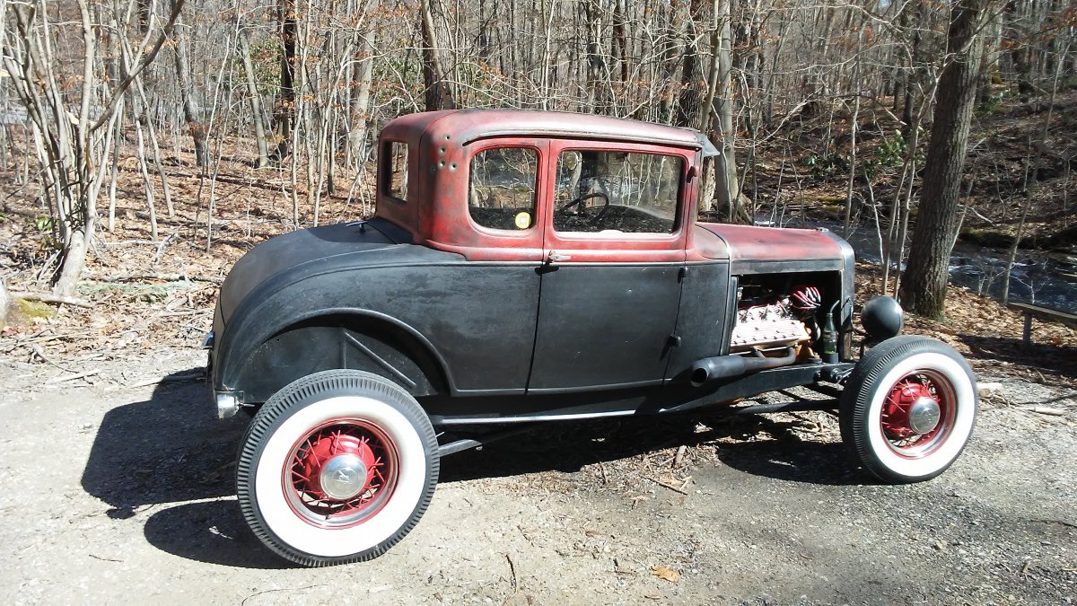

    So far I racked up 700 miles and finally all the bugs are working out of it....
    Some of the recent ****.....
    Shortly after re***embling it I needed to replace one of the head gaskets due to a minor leak (the fire ring of the big bore copper gasket on the p***enger side was directly on a small flaw in the head surface so I used a stock felpro gasket, so if anyone knows where I can get small bore copper gaskets let me know).
    I had to replace the weights in the distributor and try a bunch of springs to get a proper advance, I also had to limit the advance so it was more flathead appropriate.
    The solid core plug wires interfered with my dwell meter so I made up a shielded but cloth covered set.
    The va***e wiper motor broke so I tore it apart and fixed it with some canabalized parts from a chevy truck va***e wiper motor.
    Radiator would slowly puke coolant so I made a puke tank out of an old coke bottle and made a fan shroud as well.
    Adjusted the voltage regulator.
    And lastly adjusted the seats for a little better comfort and cut,up some rubber floor mats to fit front and back.
    Hopefully I am good go for a while.... If it behaves itself and I fall in love with it I may do more bodywork and give it in shiny paint job in a few years.

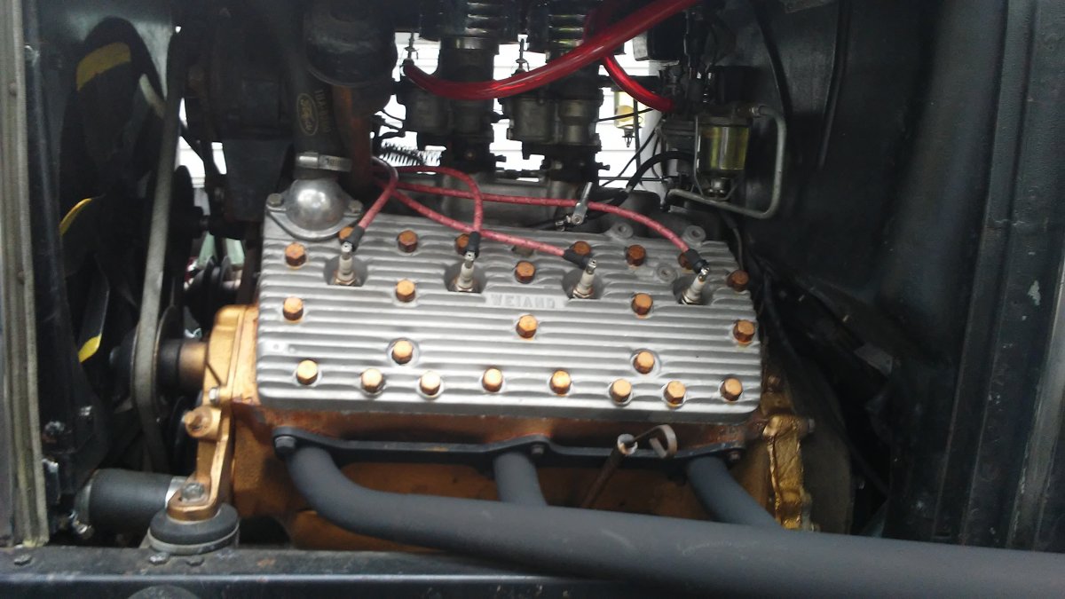

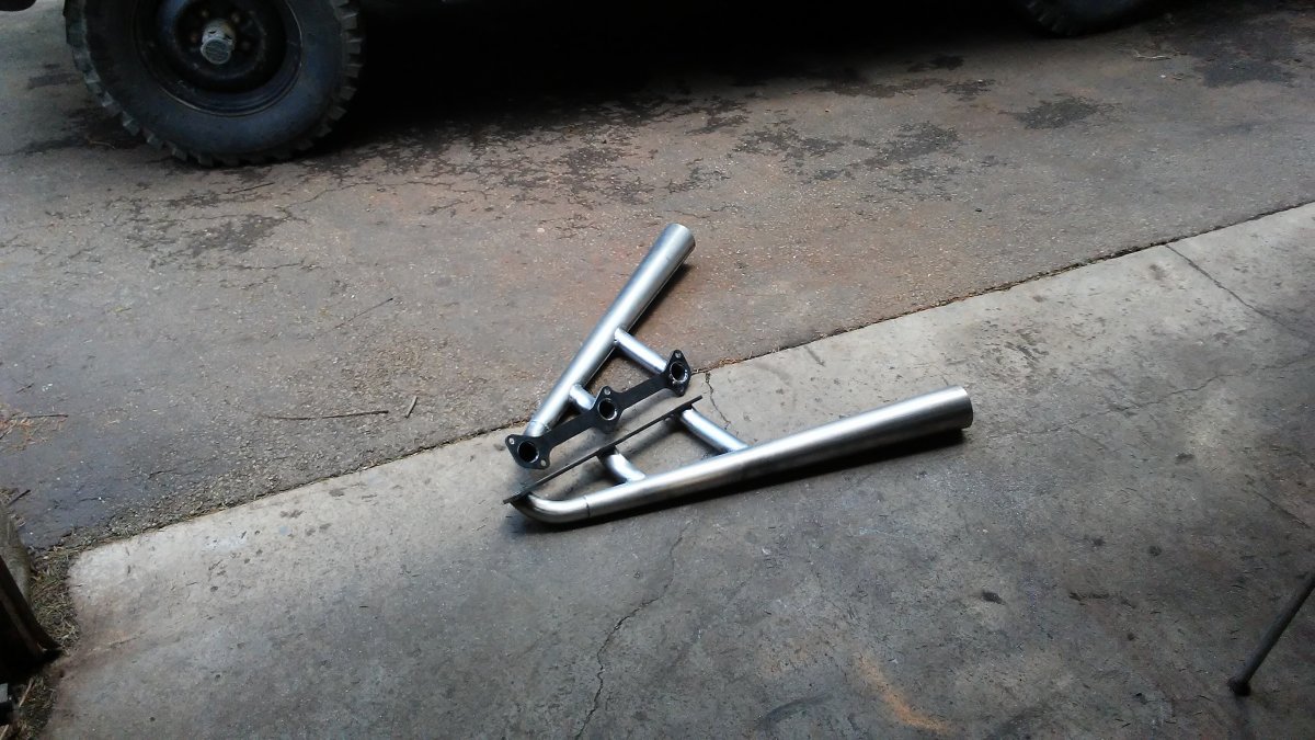

    Today I fabricated a nicer looking pair of headers.... I still have to paint them and install baffles but they look a lot better than the freebies I put on it to get it going.
    A mock up pic...

    The ones I made are a tad louder than the old ones but are working out well.....been driving it a lot this weekend.

    Too many fumes without turnouts so I made a set of turnouts for it....

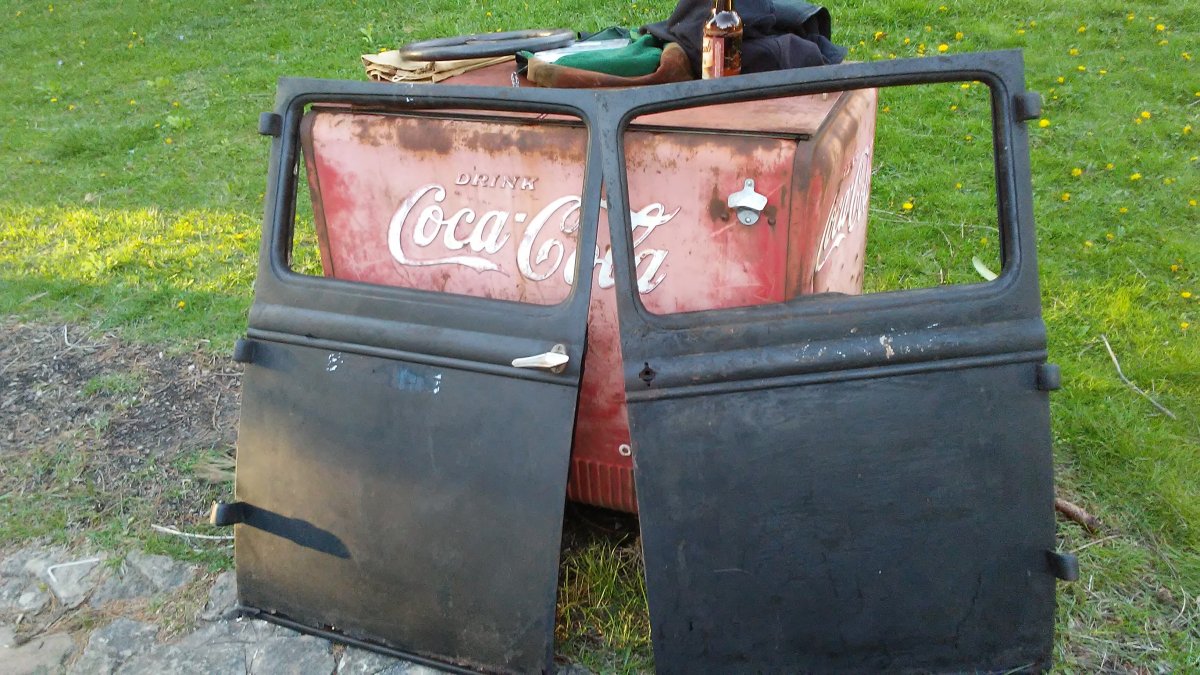

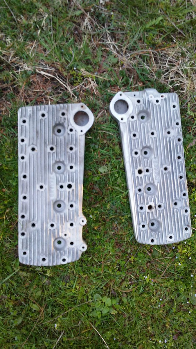

    I had a good day at Carlisle yesterday, I found a pretty decent set of the same weiand heads I have on my car....so I had to buy them as spares since....these don't seem to grow on trees and were priced pretty well.
    I also picked up a nicer pair of doors for the car that I will patch and eventually use when the time comes for shiney paint.

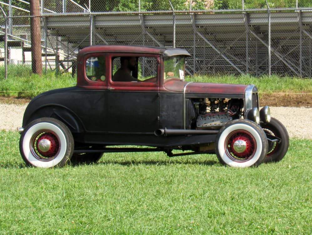

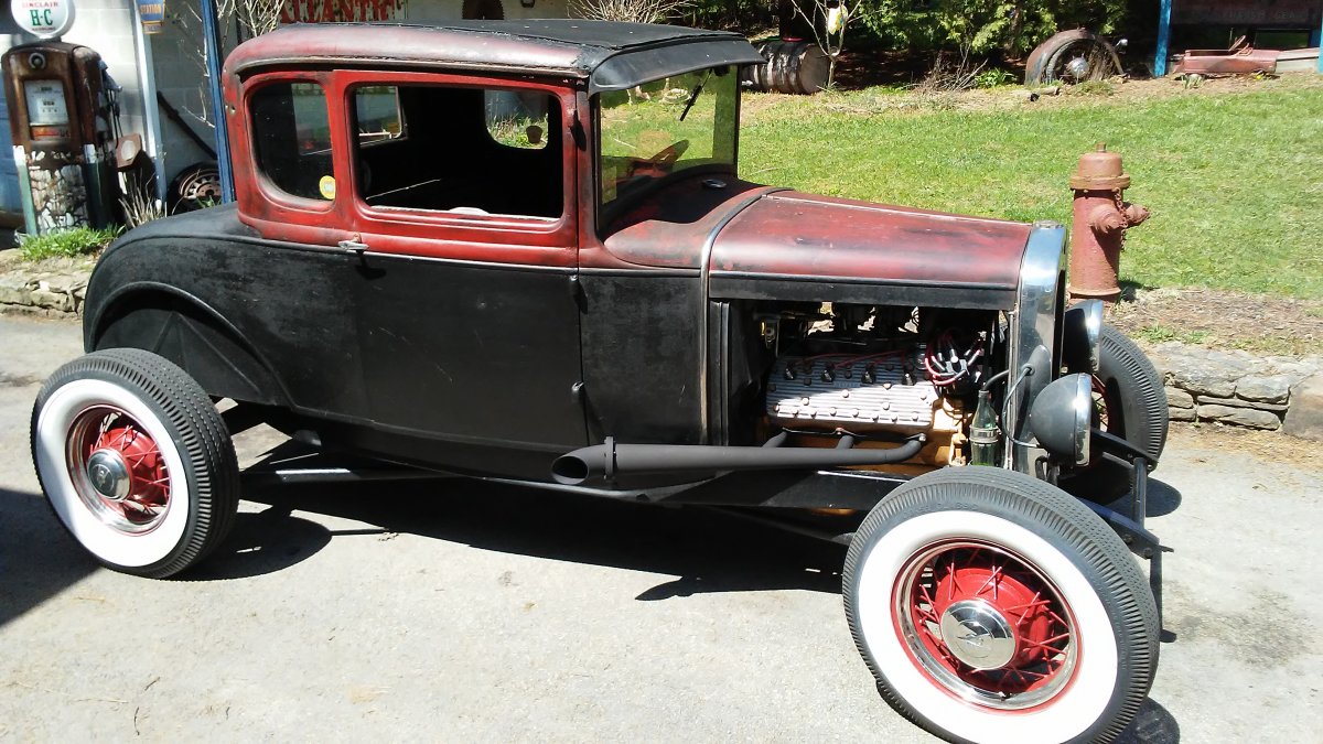

    The car made a 300 mile trip to the jalopy showdown and some track time with zero issues. It got over 20 mpg and lost / burned zero fluids.

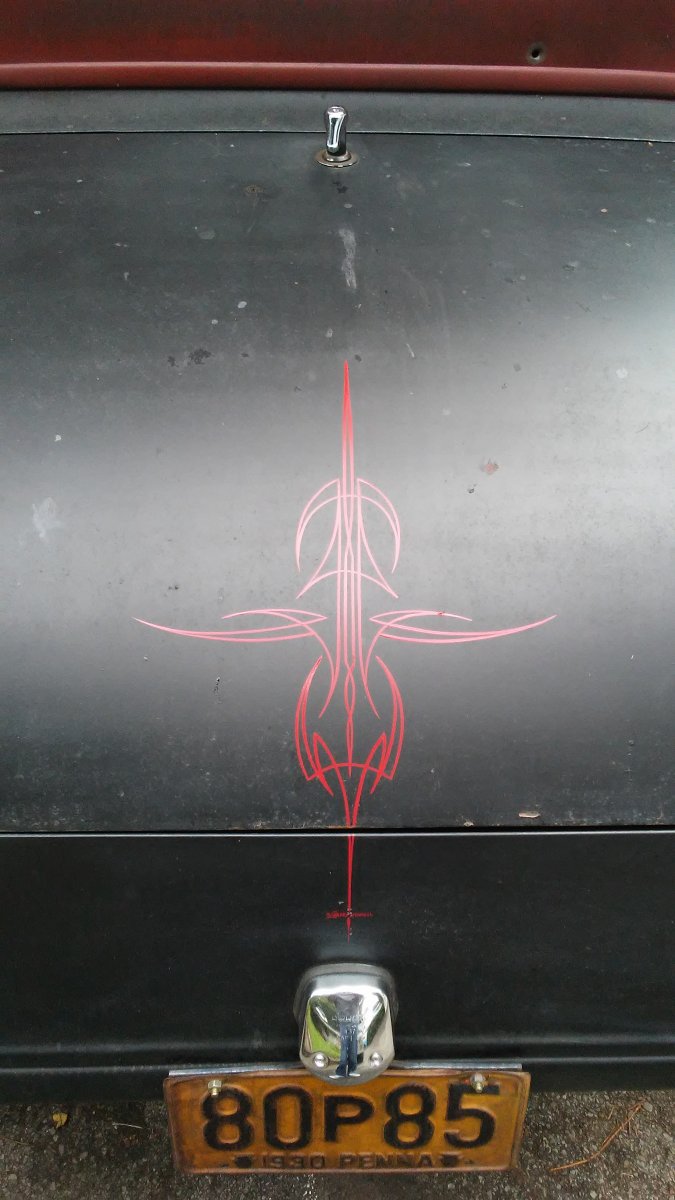

    Recently my neighbor / friend (Casey Kennel) put some pinstripes on it.

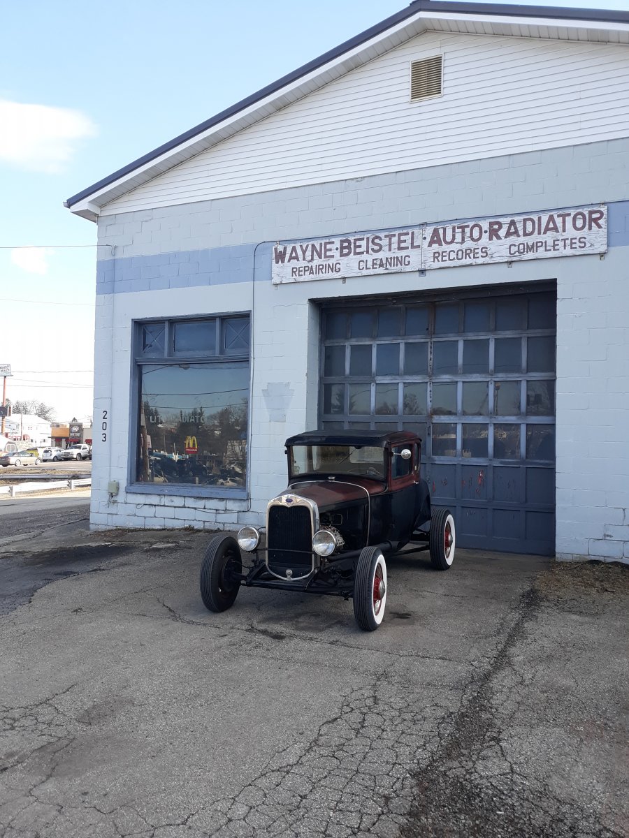

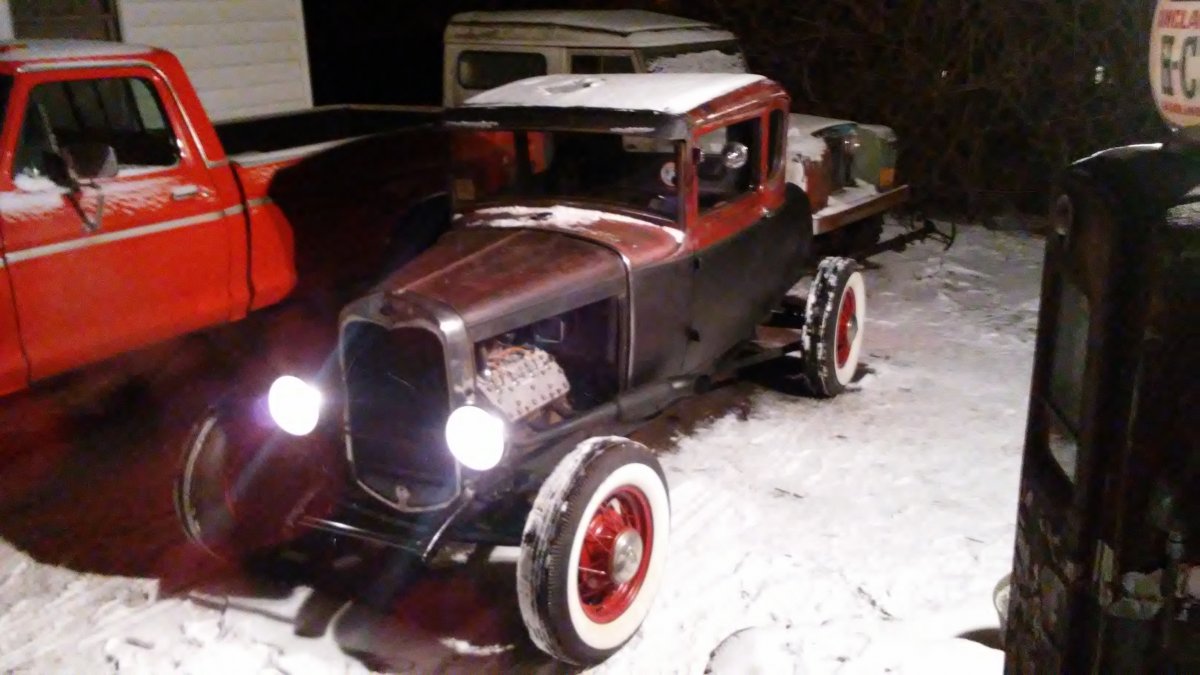

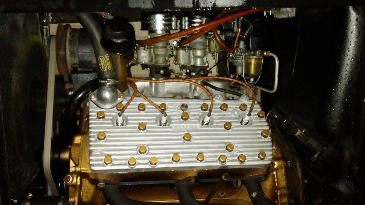

    Been a long time since I updated.... Drove it a good bit this year including some fairly long trips. Has been pretty reliable except I had 2 ignition coils go bad and a starter go bad.
