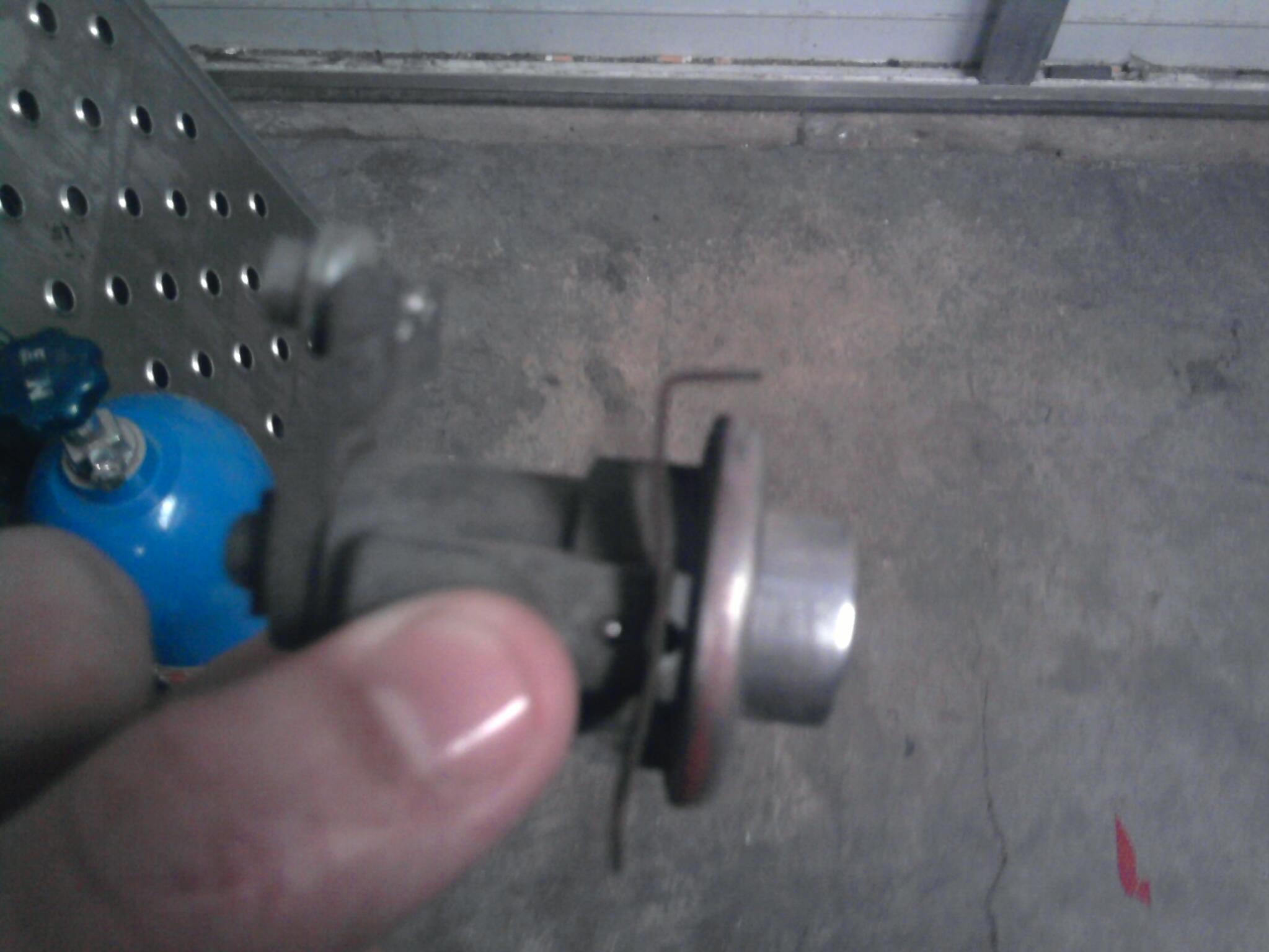

    I like the '46-'48 Lincoln door buttons, but there's no way to lock them.
    So, I either modify the 50's Ford lock cylinders to open the latch and still lock, or use 50's Chrysler trunk buttons. You can get these early cylinder rekeyed easily or make your own key if you're handy.
    Here's a Chrysler trunk button off a '55 Windsor...

    Trunk buttons!? That is pretty damn clever.
