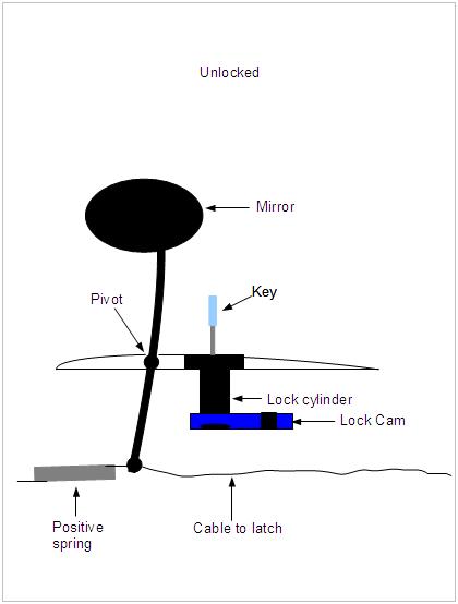

    I may have over done it. I agree with the pull it would be alot more simple. What I was worried about and why the spin instead of the pull was not thinking and yanking the cap too hard and breaking the wire. I guess the 2nd safty wire would stop that too.

    Well, the cable may need to be a rod and the spring might need to come from the other direction, depending on how your door latch works.
