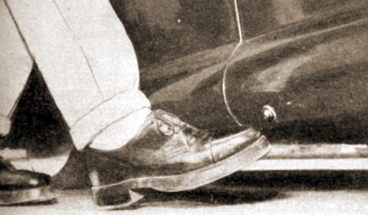

  13. something like this-

    Would be cool to attach a wire to the dummy spotst then push on it and bam the doors open
