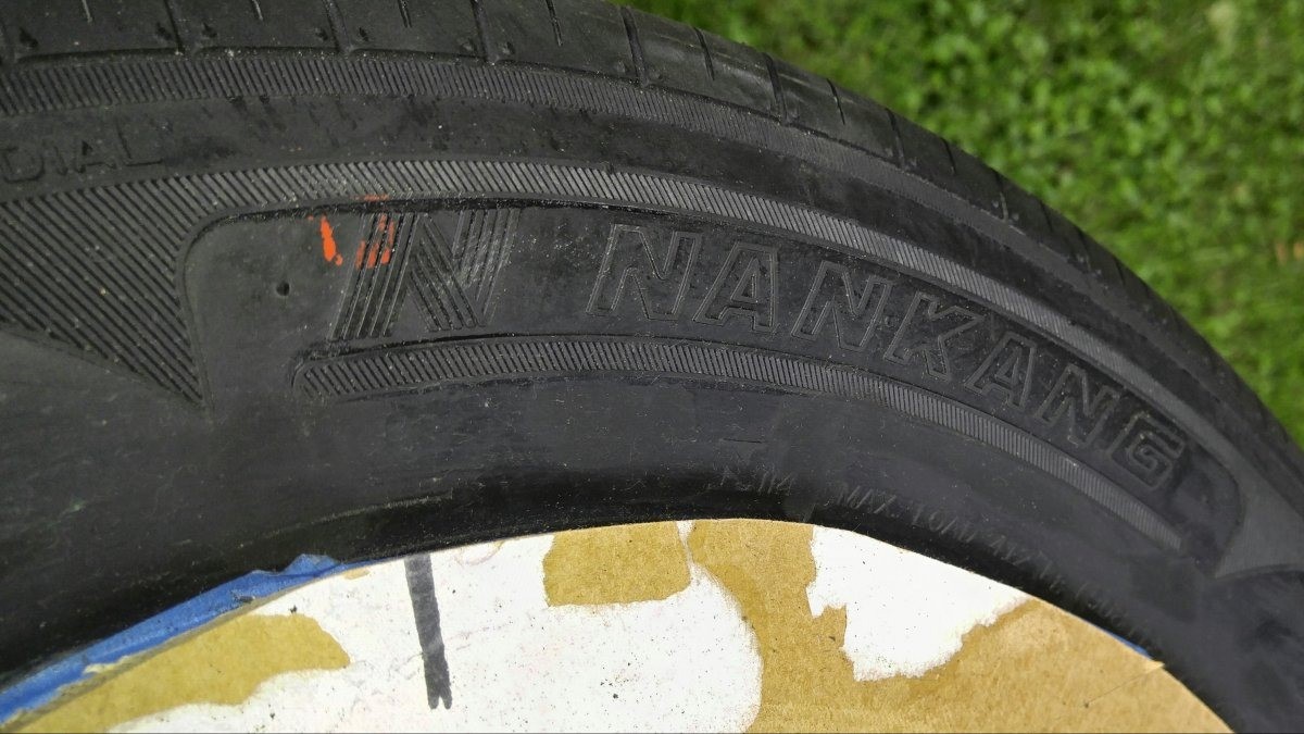

    Here's how I did mine:
    • I practiced on the back sides of my wife’s minivan tires. :eek:
    • Like bodywork, use progressively finer grits but don’t transition to the next grit until ALL bigger scratches are COMPLETELY removed.
    • Wear a dust mask to prevent black boogers and do it outside in direct sunlight. Use white chalk to mark where you started, outstanding flaws, etc.
    • For DOT inspection purposes, don’t remove tire size & DOT markings.
    • The skinny front tires’ sidewalls were far thinner than the big rear truck tires; so on the fronts, I skipped step 2.
    1. Flap wheel on Dremel to remove whiskers.
    2. #80 flap wheel on 4.5” grinder:
    3. #60 sandpaper on jitterbug:
    4. #220 sandpaper on jitterbug:
    5. #400 wet sandpaper on jitterbug:
    6. Hand-held green scotchbrite
    7. Wipe down with Armor-All.
    More details on my '28 Tudor build thread. Hope this helps.:cool:
