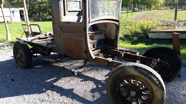

    [​IMG][​IMG]
    Is it a mix of T and A stuff? Frame tank cowl etc look A...but the cab back screams T....

    Have to get my Ford truck book out to confirm this, but that looks like a 1926-27 TT truck cab. You can swap in a 28-29 cowl to really confuse people. frame looks to be AA truck, no idea what the axles are. Bob

    Bottom of the cowl panel is curved though...aren't the TT's straight...

    Excellent point, maybe we are looking at an aftermarket cab that used a 28-29 Ford cowl, but that one belt molding rib on the post is odd. Bob

    Agreed. That's what I can't figure out is that extra belt line....

    Nope. I drive a '29A Closed Cab pickup. Not a single part of that cab is a 1928 or 1929.
    Not even the cowl posts. The lower bead that runs from the cab corners, across the doors, also continues onto the cowl post, and around it. This bead, and the other one does not exist on a 1928/29A closed cab. Cowl detail.JPG
    Also, the 1928/29A ccpu used the leftover doors and cowl posts from the 1927 parts bins, so "all-new" is debatable.

  11. Is the inner door structure etc. Made of wood? Here in Canada, alot of our model a trucks (AA for sure, but not sure about the pickup) looked alot like that. Every big model a truck here I've seen (and I've seen quite a few) were different than the normal closed cab that you see from the USA.

    I would bet it is made out of a sedan.
