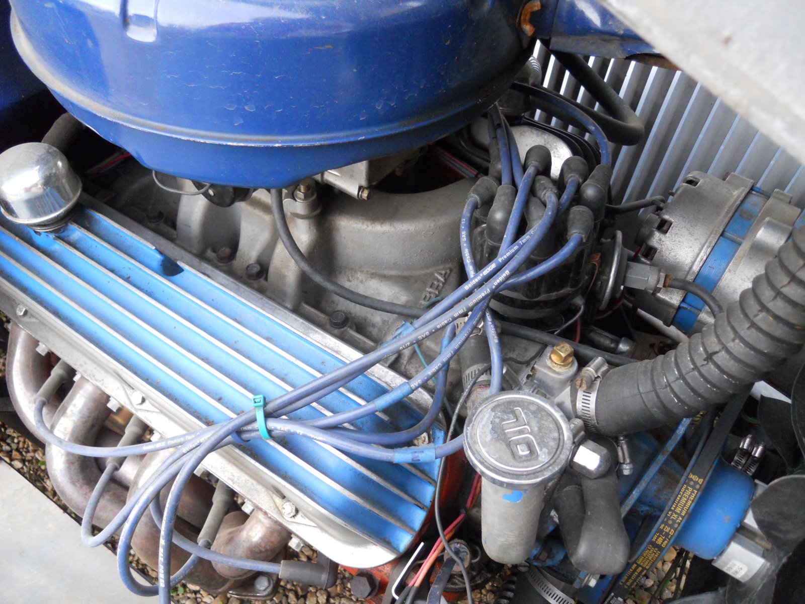

    Several years back, I bought a Model A coupe off Ebay. It had been chopped, was in bad primer, and sported extra wide Jackman wheels with 60 series Wide Ovals. It could not have been more ugly. Pictures were taken as it sat in the air on a lift. Anyway, I ended up with the ******. Body is still the same, but I made it road worthy, comfy, and fitting of the era in which it was originally built, that being in the late 40's, very early 50's. It had a flatty 'till '68, then got a 289, using over the counter 289 to late flathead conversion mounts. I finally looked close at the mill. Something was different. It has an aluminum water pump spacer with a crankcase breather. The carb is a 271HP Holley, and the intake is the best catch. It is made by Buddy Bar Castings, and is one of a limited number made. As I understand, Shelby had enough cast to supply the 1964 and 1965 260 and 289 Cobras, with a few as spares. It has no numbers, anywhere. I was going to take it off, but it ran to good, so on it has stayed. I did install a later, smaller Holley. The engine is a 5-bolt 289, making it an early '64. DSCN0812.JPG A at Bonnie.jpg

    Have you confirmed that that engine is a 289? Really the only way to tell would be to measure the bore. It seems that early 5 bolts could show the same numbers for a 260 and 289 block. I may be wrong about that. I do know for sure that the Hi-Pos had the same casting #s as regular blocks....
    Anyway the timing cover oil fill and crankcase breather are all features of 1962-63. By '64 the oil fill was moved to the valve cover ( the timing cover still had the hole but it was plugged) and the crankcase breather was replaced by PCV from the valve cover.
    Now parts mat have been changed to allow the use of those valve covers or intake...stuff like that but....If that engine came from the factory with "timing cover oil fill" and a crankcase breather tube behind the carburetor and it indeed is a 289....
    It's a 1963 289.
