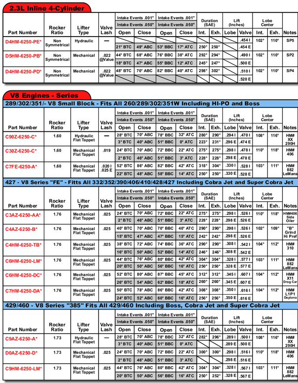

    Holman and Moody still offer the 1969 "Cobra Kit" cam ** 290H hydraulic.
    http://holmanmoody.com/cams.html
    The old Crane Fireball 294 is basically a copy of the '69 Cobra Kit cam...

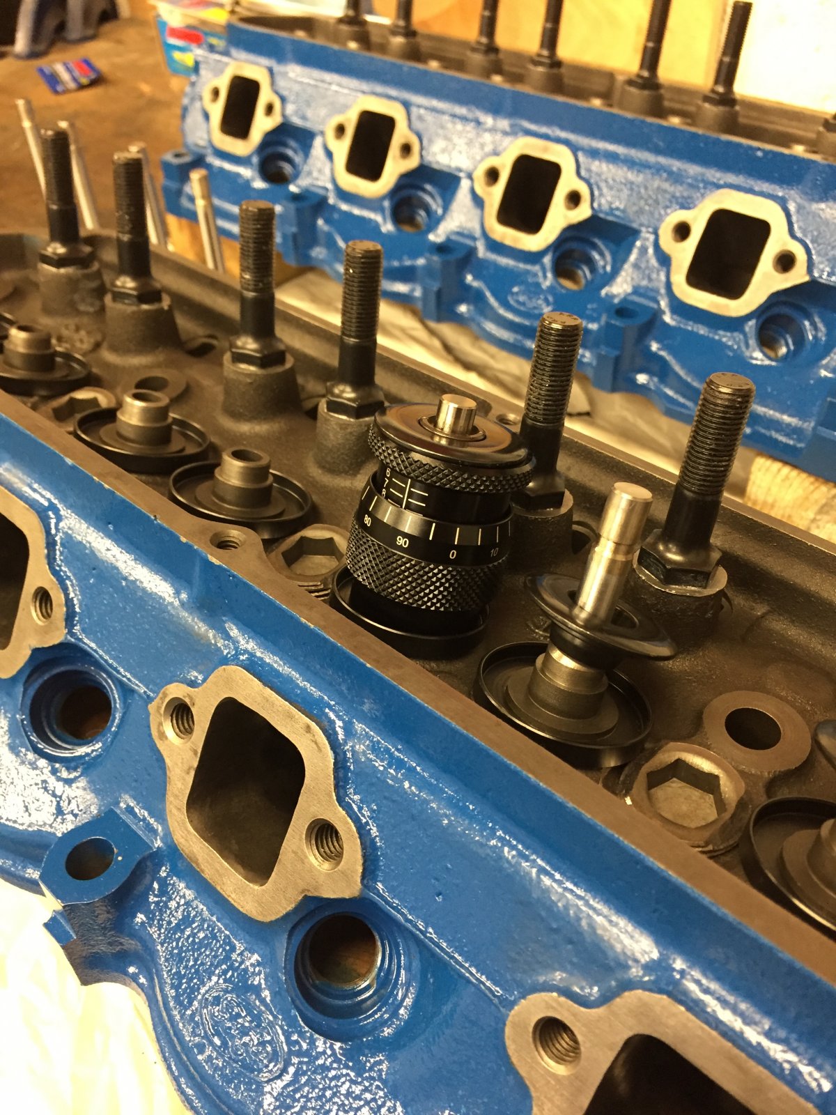

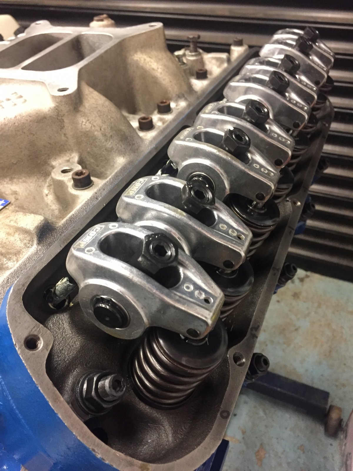

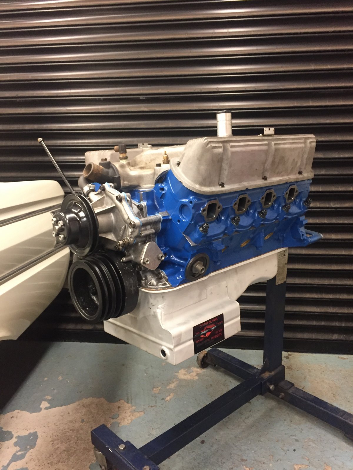

    My 260 I put together last year.
    A lot of love/hate and frustration putting together one of these.
    Deuces, Tman, loudbang and 2 others like this.

    Nice mill! ;) Frustrating, as in valvetrain geometry? I’m ***uming that was the case by your picture uploads. I would go black engine paint with the red baldy valve covers but that’s just me. :cool:

    No, just parts limitations.
    No piston choices, so your stuck with cast, low comp, fat rings.
    Any aftermarket head will fit but they all generally have too big of a combustion chamber for a 260 and 2" valves which will hit the bore, 1.78" inlet is your limit plus the flat top pistons give restrictions on valve lift/cam choice.
    Of course you can "custom" on any parts but, you know, is it worth it?
    Crank and rods are the same as a 289.
    Blocks are the same apart from bore size and can't be bored out 289ci.
    Late 260 heads are the same as early 289 but with a smaller combustion chamber.
