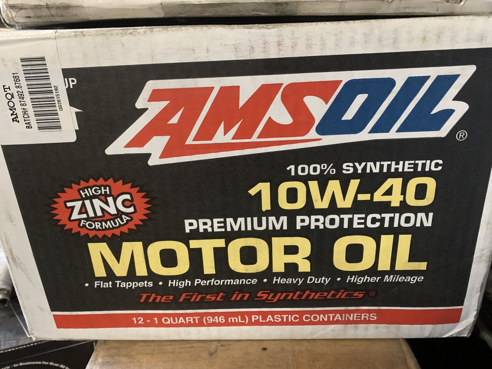

    I’ve been using Amsoil high zinc in my solid lifter 265. D3A45969-4AF5-4BF0-926A-018ADE0FC33A.jpeg
