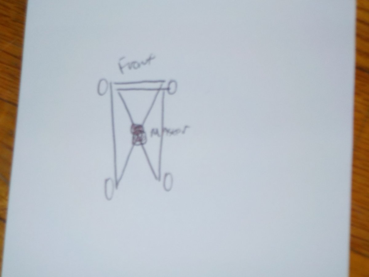

    Volvo did weird things with brakes in the 70's. like one set of lines went to the right front and left rear and the other went opposite, or some other crazy combination.

    Volvo is 108 MM bolt pattern. They do not appear to be Volvo calipers. Volvo used Split dual master. Two fronts out from each, one to each front, then each master ran to one OPPOSITE rear. Each reservoir had 3 lines out. Lose one line, still have 75% braking power. ( both front, one rear). Think two overlapping triangles. See below.

    I knew it was some crazy combination. I tell you one thing anyone who wants a good old beater get a 70's Volvo. drove mine for 12 years
