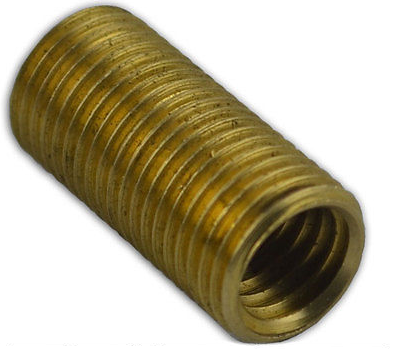

    Something like this with internal (Female) and external (Male) threads? You just need to know your threads, SAE or metric, or BR*** THREAD REDUCER/ADAPTER/INSERT
