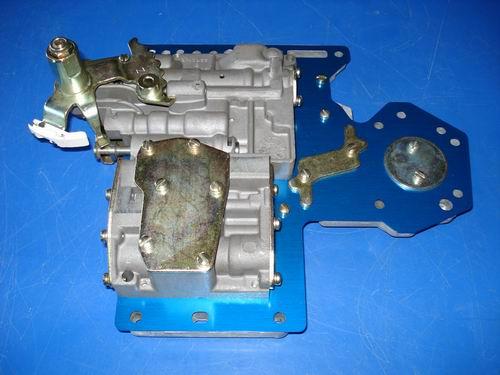

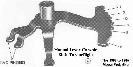

    Now, since I am a nice guy and I would like to see your project come to fruition because I like cars more than people, here are some simple photographs showing the shift pattern at the manual lever. Let me say that again slowly so it has time to absorb through your thick, neanderthal skull. M-A-N-U-A-L L-E-V-E-R. That is the little lever coming through the transmission case, on the driver side, above the pan rail that controls the valve body via the gear selector.
    (The gear selector would be the rod with the handle sticking out of the right side of your steering coulumn, or, what is commonly known as the floor shifter. push****on transmissions do not use a M-A-N-U-A-L L-E-V-E-R. I hope this clarifies some of your difficulty)
    Now, if the M-A-N-U-A-L L-E-V-E-R is pushed all the way forward in a clockwise fashion, the transmission will be in first gear. Rotate it counter clockwise until it stops, and it is now in park.
    Damn boy, someone even posted an instructional manual giving you specific directions and, obviously, you did not read it or you would have thanked the man.
    Anyway, since you are entirely too lazy to do your own homework and then turn around and bash those who do it for you, here are some pictures that clearly illustrate how this works. The picture of the entire valve body has the lever in the park position, as evidenced by the location of the letter N indicating where the neutral position is. I hope you get it now, because I REALLY don't want to hold your hand anymore AND draw it out for you in crayon, which, visually speaking, I think may be more suited to your level of intellect.
    Both picture perspectives (please know the meaning of that word) would be from the top rear of the transmission.
