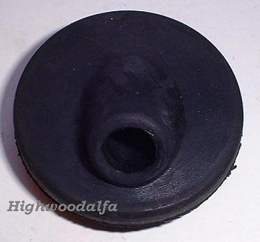

  14. There is a problem with using a regular "run of the mill" gromet. A typical gromet is designed to have something go "straight" through. Most shifter cables, especially the B&M and/or Hurst cables, go into the floor at about a 30 degree angle. With that much of an angle you need a boot style piece similar to one found on newer cars with a floor mounted parking brake.

  17. You could also take say a 6" piece of oil or fuel line, slit it length wise and put it around the cable. Now put the cable wrapped in the small section of line through the grommet. A black plastic wire tie on each end to hold the hose in place.
  18. This one looks like it might work.
  19. 32 hudson

    Thanks for everyones input. Definately need what ever I am going to use before making the hole. The one in post 18 is simialar to like a second generation camaro /gm type with an angled hole. I think my hole will be on the curvature/side of the trany hump.
