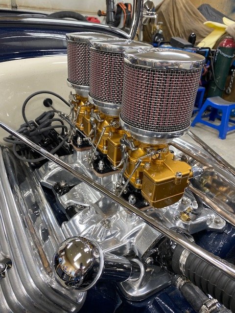

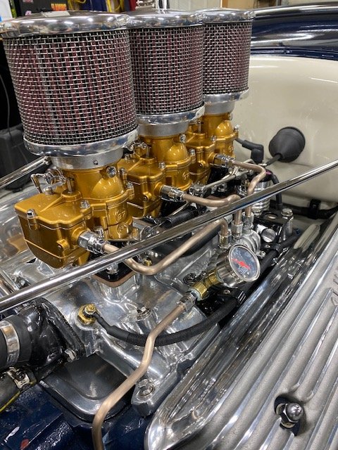

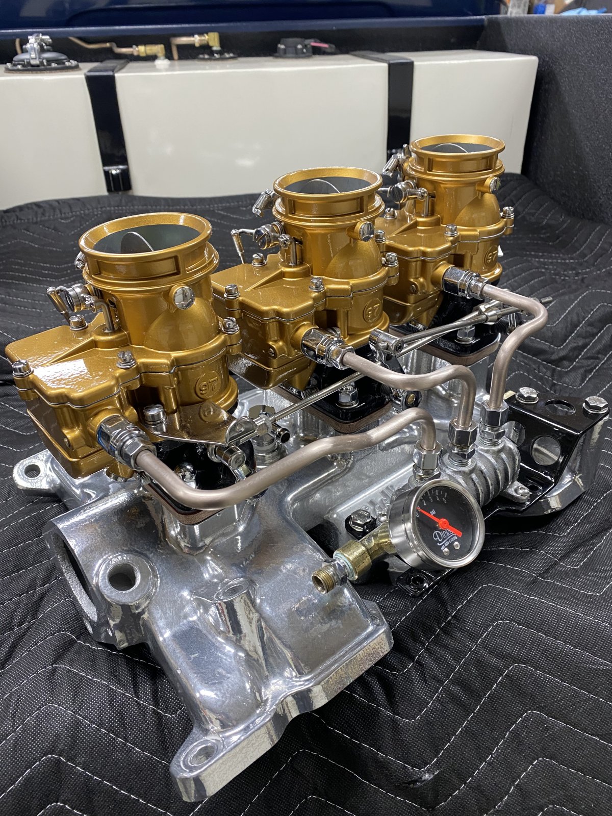

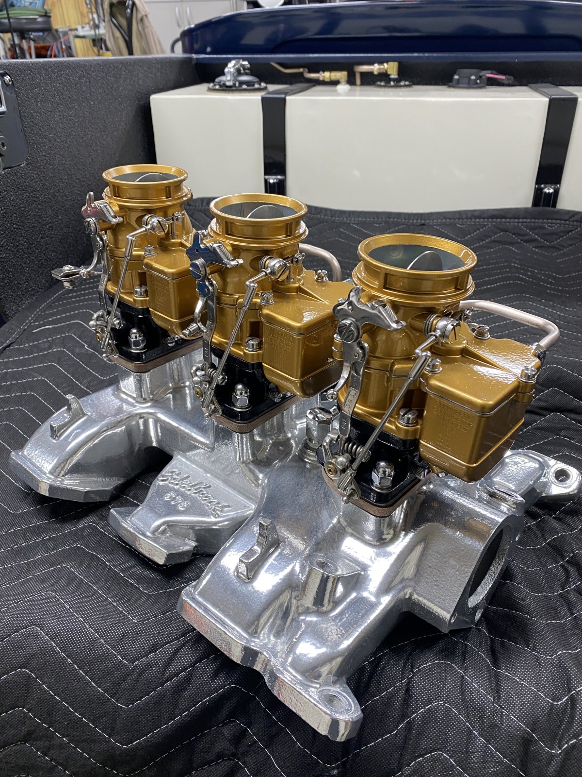

    Or you could do what I did and have Clive paint them gold. :cool:
    IMG_4569.jpeg IMG_4571.jpeg IMG_4570.jpeg IMG_5023.jpeg IMG_5027.jpeg image1.jpeg image0.jpeg
