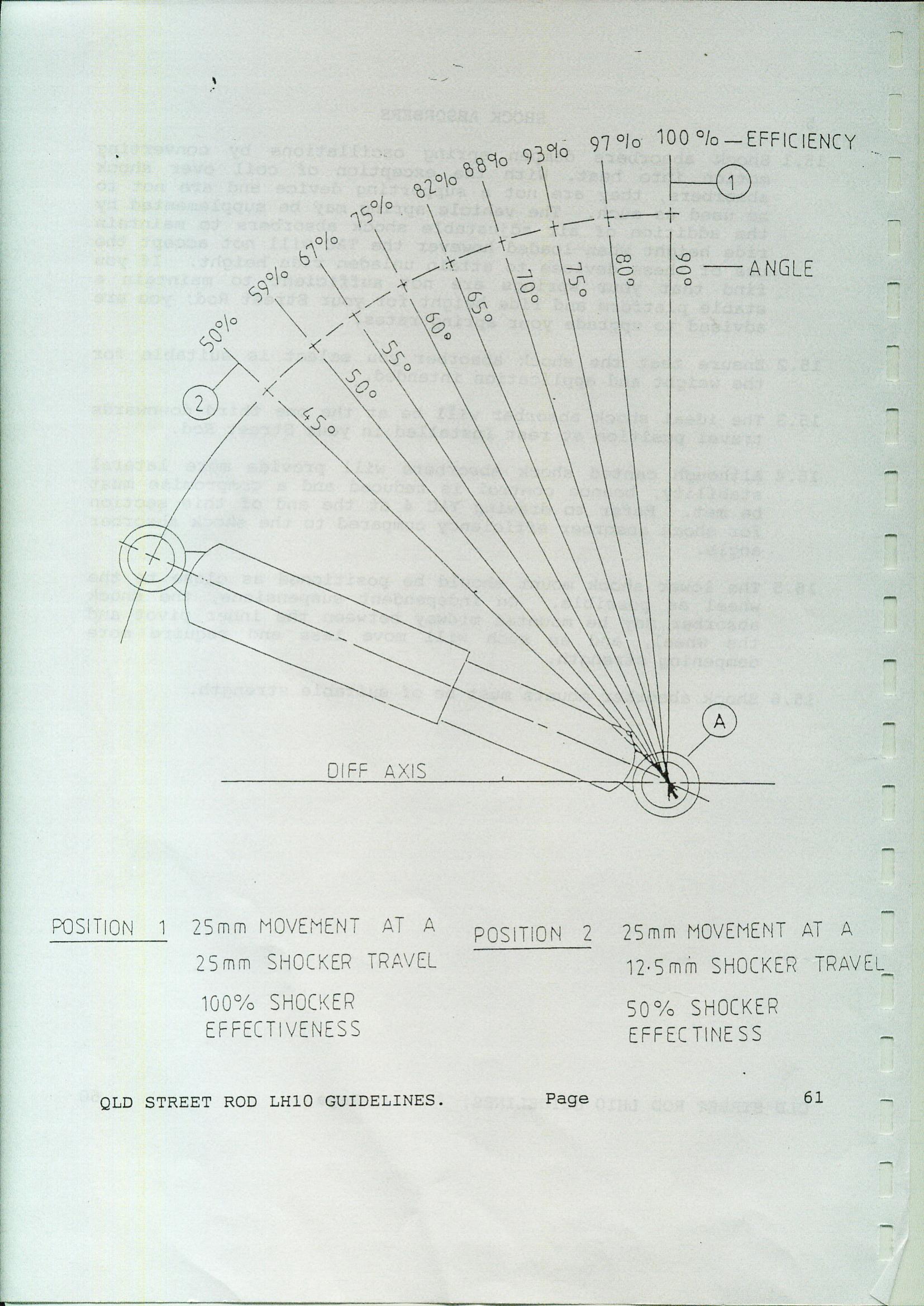

    Shock absorber efficiency is directly related to shock angle, the further out they mount and closer to the wheel, the more effective they are. Canted shocks provide lateral stability. IT's all a bit of a compromise.
    Ideally a shock will be at 1/3 downwards travel at rest. Perpendicular is 100% efficient (Stiff), mount them at 45 degrees and they are only 50% efficient (Soft).
    Staggering shocks, fore and aft controls differential wrap and axle hop under acceleration and braking, one shock is compressing whilst the other is extending. 30 degrees is the practical maximum (Canted) angle.
