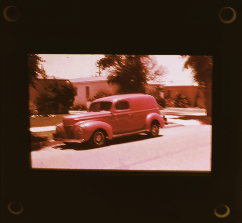

    Hello,
    My first 1940 Flathead sedan delivery had regular tube shocks as the guy who built it was a good hot rod guy and he did not want those old Houdaille Shocks, so he had new Monroe shocks installed. They looked nice and handled quite well. It was a well set up sedan delivery. The shocks were heavy duty as it was originally set up to hold a 348 motor. The 348 was in there when I saw the sedan delivery for the first time. but, by the time we bartered to sell me the sedan delivery, it was a lower price, but no 348 c.i. motor.
    Jump up many years after college. My wife and I were looking for a station wagon or sedan delivery for our business. Up pops a 327 powered 40 Ford Sedan Delivery, painted almost like my high school Flathead Sedan Delivery, but a little bit darker orange-red mixture.
    It was more powerful, but, it was a project to be sold. It drove ok, heading for our small apartment, but at least it was running. By the time we got it home, I could see it needed a lot of work to get it safe for us to drive it daily and for our planned long distance road trips ahead. My wife liked the sedan delivery and it allowed us some privacy if we went camping or to the beach. So, it was a good buy for the two of us.
    She tried driving it down the coastal highway and only got down 15 miles. We had to turn around and go back to our little apartment. The front end was shaking and doing other things, drifting back and forth and bottoming out on the slightest of bumps.
    The handling needed a lot of work and I tried, but we needed expert help. So a friend who was responsible for setting up our 1965 El Camino for balancing and alignment had just moved to the OC and his shop was close by. Upon seeing what was what, the owner took the front end apart and started his technique.
    The first to go were the Houdaille Shocks. They were ok, but bottomed out with the extra weight or were just old and worn. The shop owner chuckled at the sight of those old shocks. We should have kept on for a coffee table conversation starter.
    Jnaki
    He had our 327 powered 40 Ford Sedan Delivery for several weeks and went through the complete front end for repairs, replacement, mostly replacement of parts and took his time setting up the whole front suspension set up. That was the key as we got new tires shaved, balanced and mounted, so that part was ready.
    With his whole front end replacement and fix, the brakes were completely cleaned, spun and replaced for stopping power. The shocks were changed over to tube shocks and handled so much better overall.
    We drove it for thousands of miles together and my wife drove it many times by herself to various places. She loved the sedan delivery. It certainly had more power than her old Corvair that we gave away to her uncle, who was in need of a car. Once the old Corvair bit the dust, I could not keep my wife from taking off in the 327 powered sedan delivery for short errands, long trips to shopping and visiting friends. She wanted to drive it, not just sit in the p***enger seat.
    So, yes, we were old car fanatics, but there are some things that just needed replacing for a better build and safety for all. It was like driving around in a brand new car, straight off of the showroom floor from a local dealer. (In this case, it was straight off of the repair shop floor and on the coastal roads...) YRMV
    upload_2024-9-6_3-9-15.png For my wife, it was nothing to drive an hour and a half away to our old house in the Westside of Long Beach for a visit and free meal(s). Why buy a new car off of the showroom floor? Ours took a while, but the project turned into one of the most fun hot rods we had ever owned and drove all over So Cal. Reliable? Turn the key and drive on down the road... ha! What fun!
