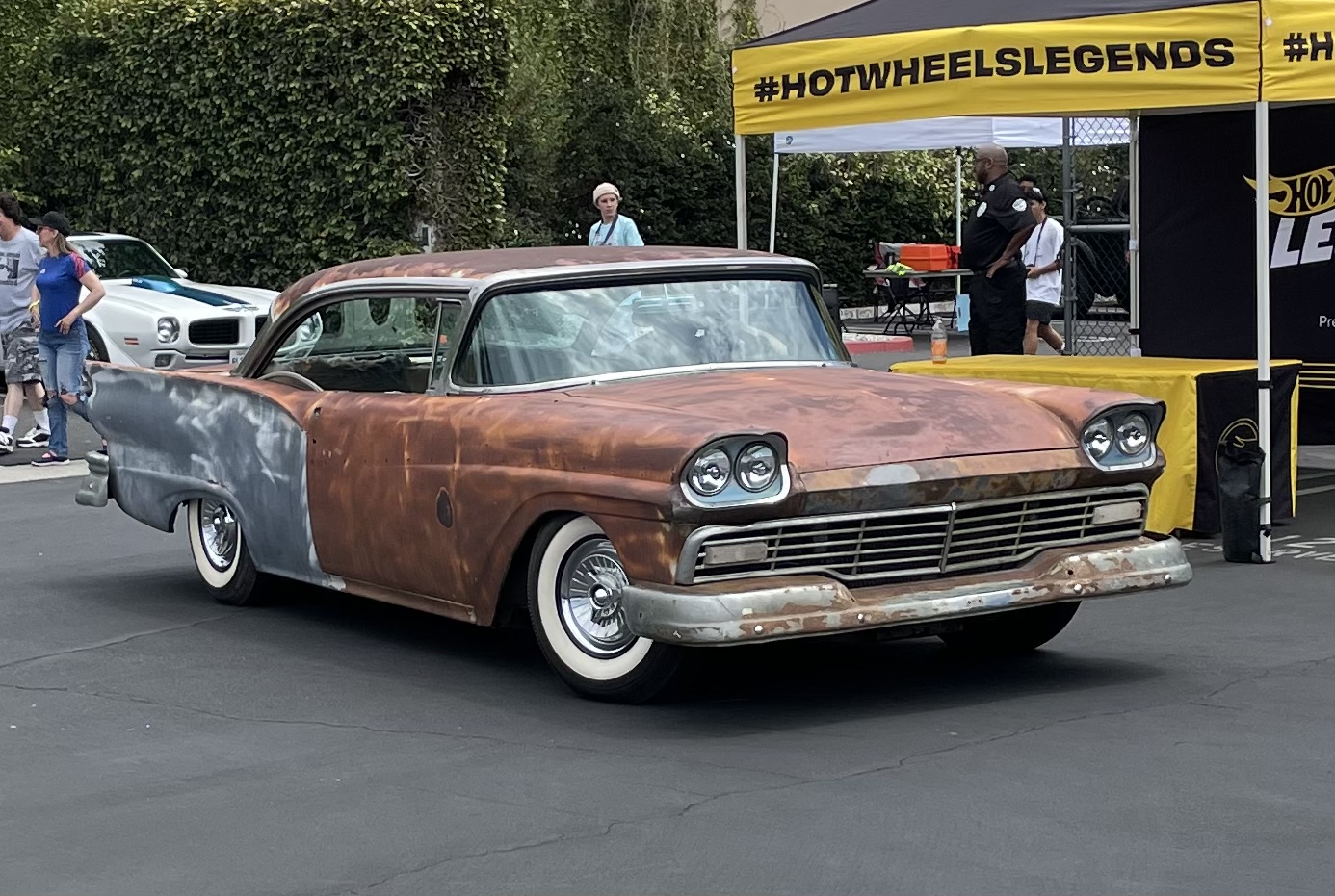

  14. abe lugo
    Joined: Nov 8, 2002
    Posts: 3,343
    abe lugo
    I used the equivalent Delco springs when you look them up on rockauto.
    Then ordered them through autozone or something and got the discount and free shipping. Also the moog were not available at the time
    I also ordered the spacers but didn't need them. I still want like 1" drop further. Kyb shocks but the ride just kind of floats not stiff but there are rough streets in LA.
    double check the spring set when you get them do they match, also make sure they seat in the upper pocket properly.
    I'm running stock tire size 14-800 bias-ply

  17. abe lugo
    Joined: Nov 8, 2002
    Posts: 3,343
    abe lugo
    Been this way 1-2 years, maybe. I think I noted the height someplace, I would say 1/4" to 3/4" at best, but not enough, I actually have not see it go down much.. I have a 351W with a C4.
