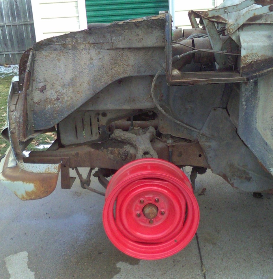

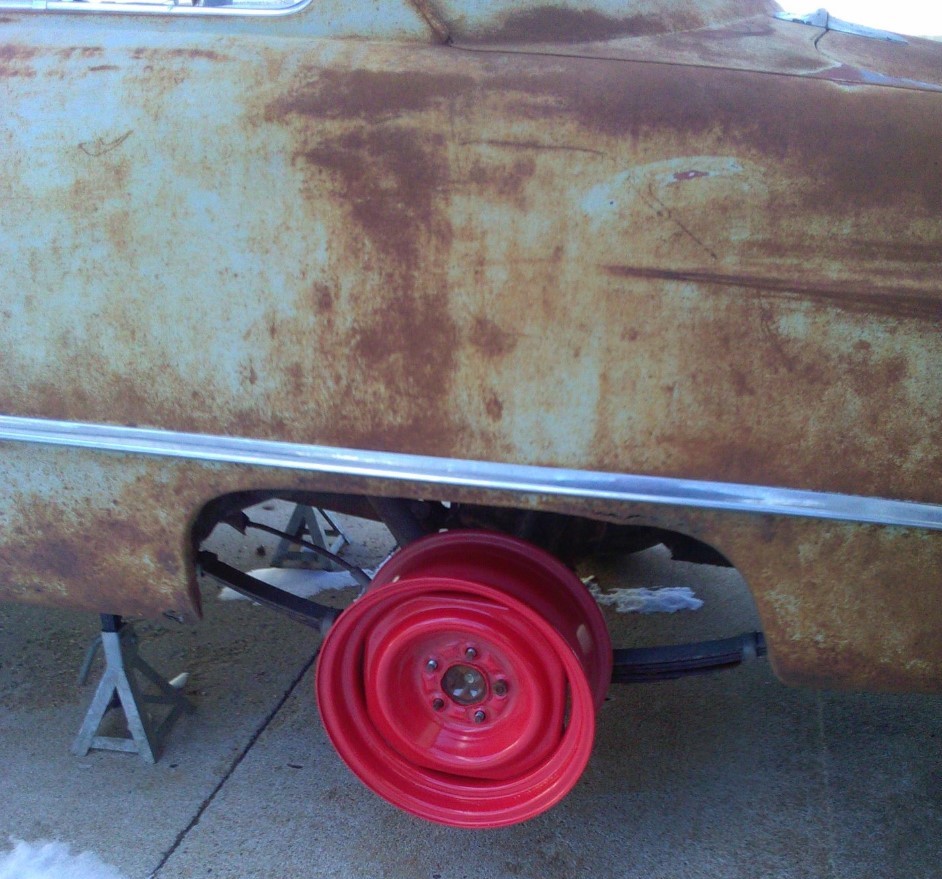

    thumbnail_KIMG0065.jpg thumbnail_KIMG0064 (2).jpg I bought these wheels off a junked mid 80's Lincoln, and had them powder coated a few years ago. I also have a set of checkerboard Lancer caps. The wheels are 15x6, and look like they will fit just fine, so this will be my rolling stock.
  17. 29StudeDude
    Joined: Mar 11, 2017
    Posts: 362
    29StudeDude
    They clear the front hubs as well, so if you need some cheap rims for your Shoebox Ford, the early to mid 80's Lincolns are plentiful. They are only lacking the little nubs for poverty caps. thumbnail_KIMG0074 (2).jpg

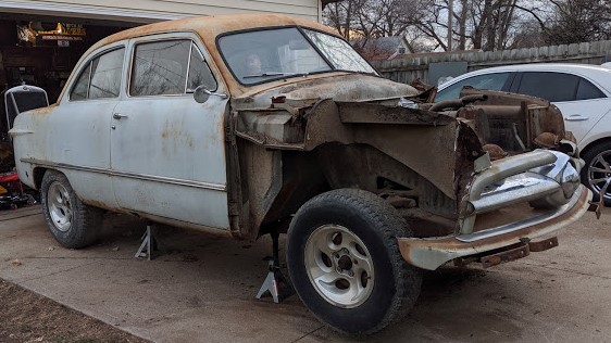

    Rusty pig in a blanket? Lol. Winter sure knows how to slow down progress on the '49! thumbnail_PC150006 (2).jpg

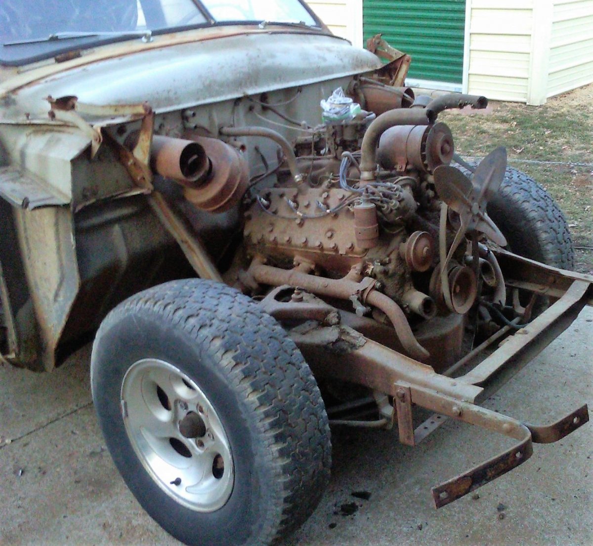

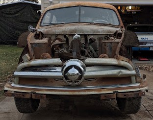

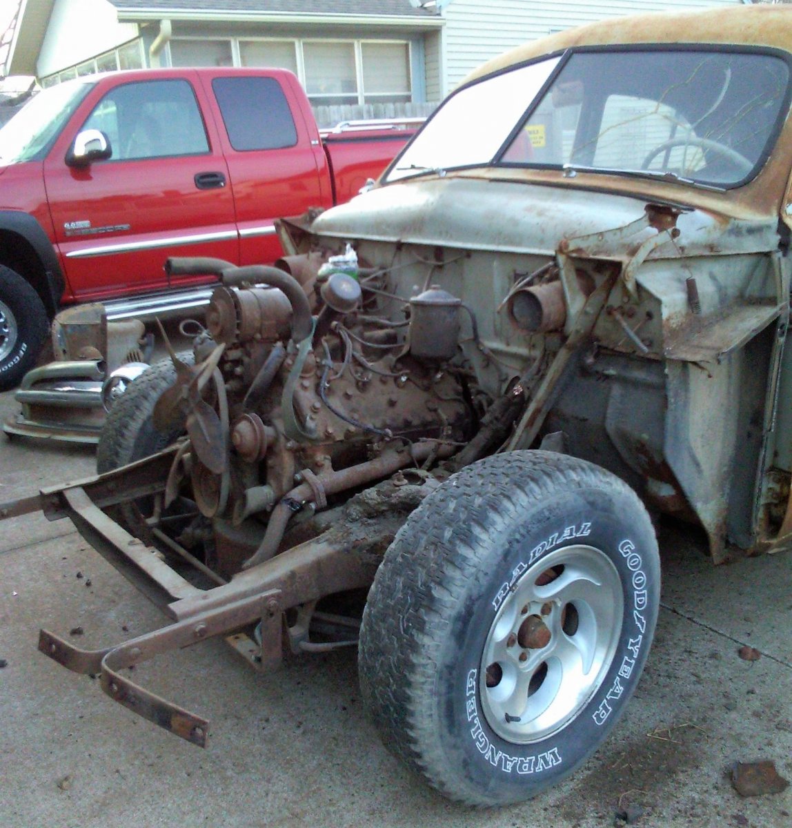

    It finally hit 50 degrees here today, so I was able to finish the front clip removal. Next, the engine and trans. KIMG0086.jpeg KIMG0085.jpeg KIMG0087.jpeg
    1947knuck and loudbang like this.

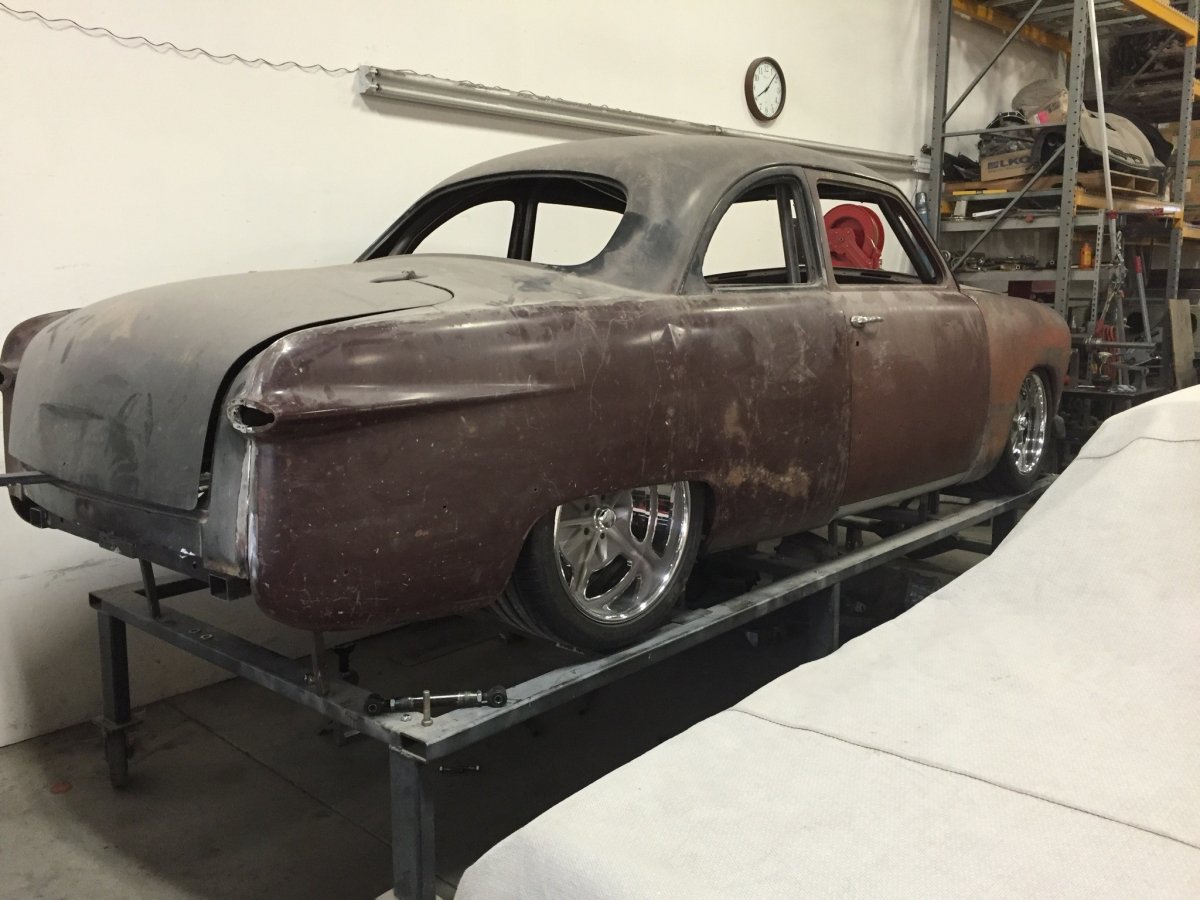

    Duuuuuuuuuuuuuuuude... Nice little 49. The back bumper is a 1950...has the rib across the center of the face bar where 49s were all smooth. I've had a bunch of those shuboxes and I really like em. My son is doing a 50 [with '49 grill] with an O/T 427 cu in, twin turbo LS and a 6 speed.
    Your car is not gray...it's that light green they painted about 17 million shuboxes. My son had a green parts car and I had a green 50 tudor sedan......used the good flathead from my son's car in it and flipped it. My last one was a 49 coupe I bought as a 6 cylinder stocker out in Ashland. I went with a 355 sbc/350 turbo/maverick 8 inch. Flipped the spindle supports, cut the coils a bit and used lowering blocks in the back....incorporated a trans-am 1.25" front sway bar in the front.....was a nice handling car and went like stink. I sold it to a guy in Otumwa , Iowa in '93. Wish I'd kept it.
    If you want I can ask my son if he'd be interested in selling some of his extra front fenders..... Jeremysbox12_15 (2).jpg Rockbox.jpg shuboxRockys.jpg
    Oh, BTW....the chopped 50 is one I got from Davey Schienman in Fremont. He did the chop, sbc and mustang front...nice driving car. I sold it to help finance another project.

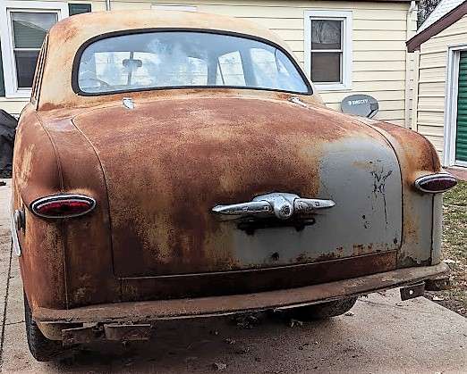

    Thanks for all the info! Nice to find a local Shoebox connection. I am doing a low budget build on mine, with a stock body and flathead. It will be lowered, and have that 50's cruiser vibe. It may look green in the photos, or due to the fading, but I have decoded the cowl stamping numbers, and this car was, and is Birch Gray. I haven't heard of Davey, so I will have to try and find a number. I need fenders, inner fenders, and a hood from a '50 if possible.

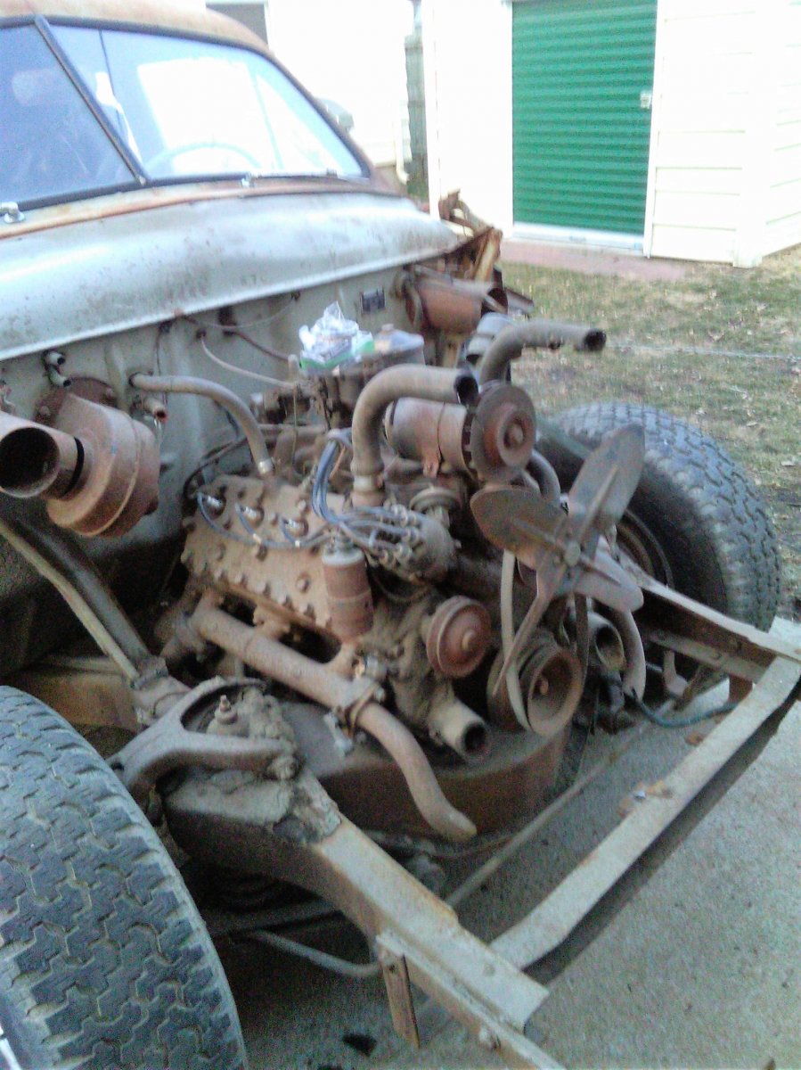

    The stripping of my '49 2 Door Sedan continues! Started removing 71 years of grease and dirt from the frame, removed the generator, fan, and plug wires from the engine, along with removing all the hoses and exhaust remnants. I also removed the front engine mount bolts. Tomorrow, I hope to get the transmission and drive shaft unbolted, so the drive train can come out. The good news of the day, was finding out this engine won't rotate, and is locked up! Maybe that's why it was parked with 49K miles on the clock?! thumbnail_KIMG0090 (2).jpg thumbnail_KIMG0089 (2).jpg

    Before you give up on that engine, you should pour some penetrating oil or other mystery solution down the spark plug holes and let it soak for a couple weeks. You may get lucky.

    Oh, I fully intend to pour some Marvel Mystery Oil down the plug holes and let her soak. The only way I will have to find another Flat Head, is if I find a cracked block upon tear down.

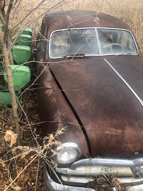

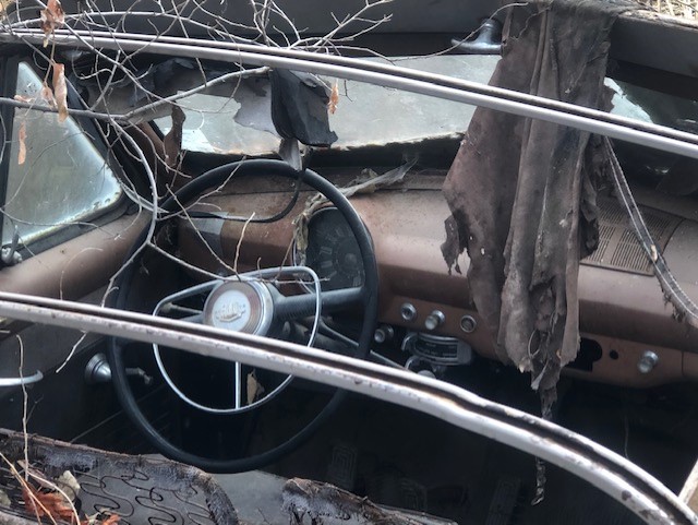

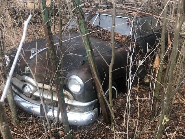

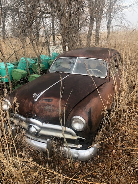

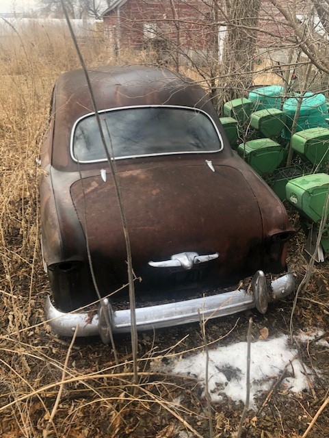

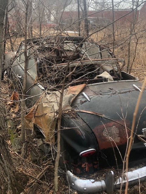

    UPDATE: Haggled my *** off with the owner, and bought the '50 Ragtop, a '50 4 Door, and '49 4 Door all for $1700. With the '49 2 Door Sedan I already bought from him (and featured here), I now own 4 Shoes, all with clear ***les. I will be storing the 2 Door Sedan away, parting the 4 Doors, and going full bore on the Rag top. The Rag top has rust holes in the front lower fenders, the trunk floor, the rear quarters, rockers, and the panel below the trunk lid, The floor is covered in leaves, so I can't see that. It will be a big project!
    thumbnail_image0.jpg thumbnail_image1 (1).jpg thumbnail_image2.jpg thumbnail_image3.jpg thumbnail_image4.jpg thumbnail_image5.jpg thumbnail_image6.jpg thumbnail_image9.jpg thumbnail_image7.jpg thumbnail_image8.jpg thumbnail_image14.jpg
    1947knuck, Squablow, AndersF and 5 others like this.

    Might want to hang on them all to get a good flathead. May make more cash parting out 4 doors. Really nice save. Green with envy on that convert
