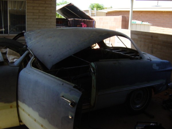

    I started by taking out the complete B Pillar, and Door Top.
    Then I drilled out the spotwelds on the Driprail under the Cutline.
    I cut the A pillar lengthwise, and I took a piece out on the inside ( Windshield Side ) and a bigger one on the outside ( Driprail Side ).
    After that I cut the C Pillar and took 5" off it, and I sliced off the side, 3" above the Driprail over the whole length of the Roof.
    I took 5 5/8" off the bottom of the A Pillar Driprail ( = 4" Vertical ).
    And mocked up the side, with the B Pillar clamped in place.
    More later...

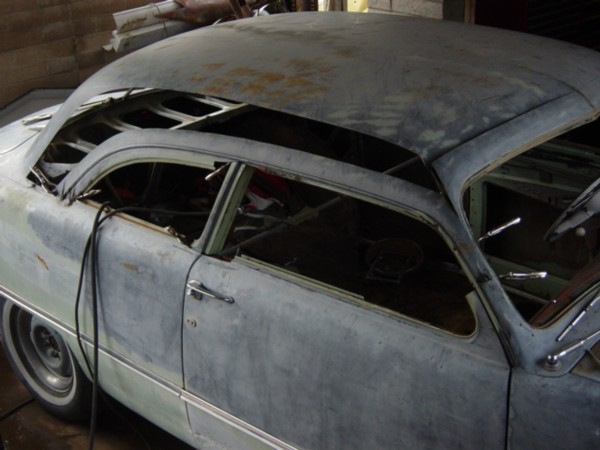

  9. metalshapes
    Joined: Nov 18, 2002
    Posts: 11,130
    metalshapes
    Some more Pics.
    Side tack welded in place.
    B Pillar tack welded in, and the corners from the B Pillar to the 1/4 Window pieced together.

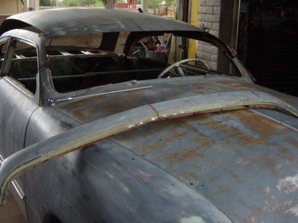

    And some more pics of the Shoebox...
  28. southpaw-customs
    Joined: Jul 19, 2005
    Posts: 464
    southpaw-customs
    Great thread ,thanks for sharing. The shoebox is looking great.
    morebel
  29. metalshapes
    Posts: 11,130
    metalshapes
    Cut out the Driver side...

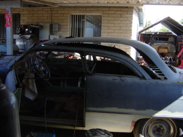

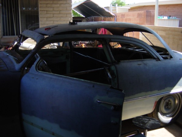

  30. metalshapes
    Posts: 11,130
    metalshapes
    After shortening the A and C Pillar, I tacked it back in.
    Cut the B pillar to size, tacked it in as well.
    Widened the Headerpanel, clamped it to the A Pillars.
    Clamped the top of the P*** Side Door in place.
    So I could check the Height of the Windshield, and how it compares to the height of the Door Gl*** ( The Windshield is Chopped 1" less than the Doorgl***, 3" instead of 4" vertical...)
    And check all the angles.
