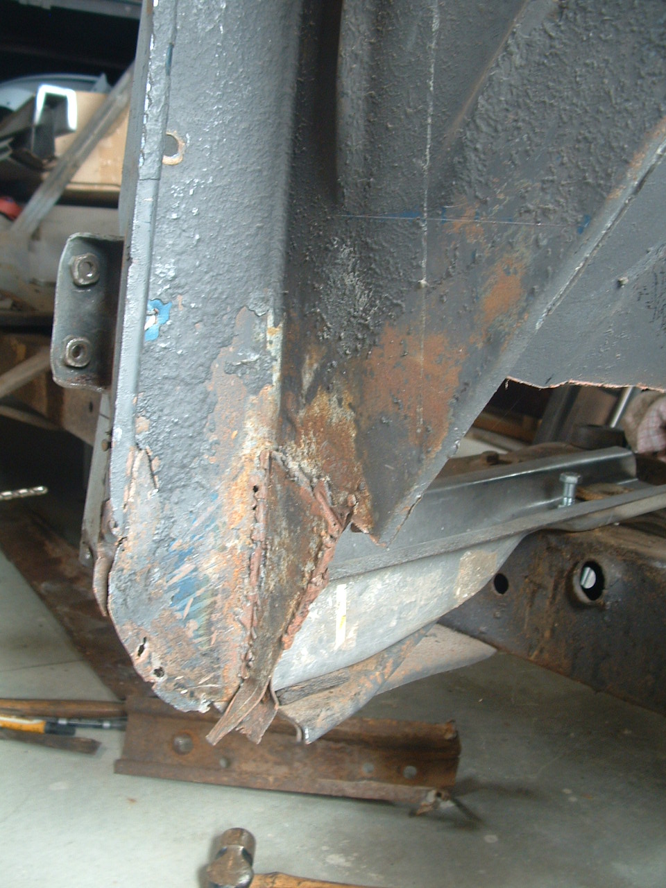

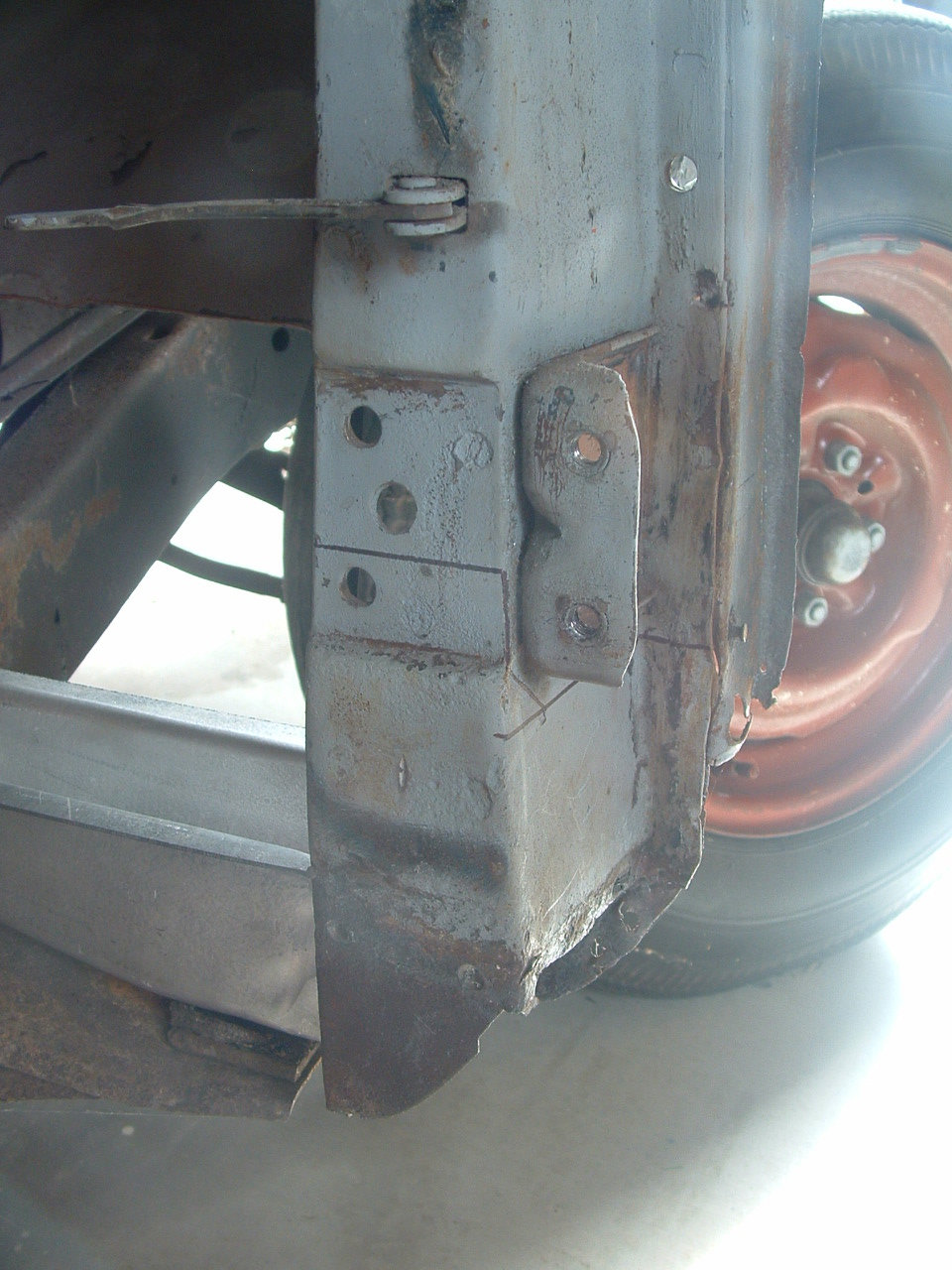

    Been messing about with the front corner today. Still havnt got myself a TIG so im spending time going through and getting everything lined up. First off I set up the front body mount. I have shown the measurement of 137 mm as a reference only incase someone has no datum to work from. I drilled the inward mount hole to 3/8 (the bolt is 3/8 unc) but can enlarge it later if I require further adjustment. I also went through with a 3/8 starter tap and cleaned up all the mounting holes in the ch***is. The lower door pillar was a mess with previous patch work. I took measurements and worked out where the new ***embly from SBF.com would sit. It is long enough to sit up under the lower door hinge and has a pre-drilled hole. I decided to not mess with the hinge and cut in below it. There is a brace inside the dor pillar which I did not want to cut so after marking I cut deep enough to remove the old metal but was careful not to cut the brace. There were two spot welds which I drilled out and the rest of the welds I popped using an old s****er I have sharpened up. This works well.

    It was about at this point that I opened up my index finger with a 1.2mm cutting disk in the angle grinder. I literally split my finger. It hurt. Anyway, I carried on and managed to get everything lined up. I will drill a couple of holes and spot weld through them and also tig around the joins. The photos below show the inner brace (rusty coloured) and how the patch was scribed and cut to fit.

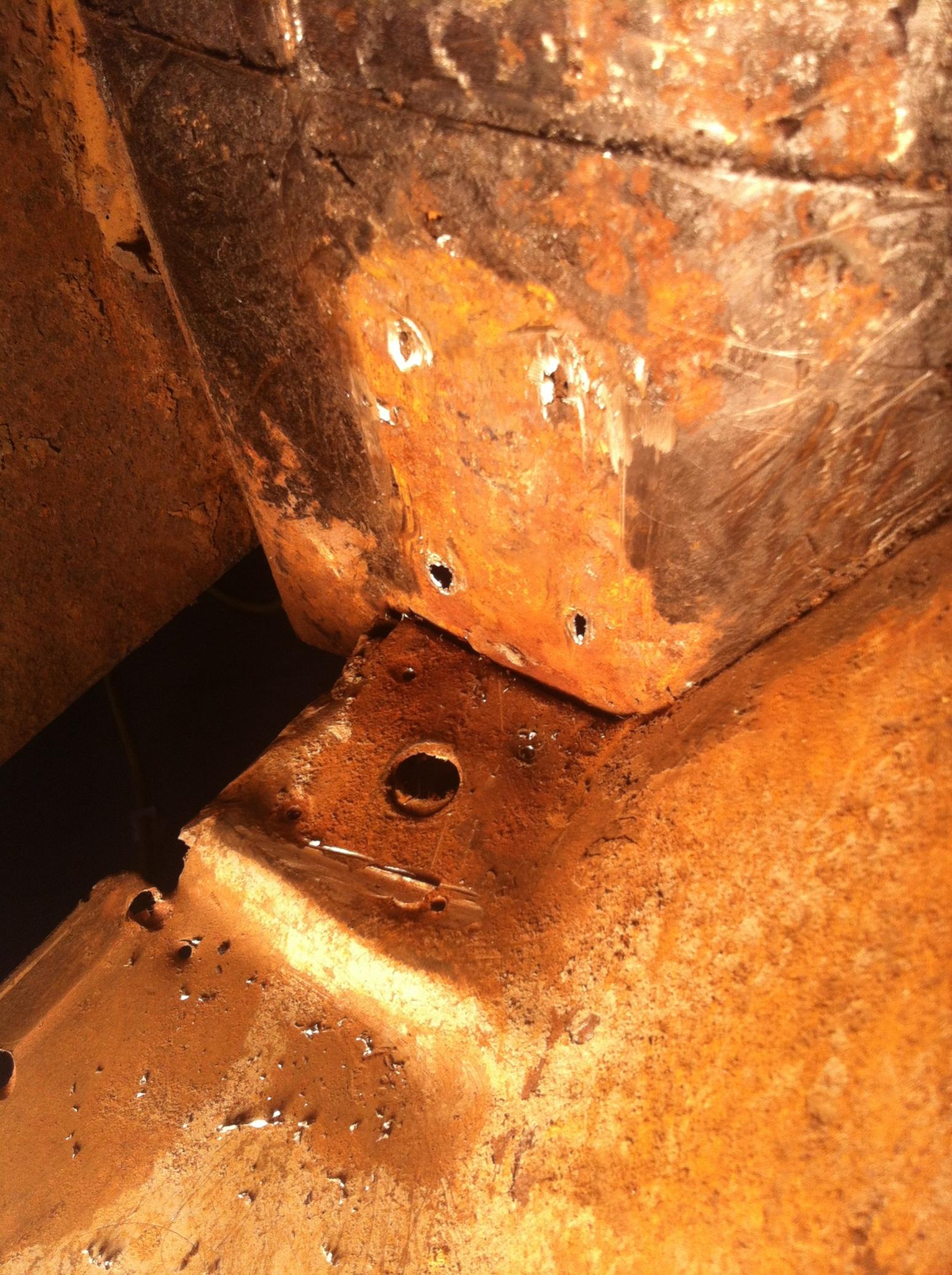

    A few more pics. Havnt had a great deal of time but getting back into it. Still sorting out the structural rust. Here in NZ we need to get a repairs certified so all rust must be removed.

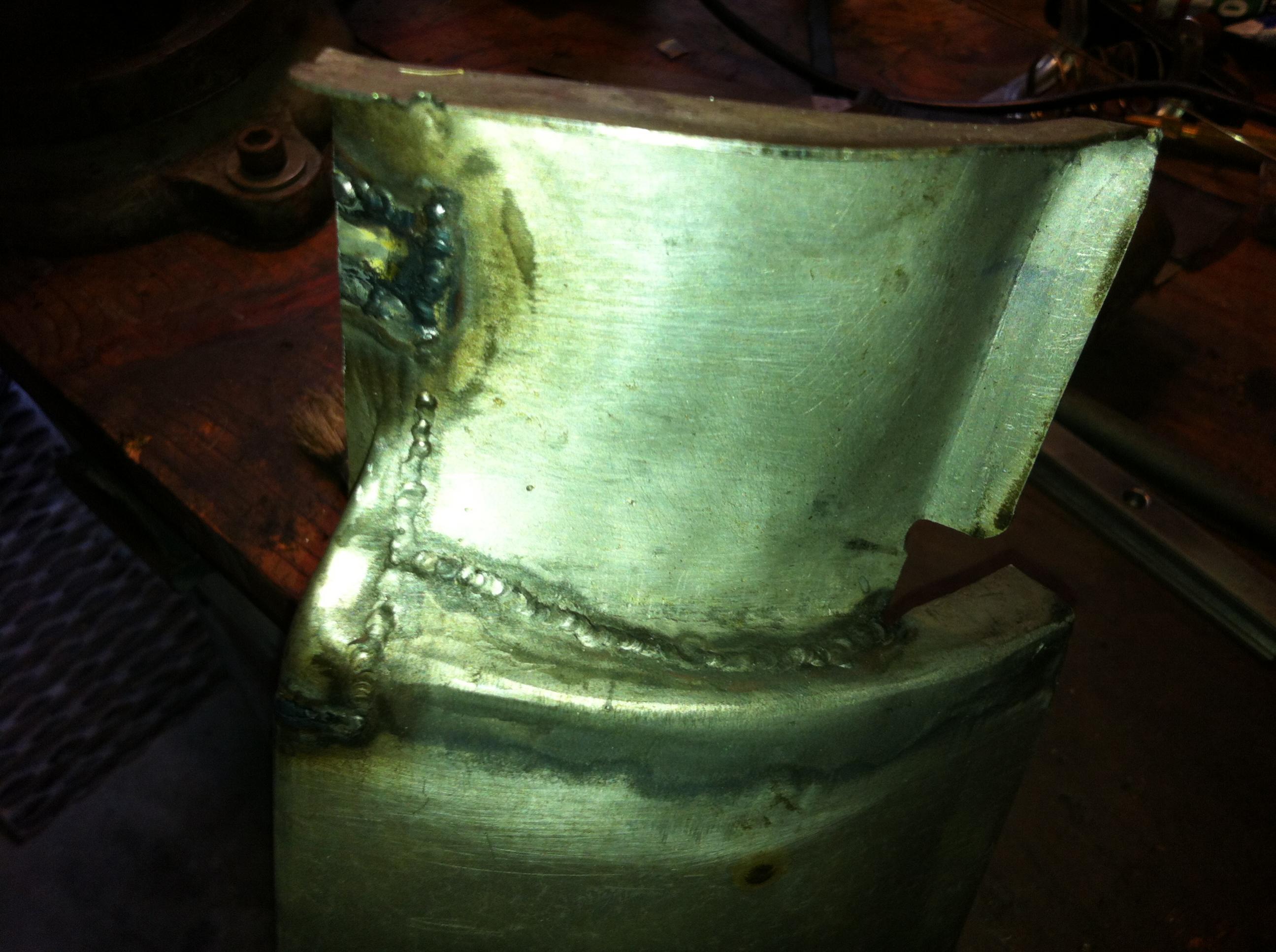

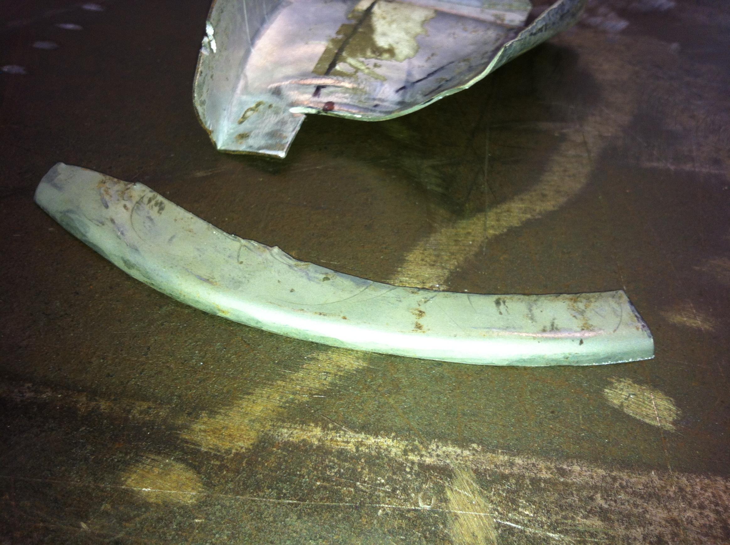

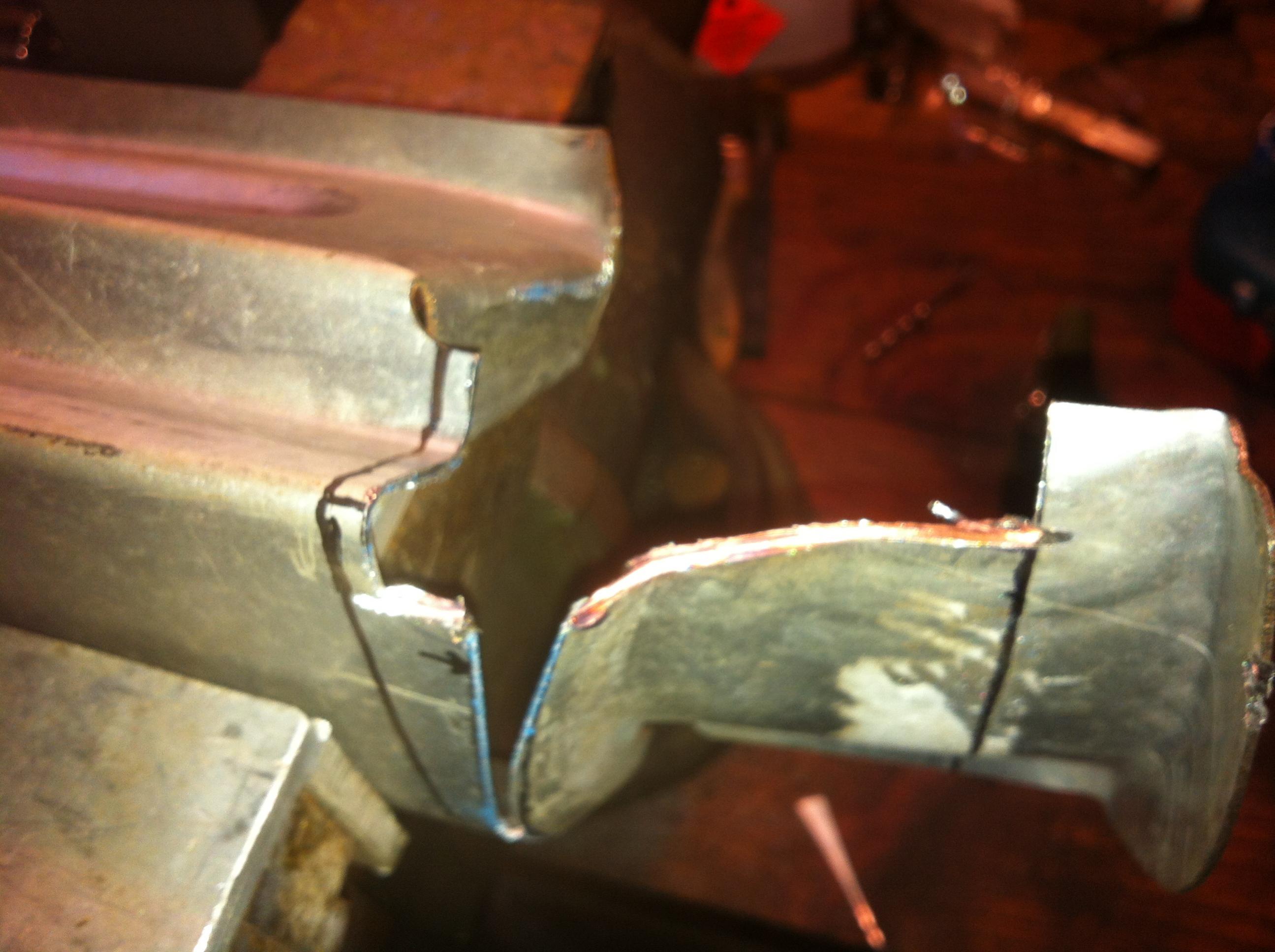

    Ive also shortened up the EMS outer rocker to the same length (the overall length is good but the area beneath the door is 1/8 inch to long) and also changed the angle where it meets the front fender to suit the original part. I choose to open up the three slots in the top of the rocker as it makes them easier to install and I will fill with fishlene or cavity wax after painting.

    Here are a couple of other minor bits and a pic of the rocker slots. The floor braces are from EMS.
